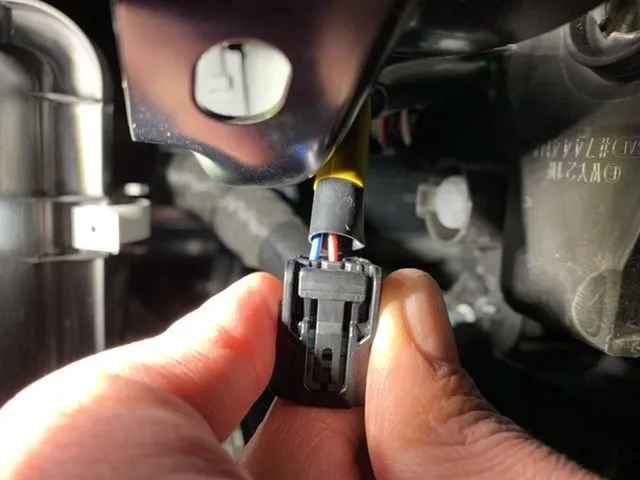

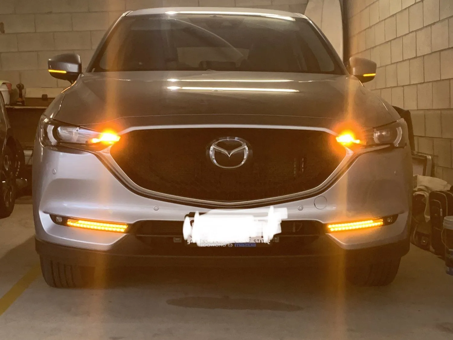

I got the instructions below to add some DRL’s and turn signals. Can someone show me where to tap into the turn signal? Wire color and location.
Solution
Found it! Now which wire should I tap into...red or blue?
Got my multimeter back. Looks like red is where I’ll be tapping into tomorrow.

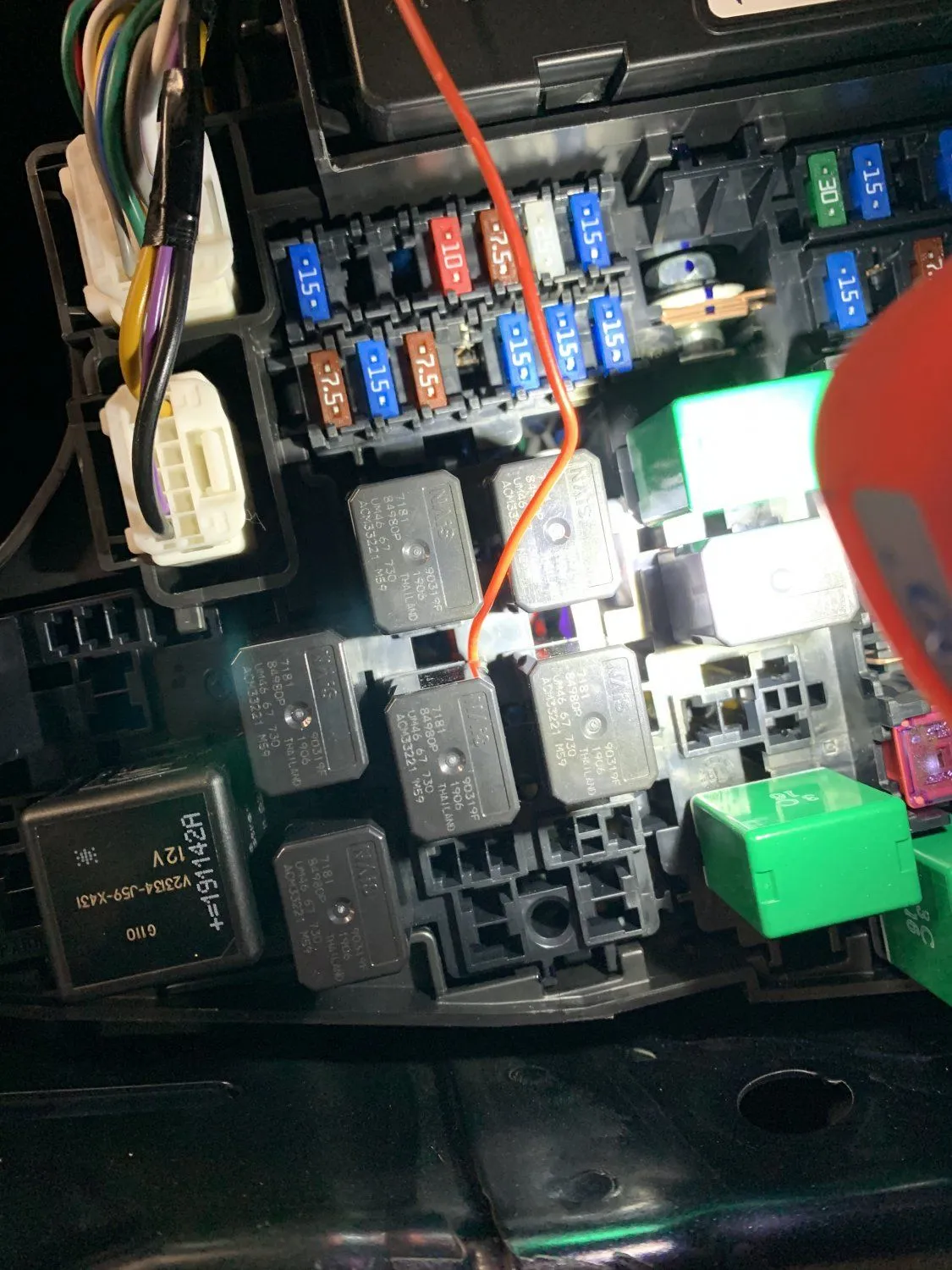

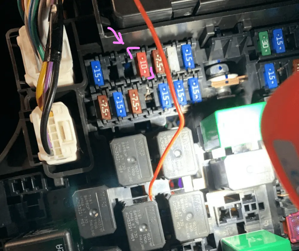

Can I ask where did you tap the ACC to? I’m having trouble finding a positive that's only on when the engine is on. TIA
Upvote 0
I can’t remember what fuse and what prong it was exactly in the engine bay, but here are my photos.
Upvote 0

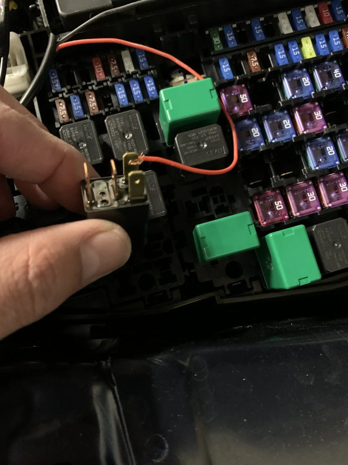

Thanks for the information, it let me finish mine today including a relay to turn off DRL when lights on.
Thanks again.
Upvote 0

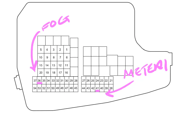

I used Tap-a-Fuse on this Meter1 fuse #41 to act as ignition ON DRL.
For the Tap-a-Fuse, I used 10A to simulate the fuse and 7.5A for the LED connection.
I'm recycling Rutedown's photo for Fuse #41 (Thanks, Rutedown).
You can also use Fuse #36 (15A) FOG if you want it to act like fog lamps.
Upvote 0

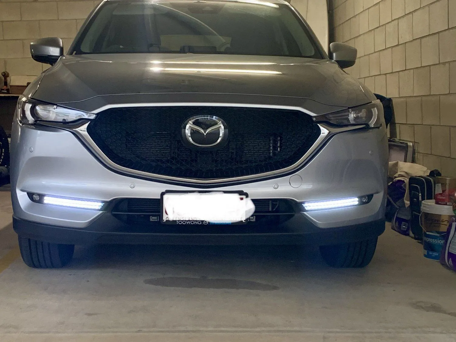

Thanks again.
I still need to tap into passenger side turn signal.
How were you able to get past all the monster harnesses in the way? I can't get an angle. Did you remove the washer funnel bracket?
Upvote 0
