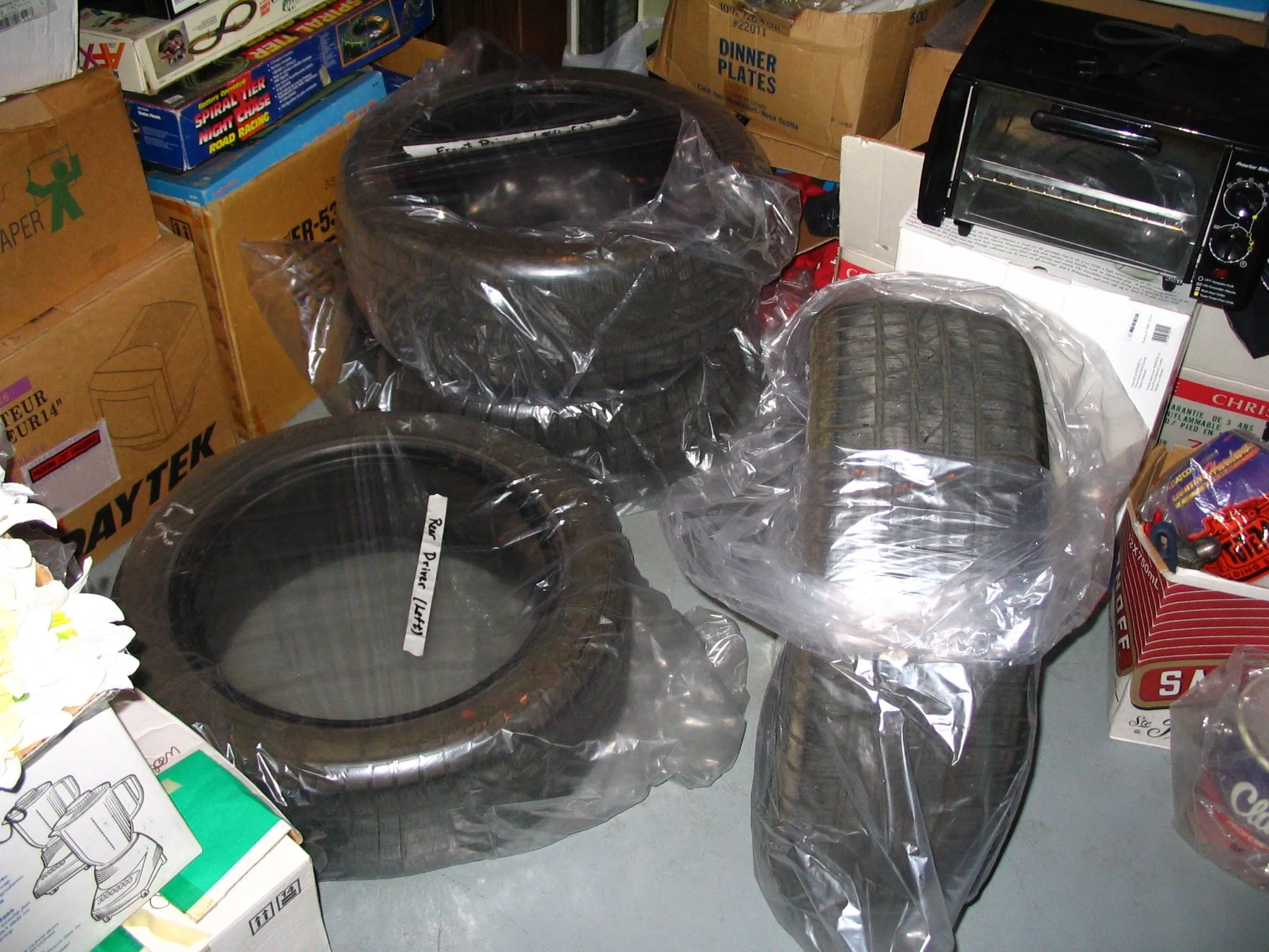

First pic is all my tires sitting in the basement. =)

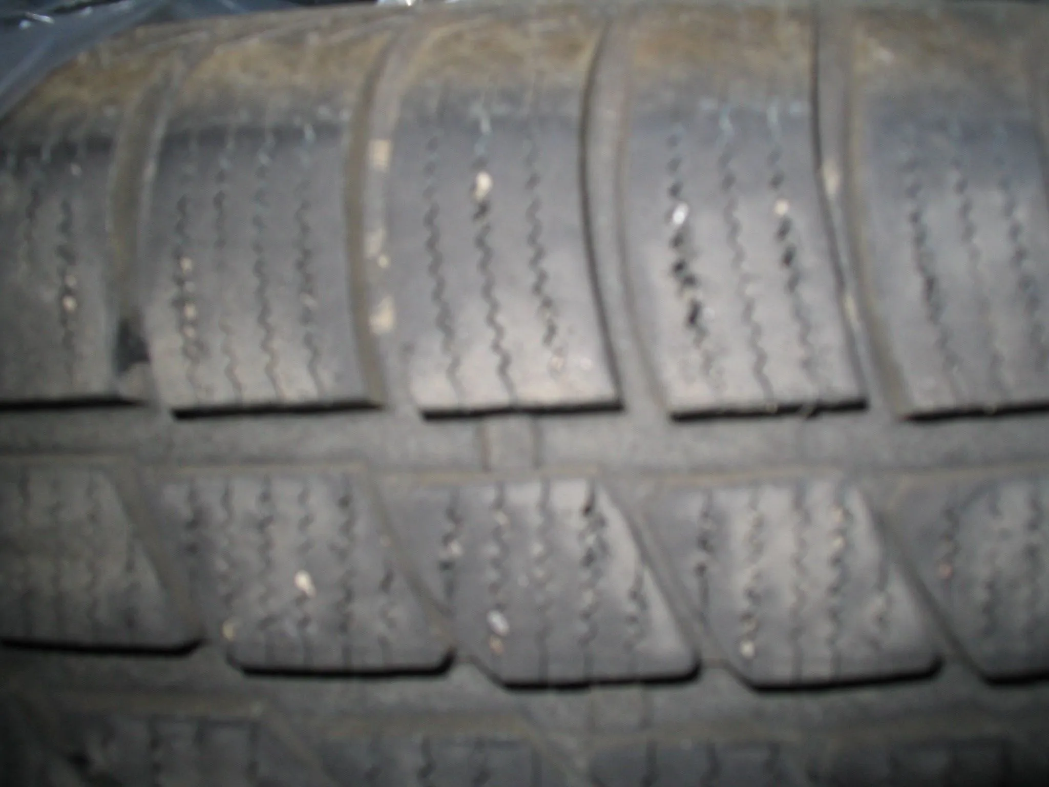

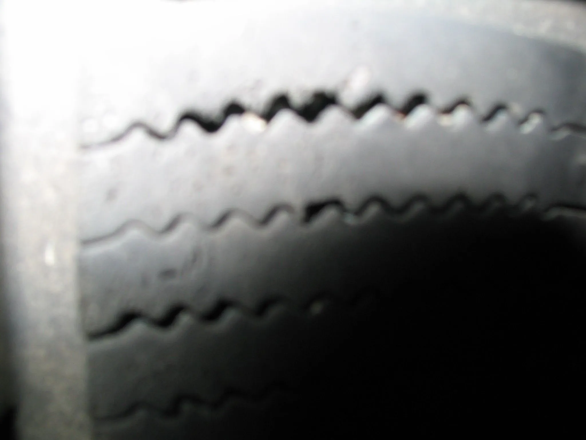

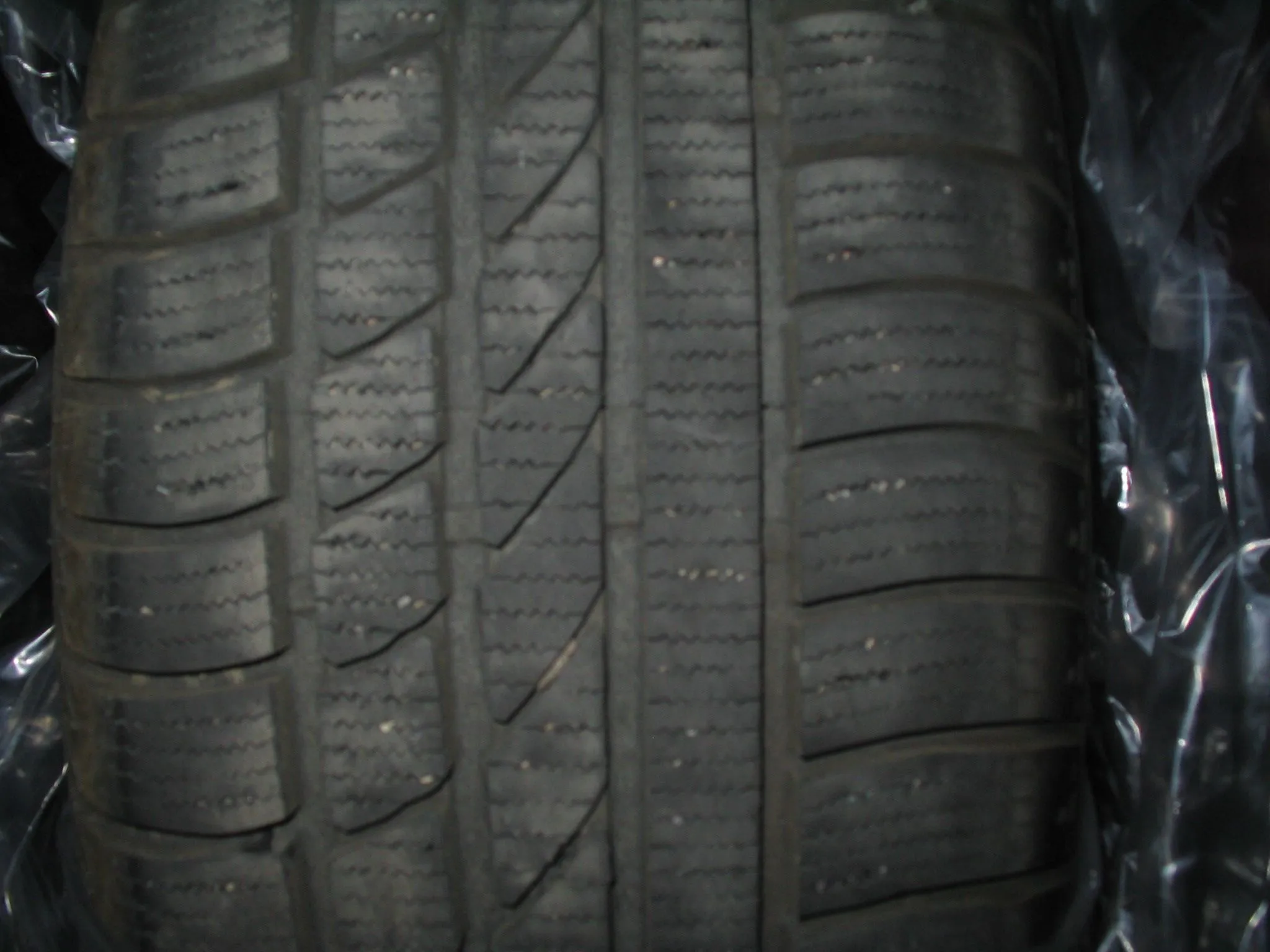

These are pics of my two rear tires. See there are still tons of tiny pebbles in the treads. There used to be much bigger rocks, I picked all the big ones out. The 3rd and 4th pic show the inner tread. You can see that some of the tiny grooves are wider. This is where rocks got stuck and stretched the groove apart. I hope it didn't wreck the tires too badly. =(

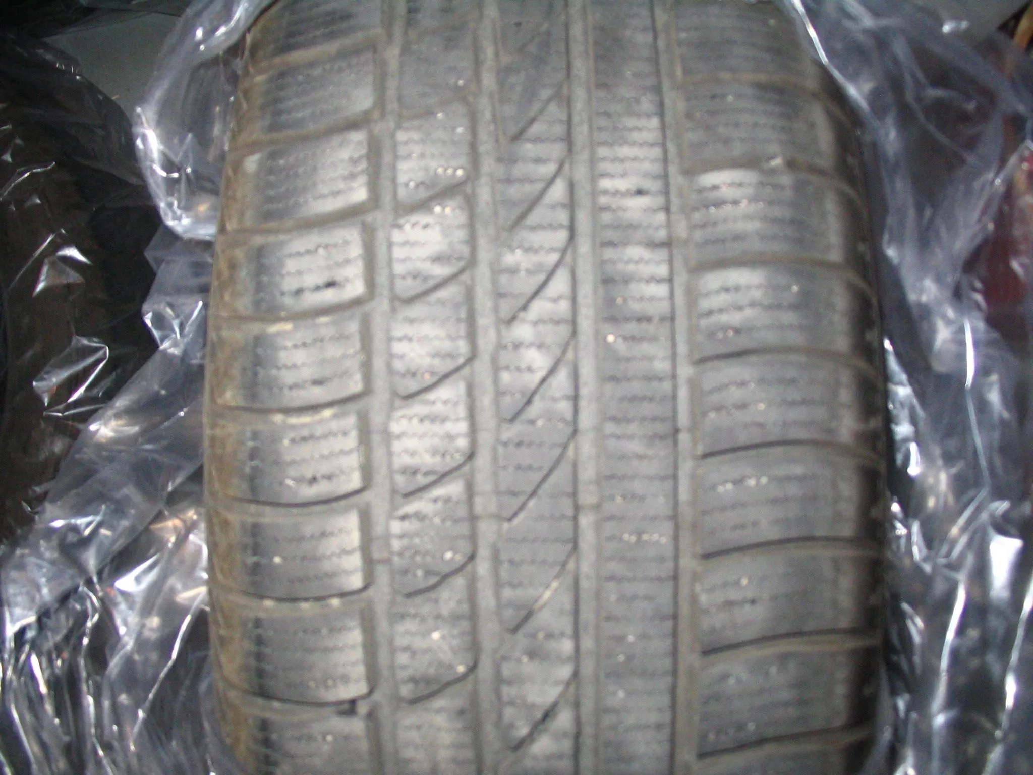

In the first pic, this is a close up of the inner tread of one of the rear tires. You can see that it has little cracks in the tread near the bottom left of the picture, close to the wide lateral groove. This consistent throughout the whole inner tread. Not good compared to the rest of the tire.

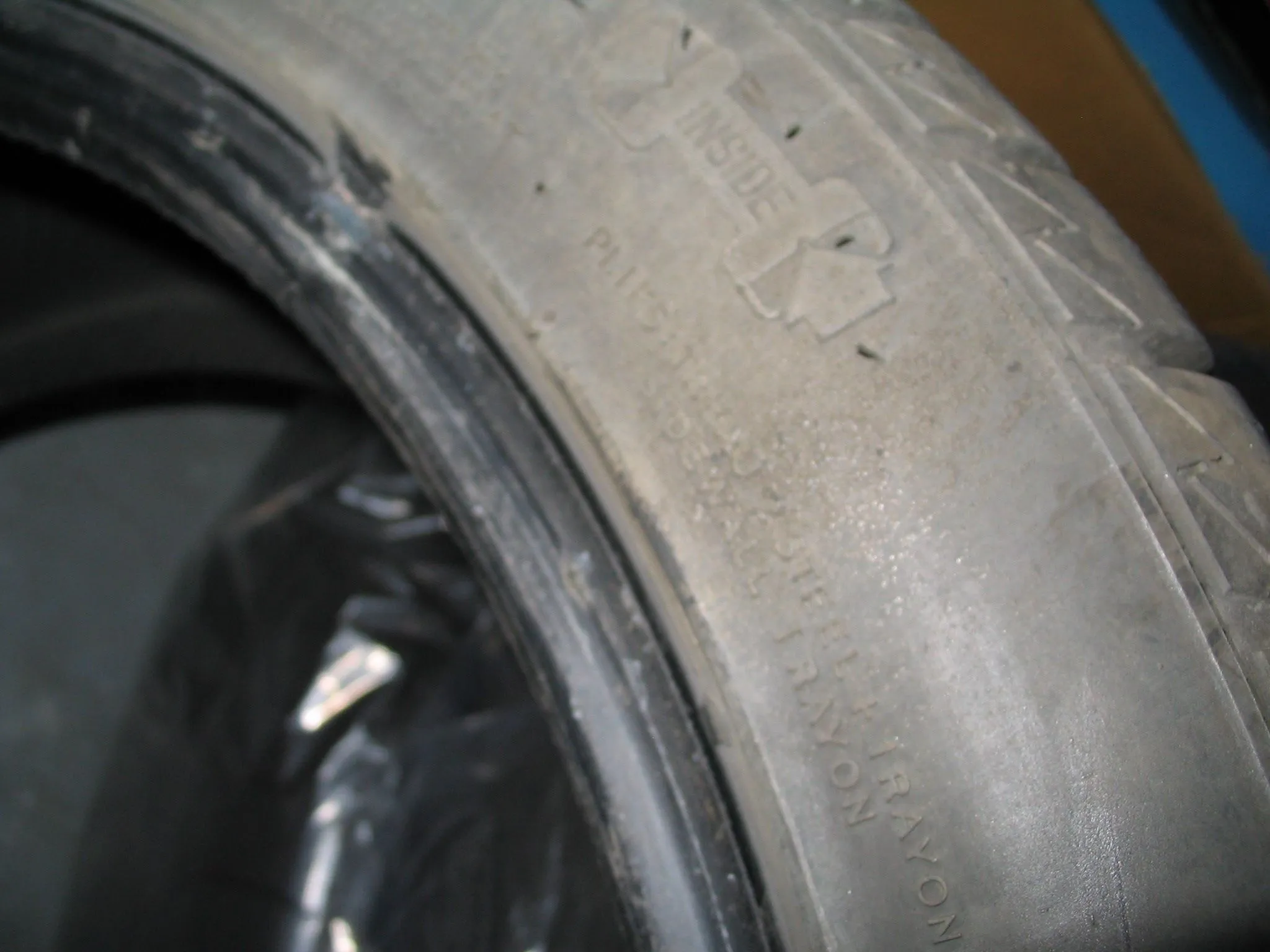

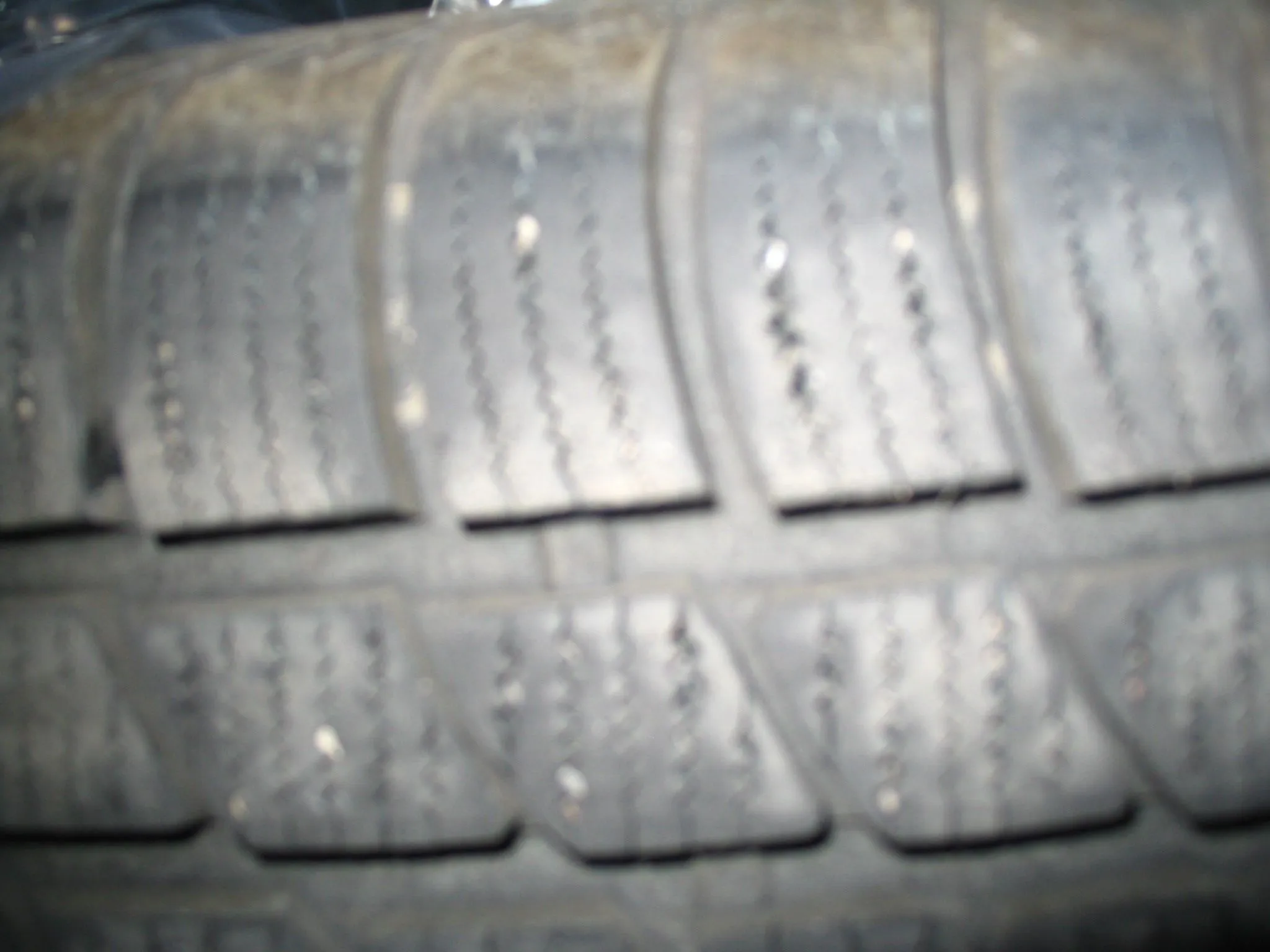

Second pic - you can see the caked on dirt patch. Looks like little bubbles. Tried scraping them but it's as if I'm scraping rubber. Maybe the rubber bubbled and it's not dirt?? That would be bad news too. =(

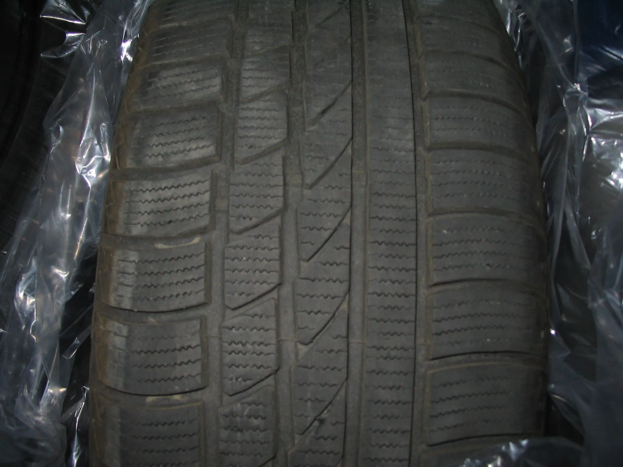

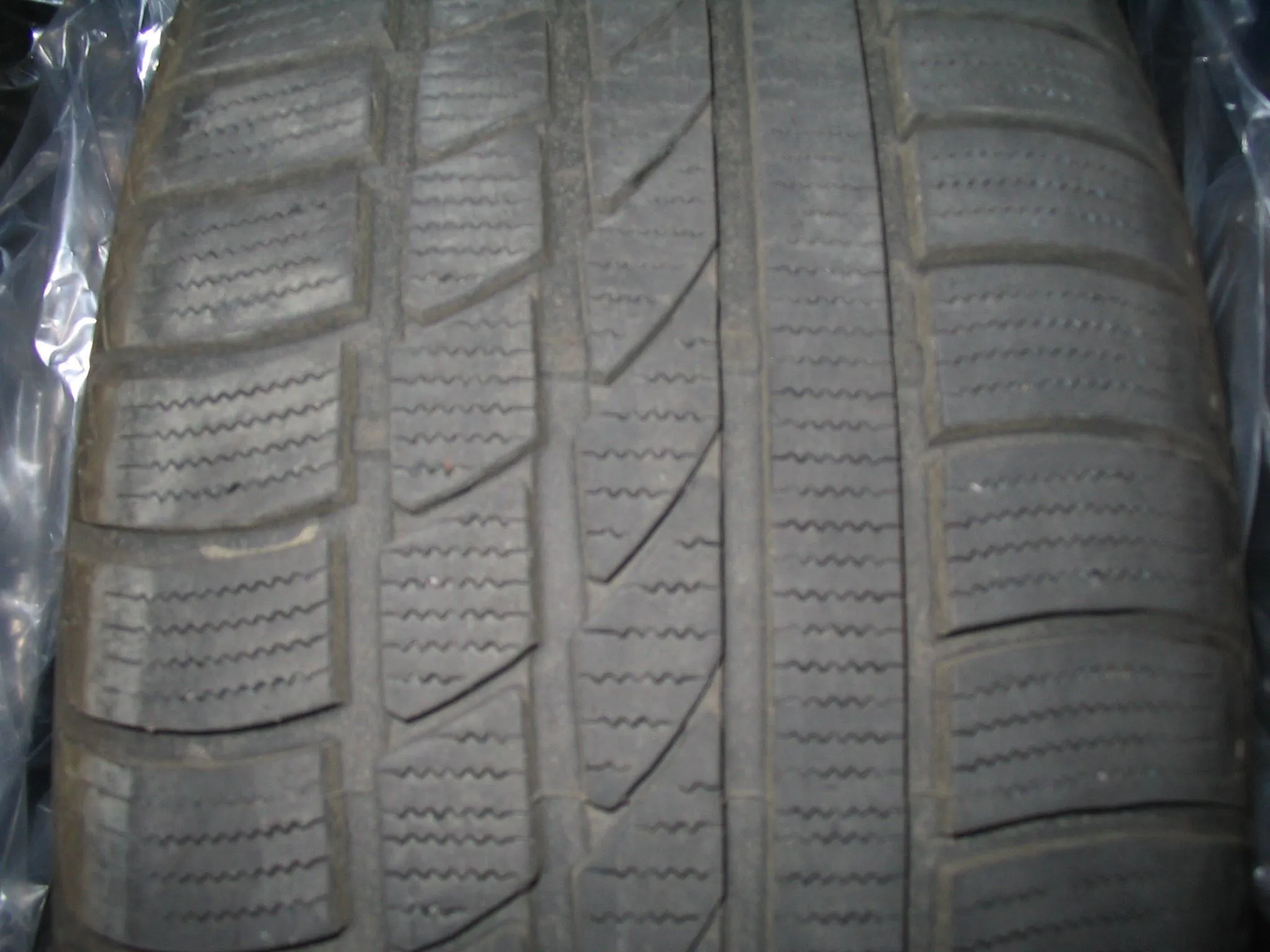

The last two pics are of my drivers side front tire. I didn't bother with the passenger front, it looks the same. It seems in really good shape.
Forgot to mention. These are Hankook W300 Ice Bears in 205-50-R17. They handled excellent in the winter. Gave me tons of confidence on ice, light snow, slush, wet. Only times I was a little worried was on sheet ice (no tire can take this I don't think) and thick, deep snow where my rear would drift back and forth. I think this is more because the tire is wide slash car is not that heavy. I did blow up my passenger front tire on a pot hole and had to get it warrantied. So that one is around 6000kms newer.
The other tires are almost exactly 10500kms old.

That's toally normal for snow tires. The compund is very soft and the sipes/blocks spread apart easily. Nothing to worry about. It's how they get good grip in the winter.
Only problem I had is that my fronts were worn down a good 1/4" more than the rears after one season. But, I got bad tires and beat the piss out of them.
Don't worry a bit about those. As dcomiskey said, snow tires have a very soft compound. I've seen the same exact thing in the past on all my snow tires. They will be fine. The tread needs to be that soft, so that when you're in the snow, they can spread apart and grab the snow.
