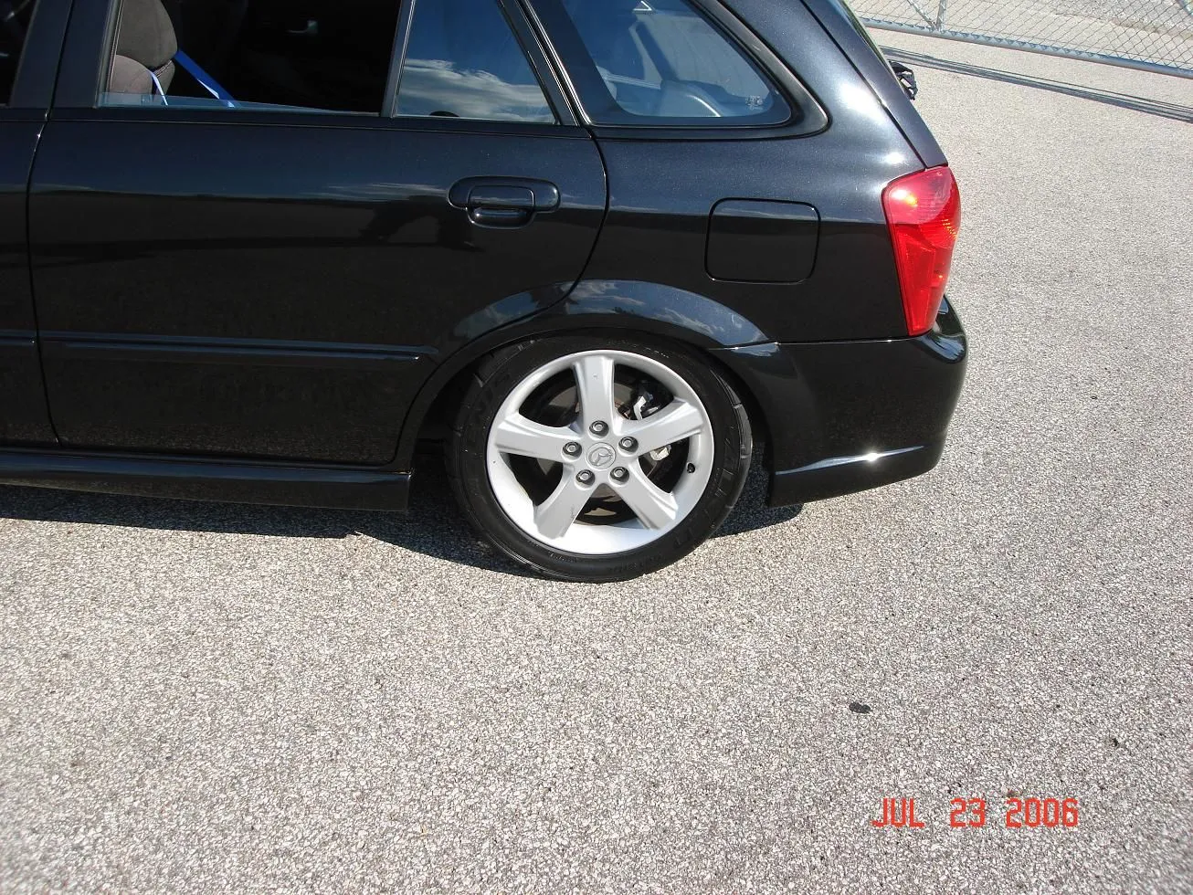

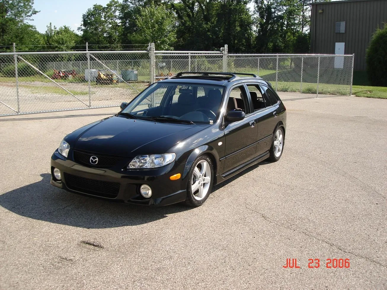

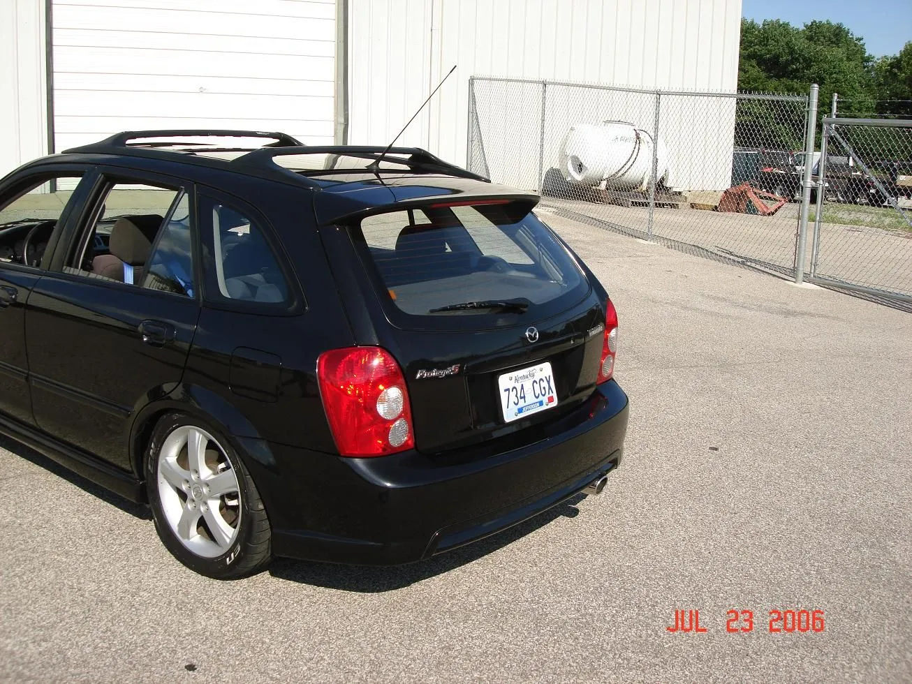

215-45-16 azenis.. they fit, they work, hella grip.. thats all thats been on her.. oh and the car is low.. heres a pic form last year before a deals gap trip.. NO rubbing at all, though i did roll the fenders in the rear to be safe.

WRCprotege,
What rims are thoughs? I thought tires that wide would not work on stock 16" rims? Also what springs do you have on your car?
Magus
stock 03 wheels, they fit, hard to get on but they fit..and Skunk2 coilovers, the rear is 3-1/5 4 inches lower and the front 2 1/5 or so..and the tires work fine, the edges are a little rounded but thers massive grip and a smooth breakway when they let go.. i like my clean ,stock look, and the factorys wheels look good and arent that heavy at 17lbs, so i fit all the rubber i can on it and go drivin!!
