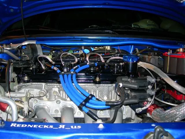

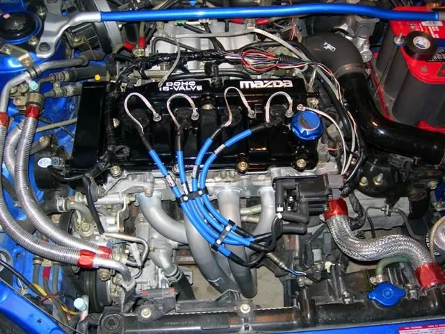

I've got a Ractive and my only fitment issue is its really close to the oil pan.

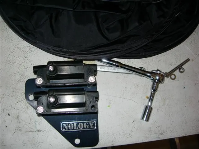

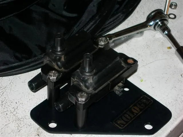

Warning: threadjack in 3....2....1.....What coilpack is that you got there?
those are stock coil packs, with the Nology set-up.
Thanks, your engine is my new wallpaper.
Thats not even a good picture. I have better pictures
I recognize the wires but I just bought "stock" coilpack to mount in that position but all 4 holes for the plug wires face up in a row, they don't face 2 different directions like in the pic above & the bracket looks different, hence the question. Here's what my "stock" ones look like..........http://www.msprotege.com/members/i12drivemyMP5/coils_2.jpg

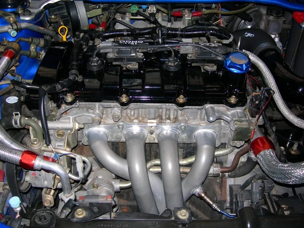

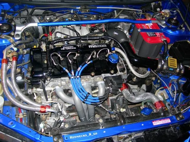

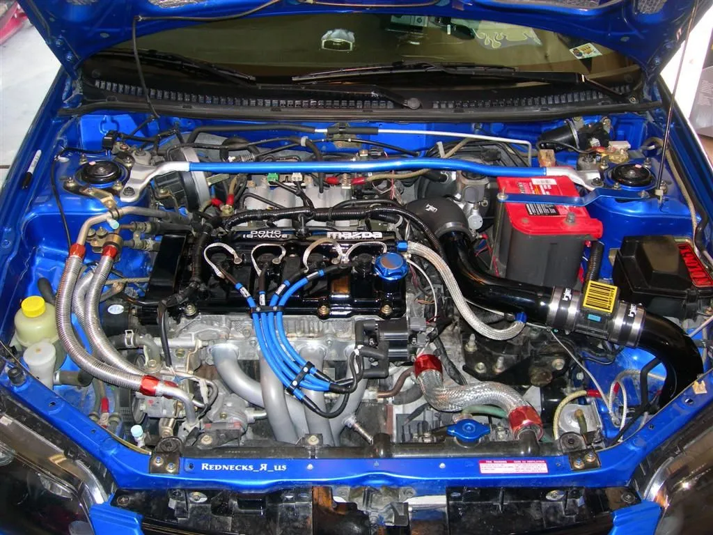

Its my stock coils with the nology bracket. I also included another pic showing my header just to keep this kind of on topic ;)
