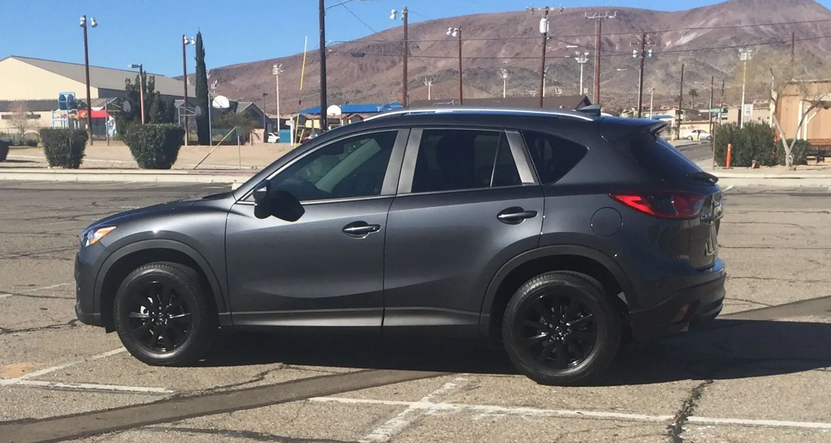

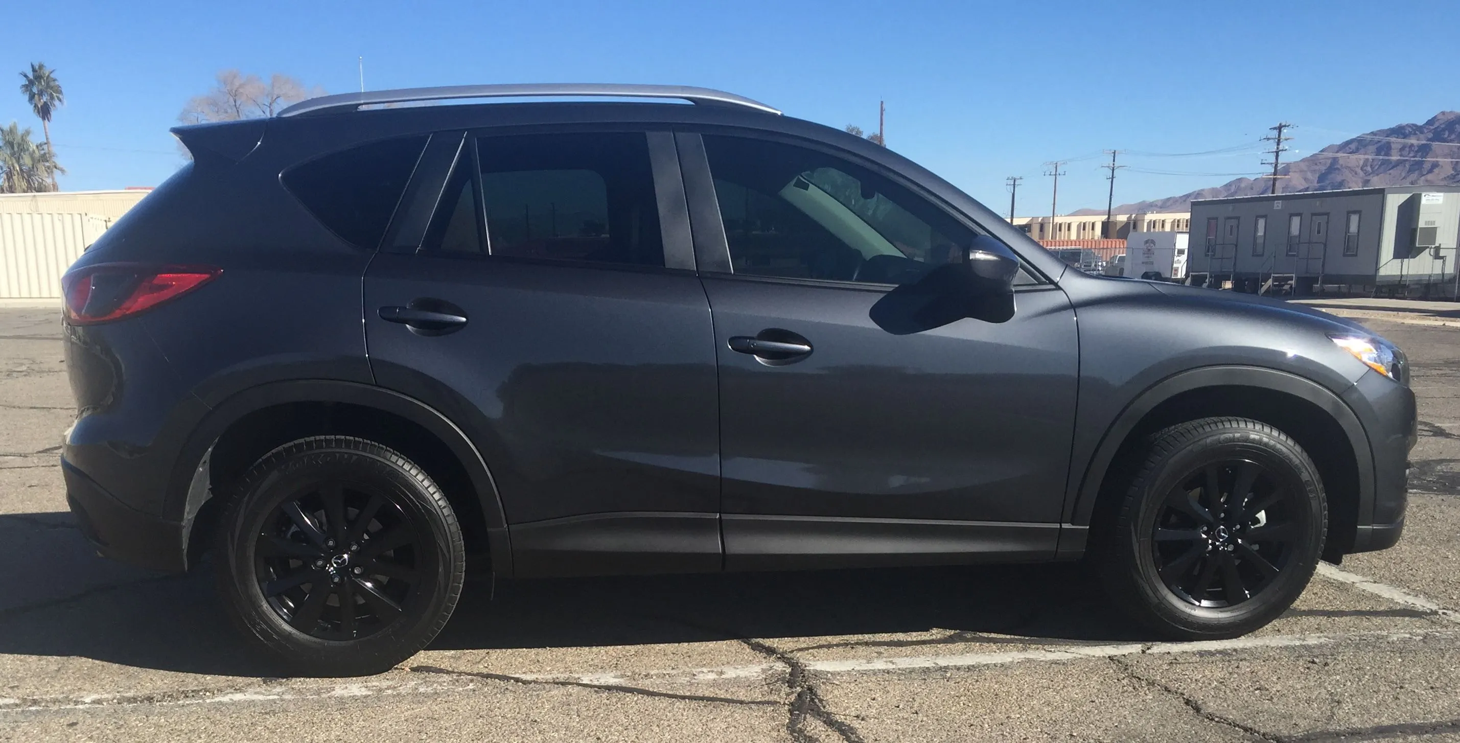

Put a ziplock bag on your hand and run it across the paint. You'll be able to feel the contamination.
Within a couple of weeks of purchase of our 2016 CX I washed, used a clay bar, and used a DA polisher with pinnacle 360 all in one cleaner. Results are great six months late. I'm planning to clsy bar and just add a paint sealant in the next couple of weeks.
In short no issues with waxing. Recommend you clay bar the paint first.
