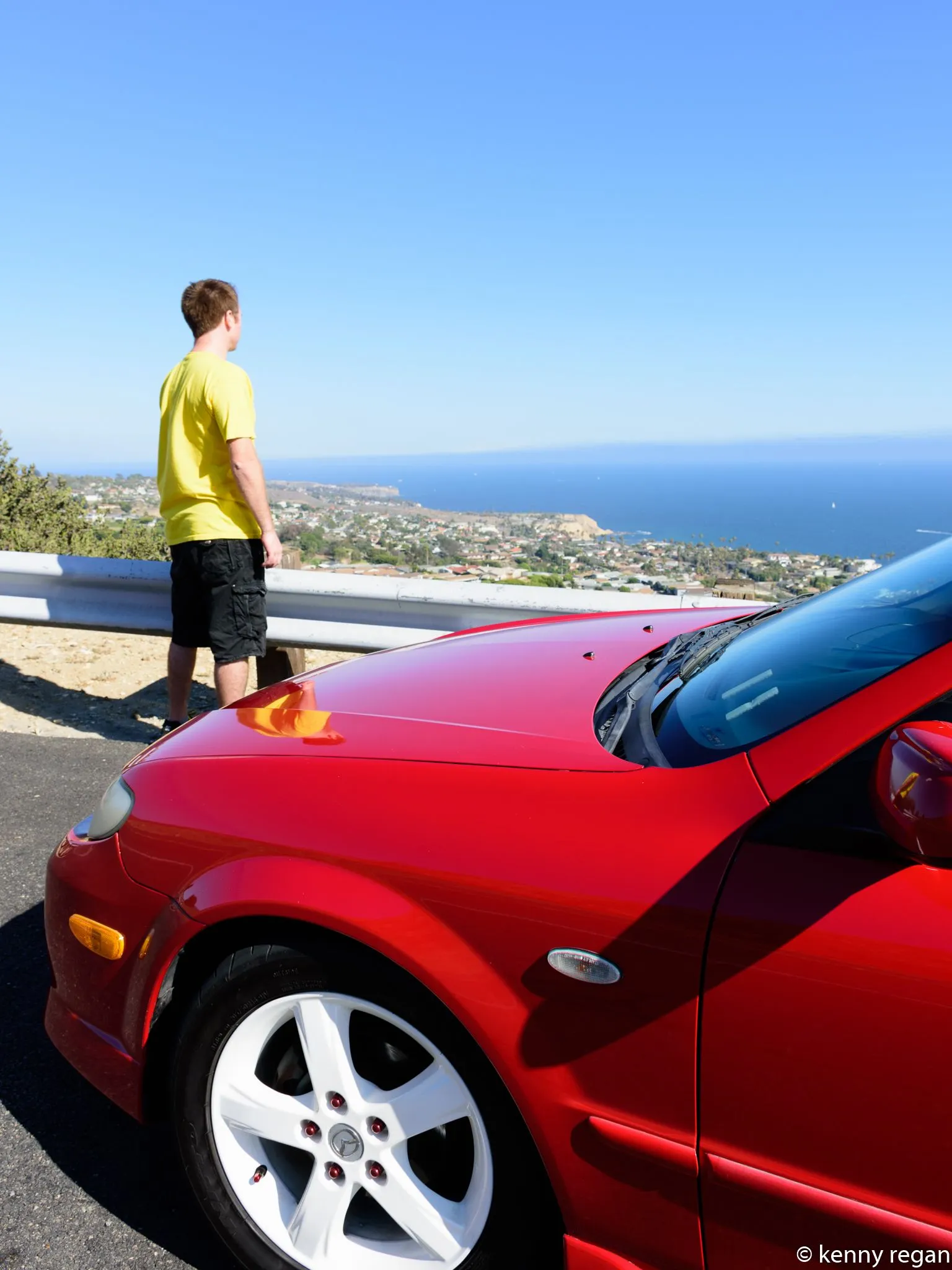

With all honesty our cars are not fast by any means and with that said the price to hp/tq gain is small for aftermarket parts. My advice would be to just do aesthetics and handling. Replace any worn/ripped bushings and motor mounts, get some coilovers and have a shop install them with a wheel alignment. Some good tires with stock or aftermarket rims. I would then do a HID retrofit to get your headlights looking sharp at night and better road visibility.
You would be surprised at how good the stock rims can look if you properly paint them.
attachment.php
