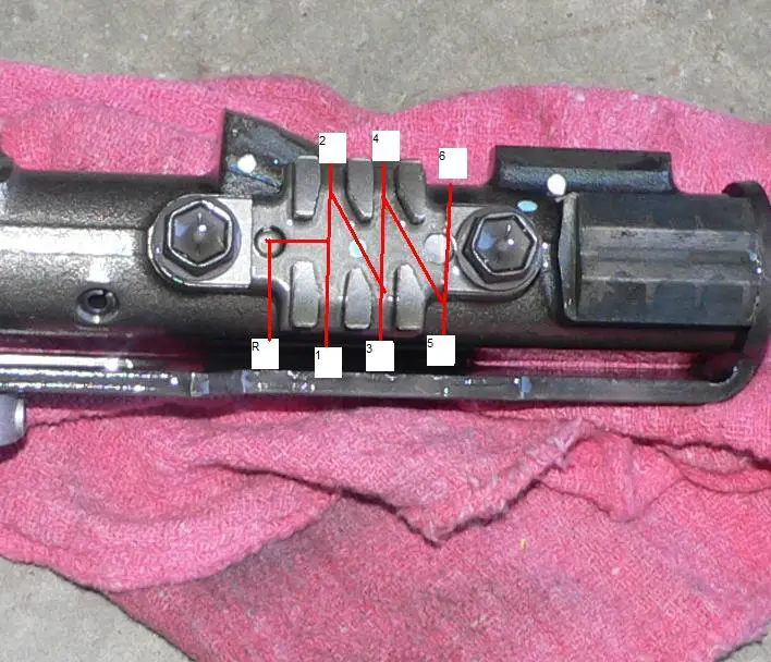

B builthatch Member Apr 28, 2008 #1 pictured here, stolen from the tranny oil change how-to: what is the bolt that says "do not touch"?

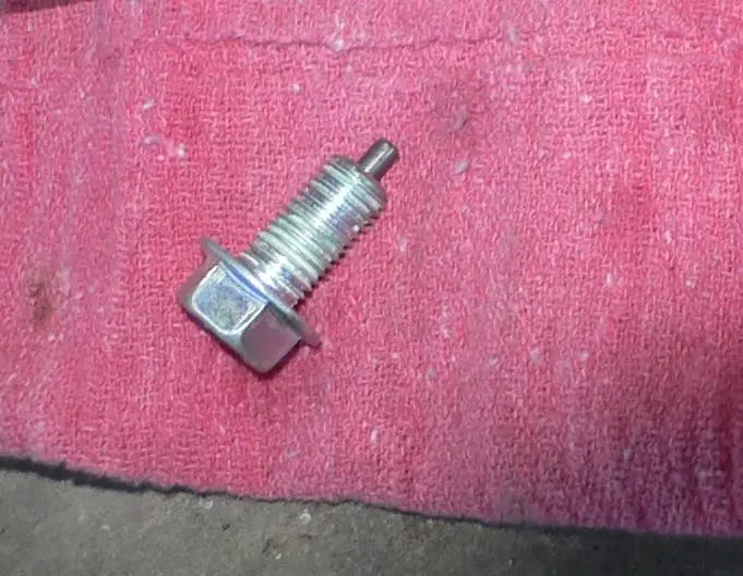

R Rotus8 Member : 07 MS3 Apr 29, 2008 #3 Transmission gate guide pin. Attachments ShifterPin.webp 47.2 KB · Views: 230 ShifterGate1.webp 57.6 KB · Views: 230
A AutoXRacer Member Apr 29, 2008 #4 Rotus8 said: Transmission gate guide pin. Click to expand... Hence, don't touch it!!!! (no) (lol2)
B bykeryder4life Member May 4, 2008 #5 if you take it out nothing will happen, just have some thread sealant handy because it threads into the oily part of the tranny. no fluid will come out from that bolt hole (at least it didnt when i did rotus' short shift mod)
