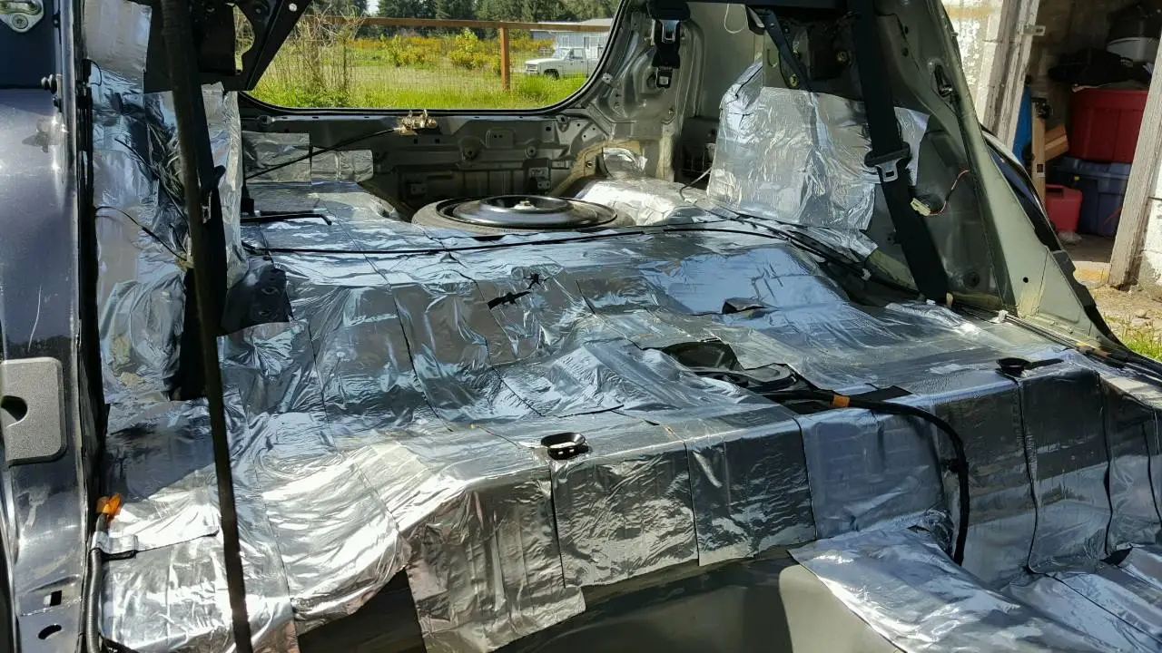

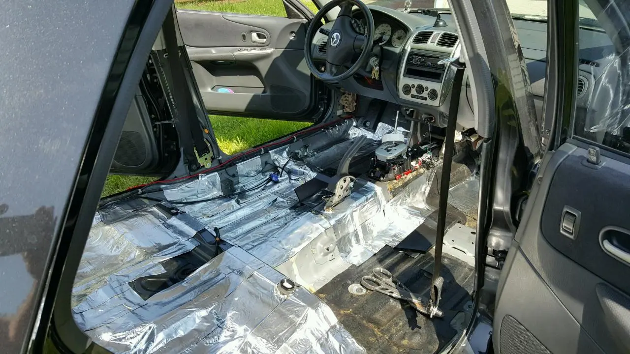

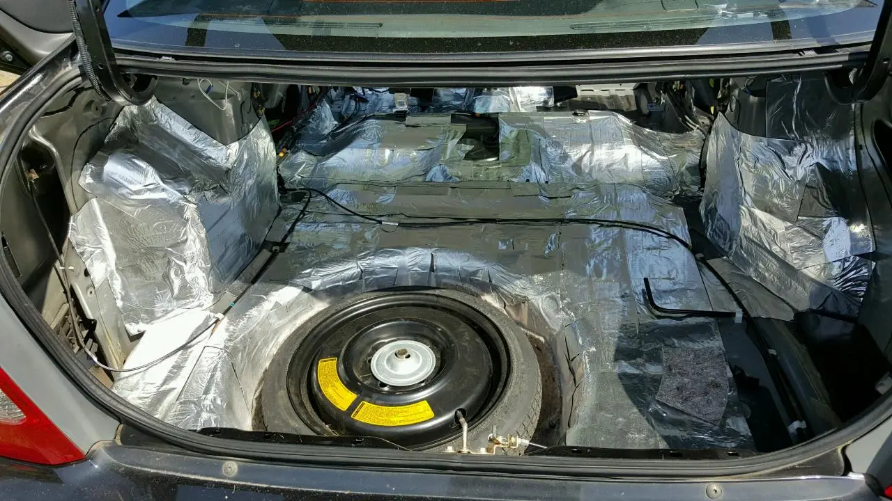

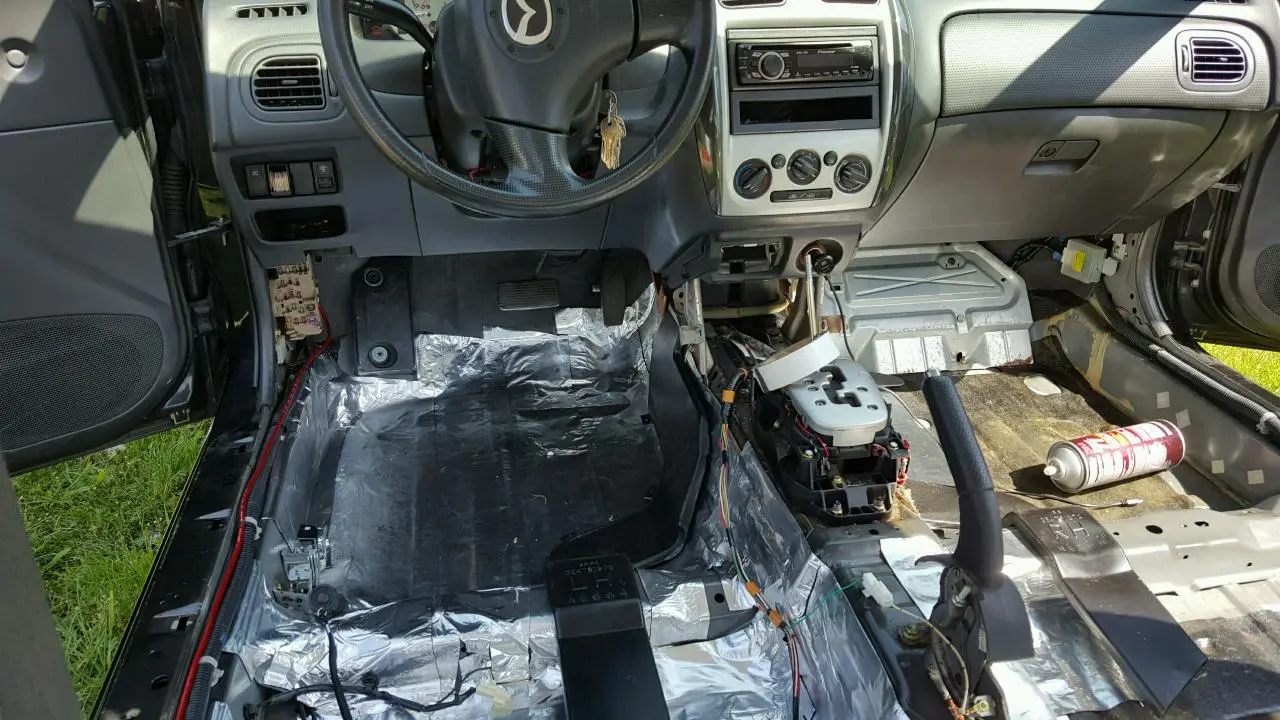

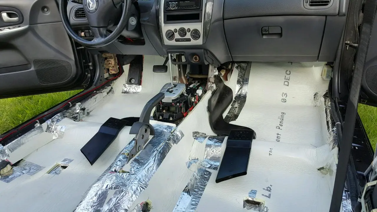

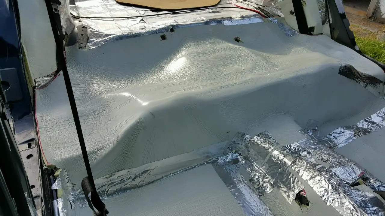

http://www.tirerack.com/tires/tires.jsp?tireMake=Hankook&tireModel=Ventus+S1+noble2 I recently purchased this MP. Had a lot of road noise, more than i expected. This weekend i'm having Hankook ventus S1 Noble2 installed. In the meantime i Removed the interior and installed sound mat and stick & peel tape. Here's some pics. I have been very impressed with this car. It is a very fun car to drive. The car handles well, shifts good, responsive with fairly decent mileage. The problems i have encountered are the transmission getting stuck between neutral and reverse. It happens 15-30% of the time. Another issue is the headlights seem to loose brightness while in low beam mode, not in high beam. I diagnosed the vehicle had a sticking caliper. I removed the caliper assy, cleaned it with brakeclean, apply anti-seize and re-install. Working fine now. I plan on removing the door panels and soundproofing them also. I stuffed pre-shaped, lightweight expanding foam pillows in the rear tire wells behind the trim. Will post pics of the car. Does anyone know if the front strut tower stabilizer bar helps much with handling? Also any modest gains in gas mileage, H.P. increase from installing a cold air intake? Long ram or short ram? I went with the Hankook because it was one of the highest rated tires and it scored well in lack of noise. My buddy is the service manage for a Ford dealer and they sell tires. $340.00, which is after the $120 in rebates if you buy four select tires through Ford. No labor charge, we're going to install them at the shop this weekend. Once the new tires are installed, i hope the cabin quiets down. Glad to be part of the club. Could someone tell me how to post pics that are not thumbnails? Thanks~~ Robzentao

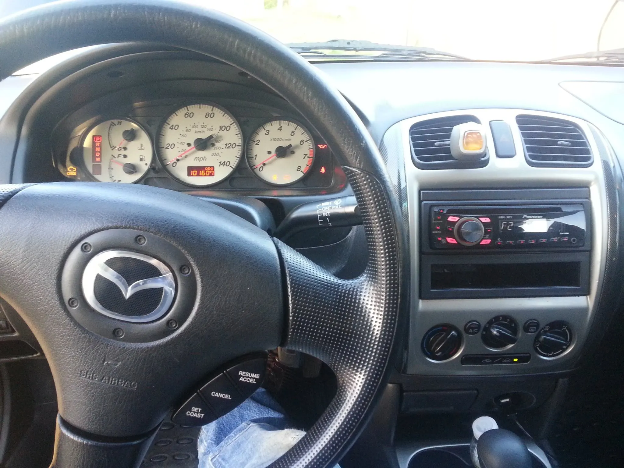

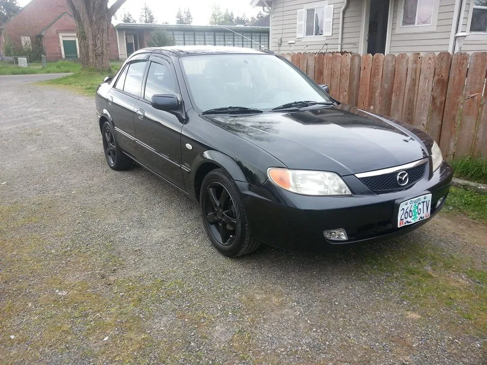

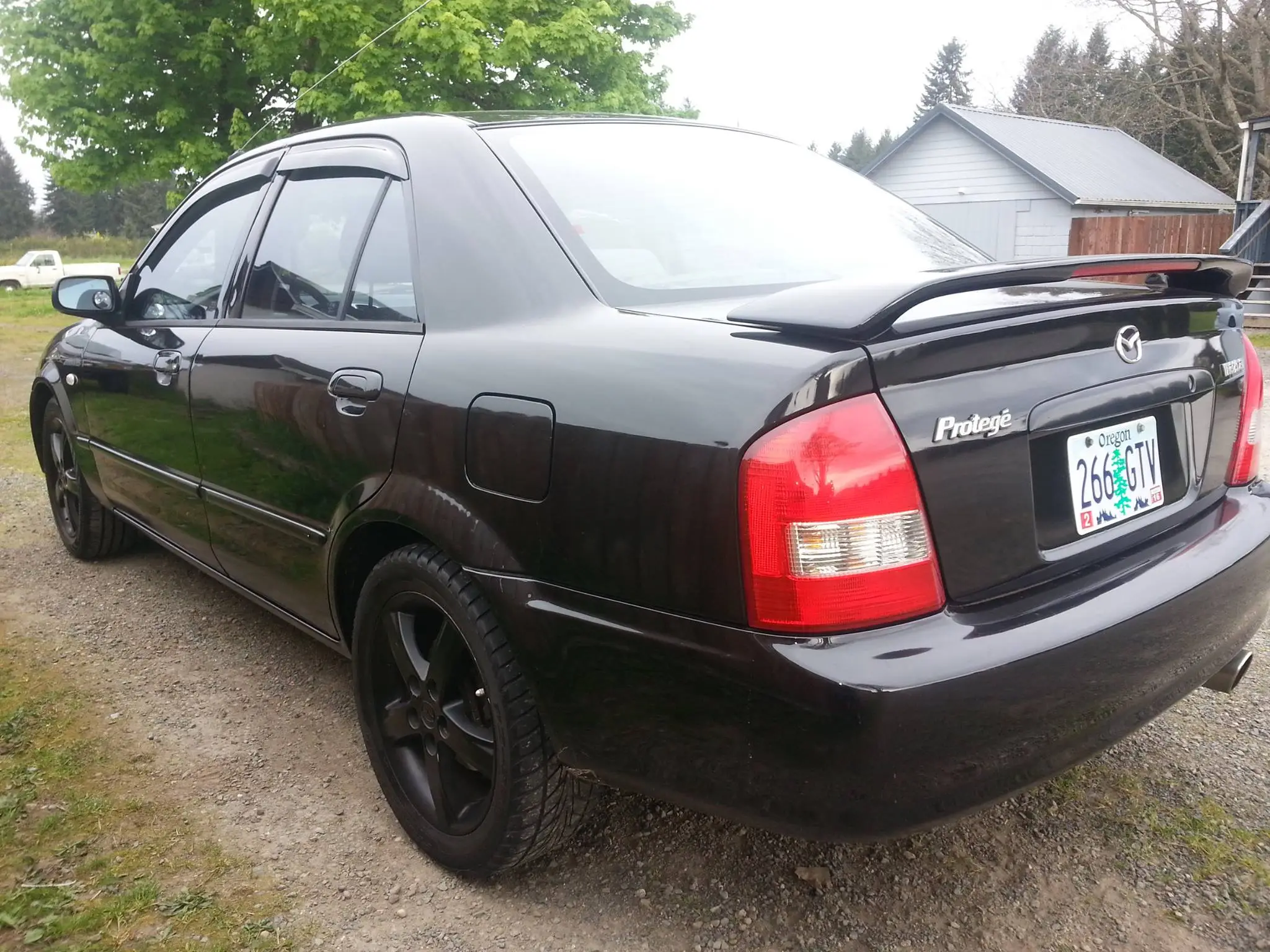

Murder Mobile pics
2003 Protege, paid $3200. The car had 101,500 mi. It needs the hood repainted, but it doesn't leak and oil at all.

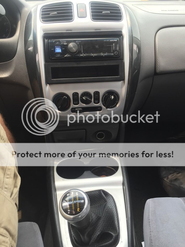

Well this is what I did today. Looks like the standard fake carbon fiber/silver dash piece and center console....but wait! Those are 99/00 HVAC controls! I didnt take any pictures while doing it, but I grafted in the 99/00 part from the center dash piece into the 01+, body filler, sanding, paint, etc.
Not everyone likes the "wanna-be" carbon fiber, but I think it looks better then the standard black one, plus the silver center matches the console now too.
Side note, the "seattle silver" paint that supposedly matches the interior silver perfectly isnt available anymore, but I had a can of VHT silver caliper paint laying around that I think matches pretty great!

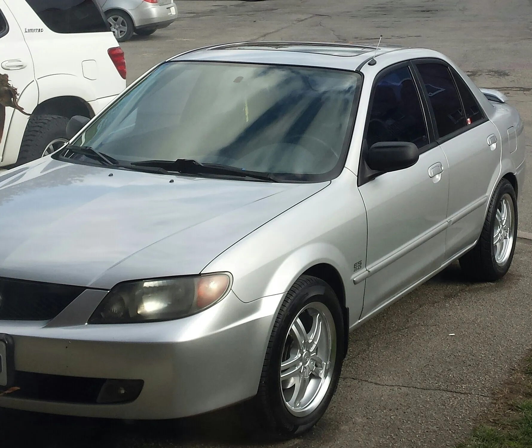

She got a trans flush and then i gave her a quick detail
