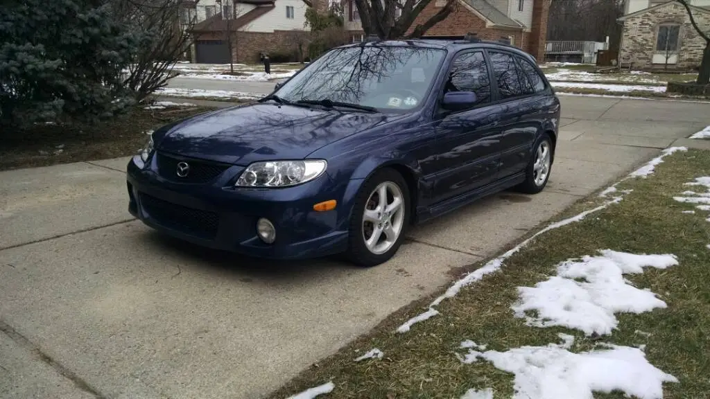

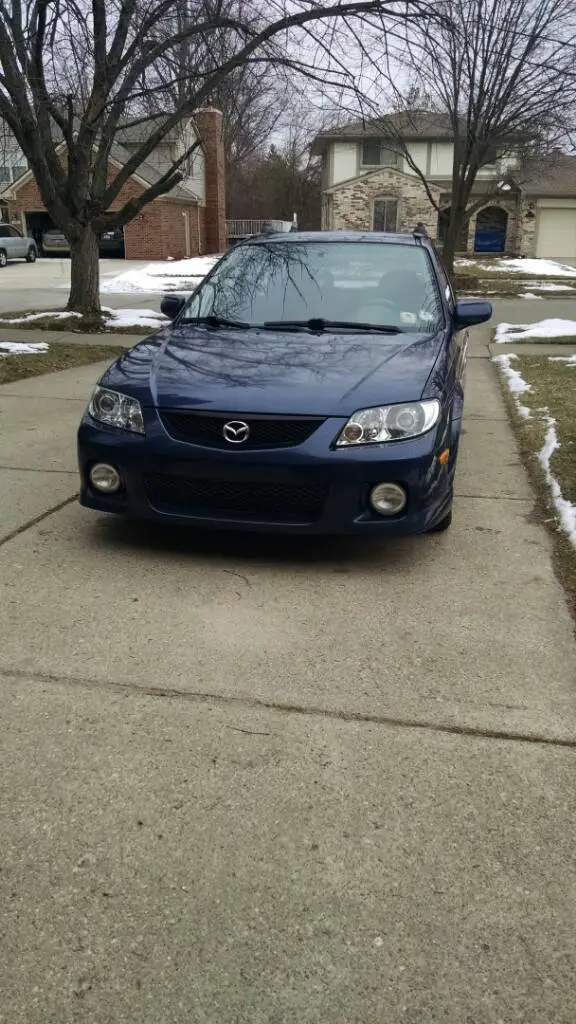

Cleaned and waxed. I'm hawking the rear arches to make sure no rust forms. Already POR15ed them. We'll see how she does.
I Used to be "meh" about this blue, but I actually really like the color. I'm coming from Sunlight Silver though, so I was used to no real change in appearance from dirty to clean.

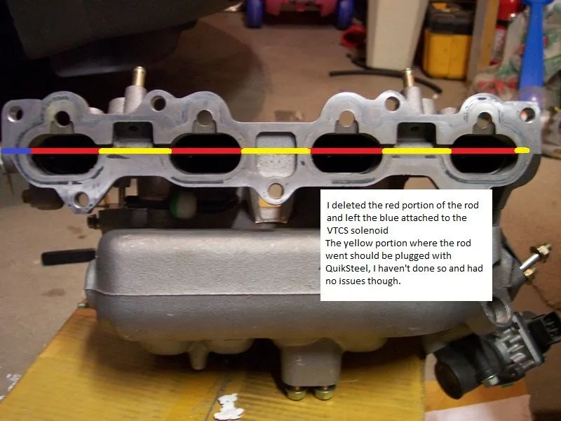

I have a predictable timable stumble when idleing at lights. After running and comingto a stop, after a predictable amount oftime itwill stumble but just once. Justtryingto figure outif it has to dowith the vtcs delete and if i should change manifolds.
Valk, check to make sure all your vac lines are plugged back in. How did you, or did you, plug the hold in the manifold where the actuator goes through? I'll throw up a paint sketch of what I did- I should do that to my new P5 as well as loctite the VICS screws...
I removed the vtcs rod and flapps and filled all the holes with high temp silicon. Removed the vac lines from the actuator sylaloid and left the electrical connected to prevent cell.
