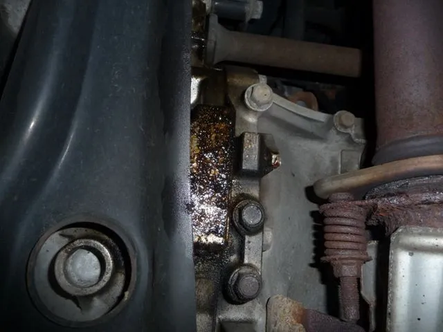

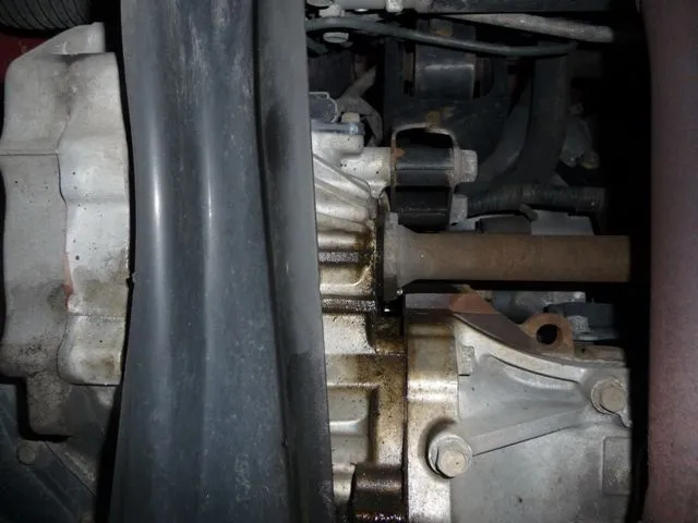

Stopped at Breidingers Speed Shop on my way home to pick up the K&N Hybrid Air Filter Cleaner. Only place in town I found that could get it...just over $10 with tax. :) After dinner, I jacked the front end up and felt around the flange of the cat/mid-pipe to check for a small leak...nothing. So I had Tam come over to rev it a few times....nothing. So I went to the rear and had her do the same. Each time the car came back to idle, a small puff of white smoke came out and there was def. a smell of fuel. Filter is getting cleaned this weekend. To re-cap:
MAF has been cleaned
New plugs and coil packs
Gumout Regane fuel system cleaner was added to the tank today when I filled up
Quick check for a small exhaust leak
Filter cleaning to come
Possibly an O2 sensor or cat? But I'm leaning away from those as I have no CEL.... On a sidenote if the mpg's don't improve over the next tank or two after the fuel system cleaner and filter cleaning I'll be contacting the mechanic to see if it could be the headgasket/cracked head. The car did overheat in 2009 but she was running fine after a new t-stat and other parts were replaced. The last oil change, the oil looked good and the coolant in my resovoir tank is nice and green?
And while I was under the car I saw this...
attachment.php
attachment.php
