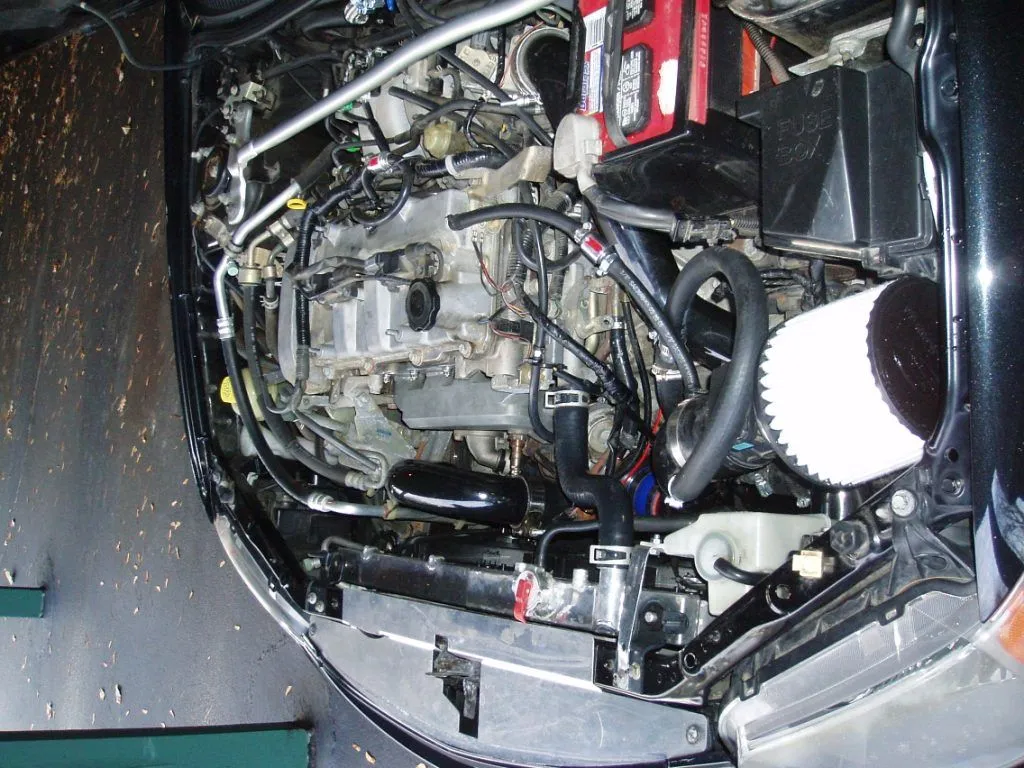

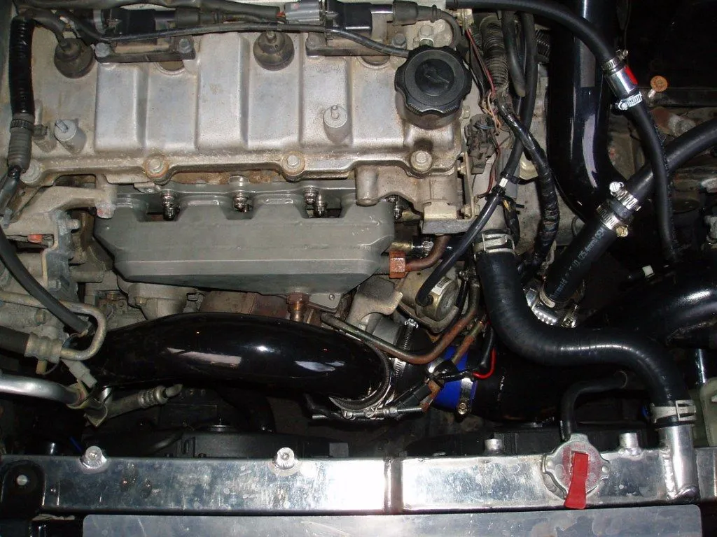

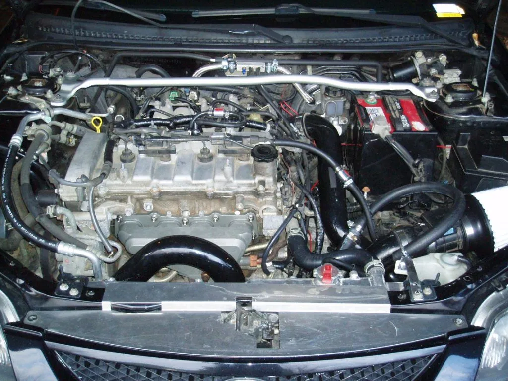

I just snapped a few shots of the engine bay. I know, it needs to be cleaned up. Yes, I washed the outside today. I will be cleaning up the engine bay in an extreme way before winter (just to get it dirty again).
well i know i havent done this yet.. but tomorrow morning i am dropping the car off to get the welded lsd and gtx gears put in.. should be back by the end of the week.. WHOO HOO.. lol.. havent driven it in almost 3 months now.. haha.. i have only driven it 500 miles in the last 16 months
VERY glad to see pictures of that all installed and up and running again bro (thumb)
