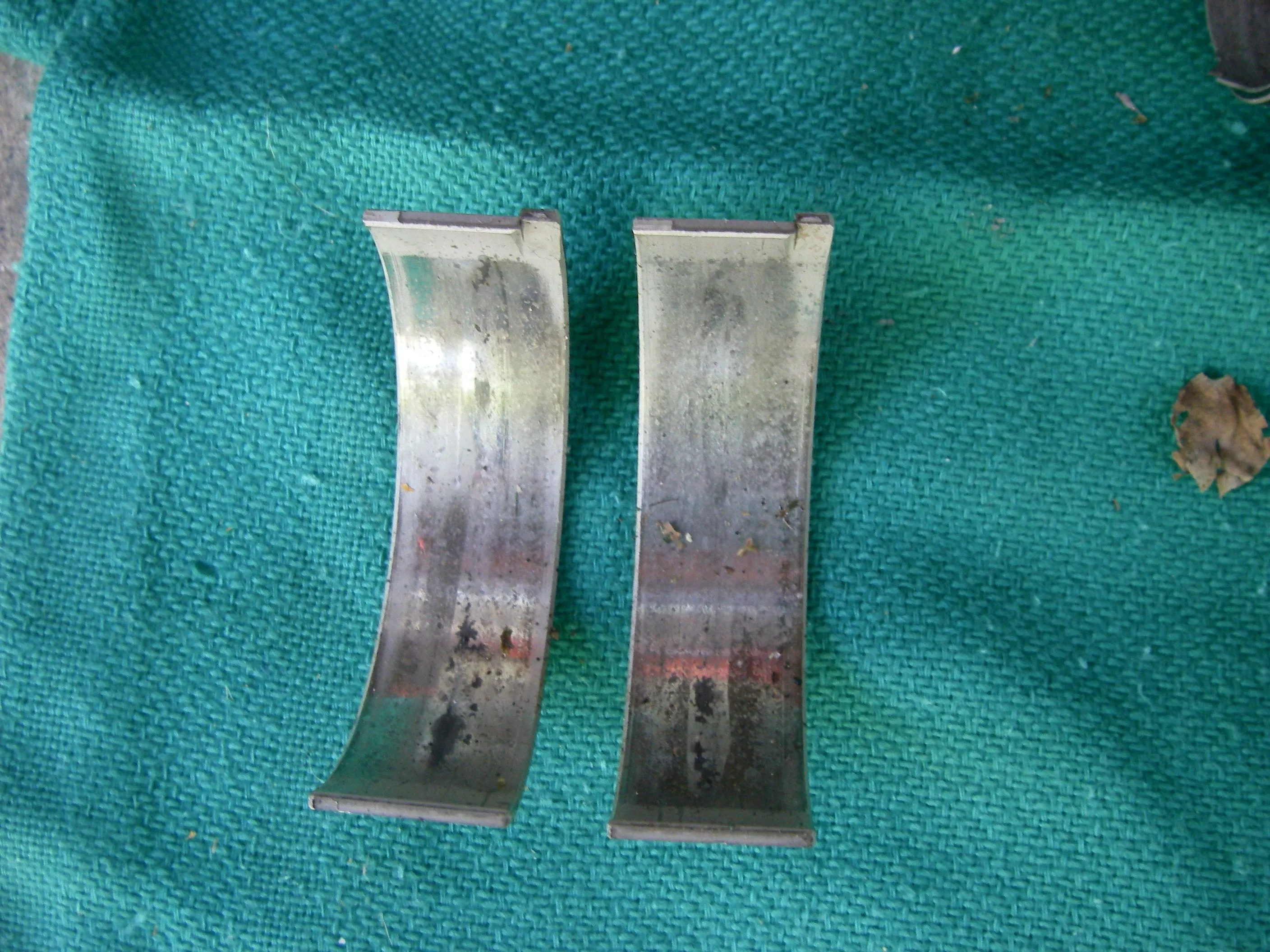

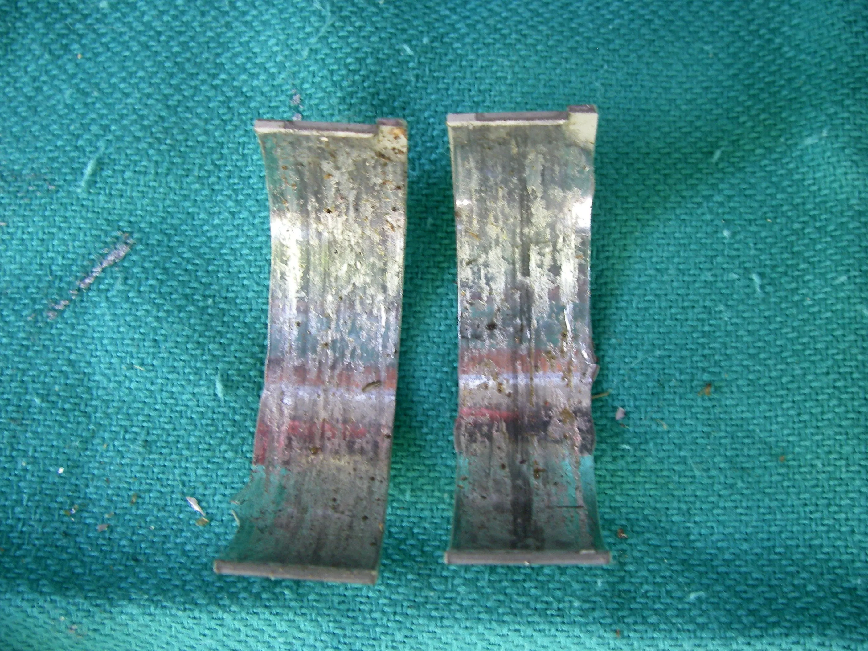

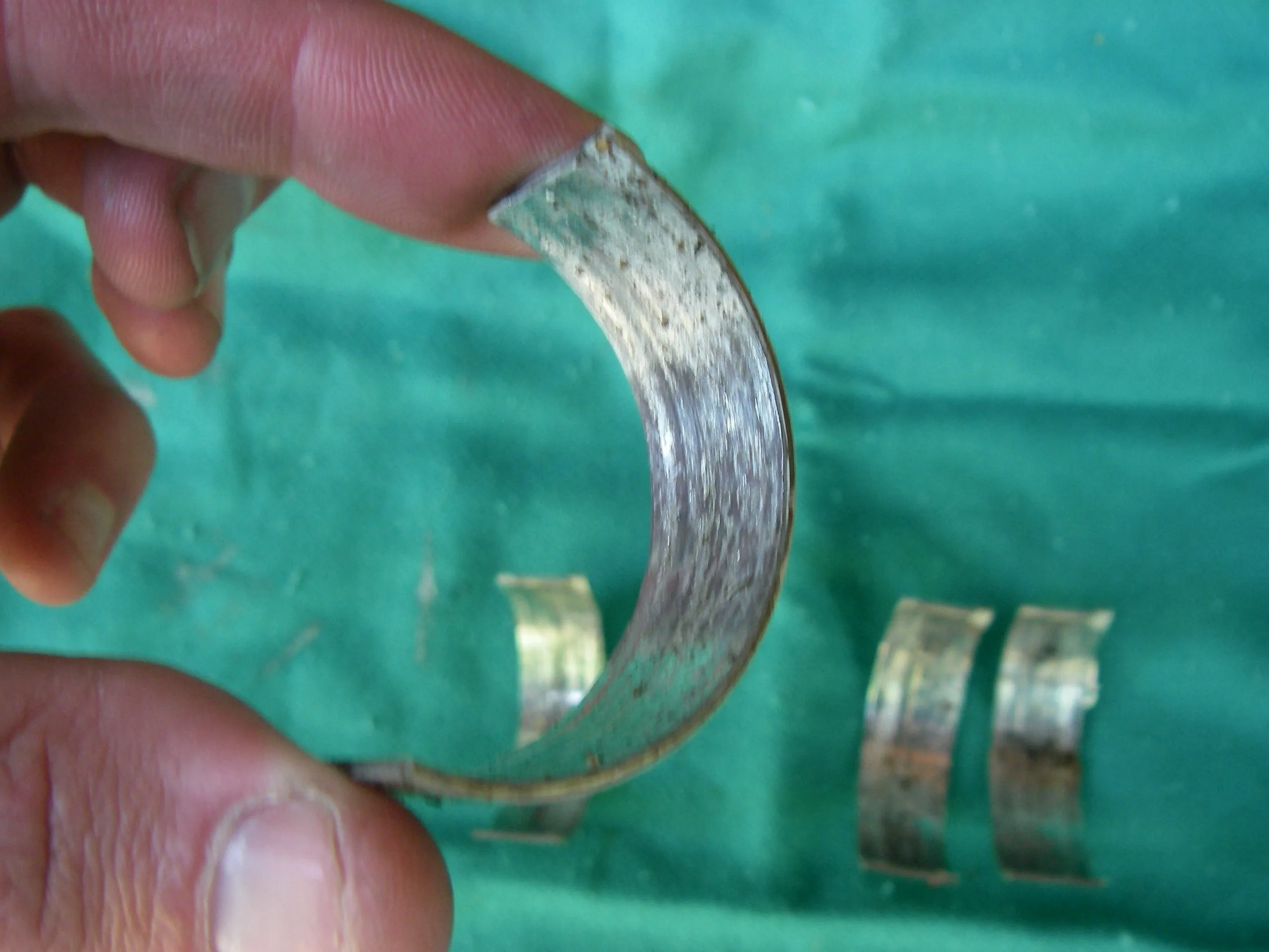

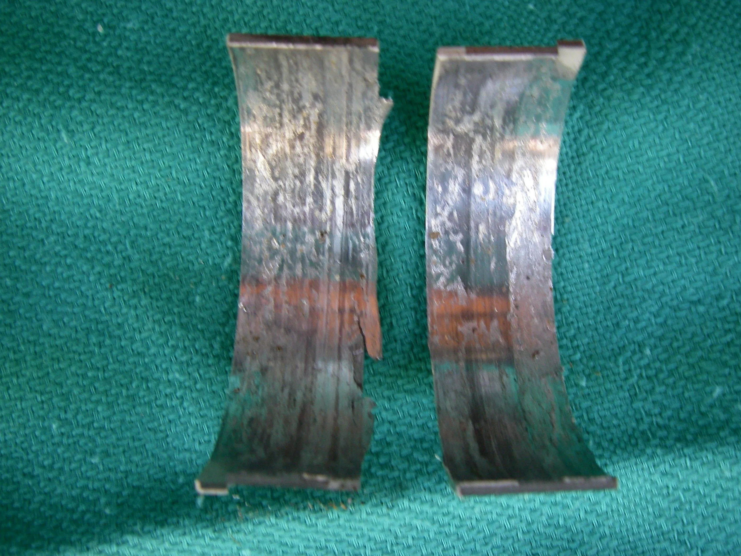

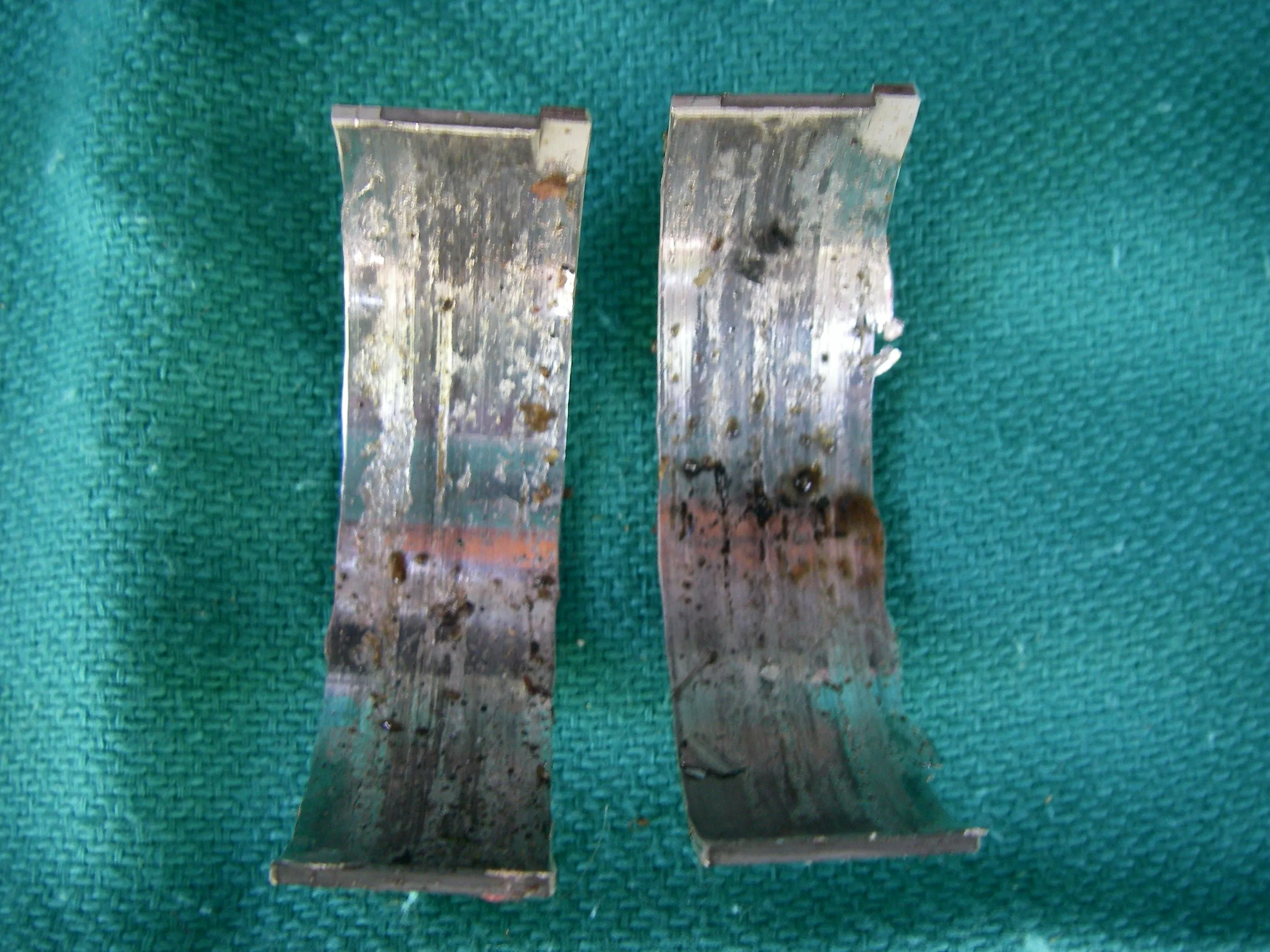

I'm driving it. No leaks so far so I guess I did a decent job putting the upper and lower pans back together and she drives good so I assume rods are put back together correctly. Only time will tell fully. Here are pics of the bearings.
cylinders 1 2 3 4 and then a closer up look at a bad one. Cylinder 1 bearings had no damage. Replaced with Clevite 77 OEM replacements.

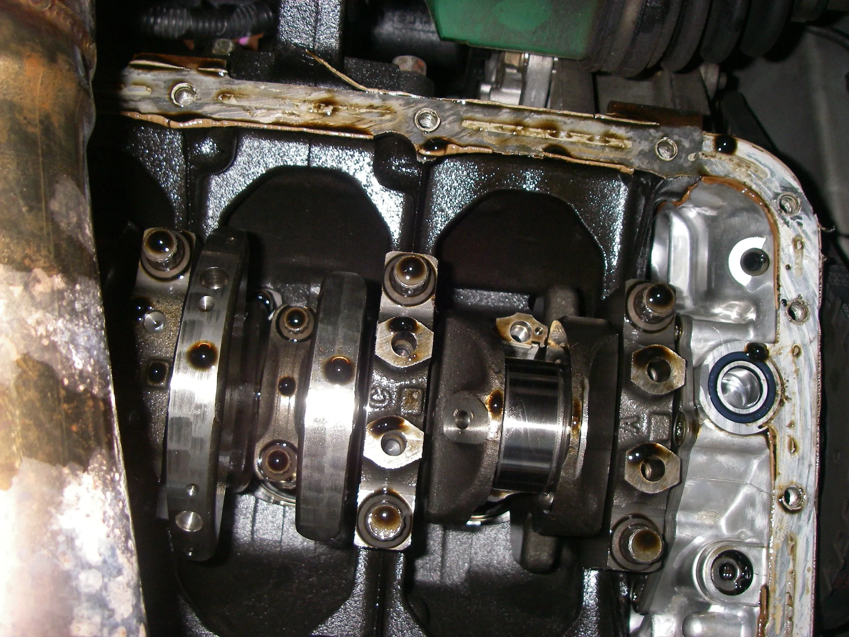

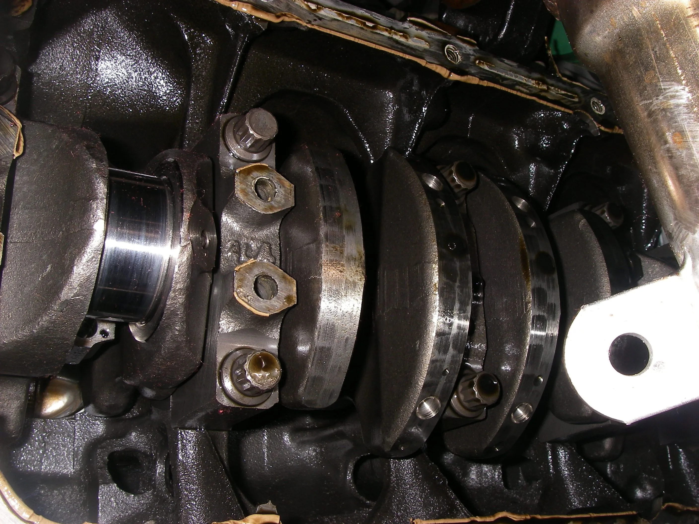

Inside of the block from the bottom. Rods 1 and 4 are disconnected from the crank. Where #4 bearing goes was a little discolored, we are thinking from heat but all four were smooth and no gouging. I did run 2000 grit polishing emory over them for measure.
