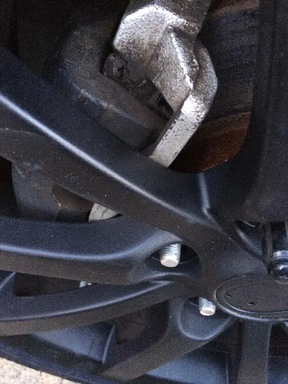

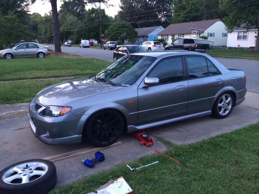

so for those that rocked the mx'5 wheels on their MSP, did they require a spacer to clear the strut/calipers? if so, will a 5mm spacer do? i think i remember reading that somewhere but i can't find it.
this wheel
I don't recall needing a spacer, I never ran those rims but I test fit a similar set of NC 17s and they fit fine. They have the same +55 offset and backspacing as the MSP RHs, I believe.

so i ended up needing spacers. used 5mm. without spacers, the spokes touched the caliper bracket lol.
attachment.php
attachment.php
