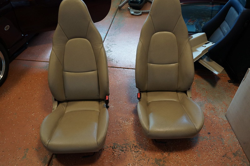

I went over to my storage and removed the sliders from my stock seats. Came back home and started in on the NB2 seats. First thing was to pull them out of the box. The seller packaged them very well, and even included instructions to assemble the seats (they broke them down into backs and bottoms for ease of shipping). The seat pans were discolored with the usual "rust" that you find on stock seats. In this case it was more of a patina on the metal.
I decided to hit it a lick with WD-40 and a red cooktop Scotchbright pad to remove any nastiness.
That cleaned it up somewhat. I decided for s**** and grins to see what I could do with some metal polish I have, the not as rusty looking area in the middle is the result:
This is the polish:
Some day when I am bored (maybe after I retire), I'll pull them out, tear the seats down and polish away. It's nice to know I can get them that clean.

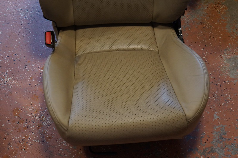

After assembling the seats, I proceeded to clean the leather. Here's the initial views before starting:
Kind of scuzzy. Here is the result after some scrubbing with Lexol Cleaner, a microfiber cloth and a scrub brush:
Not too shabby given they are used seats. Finally, here is how they looked after some Lexol Conditioner:
Finally, the money shot with them installed:
