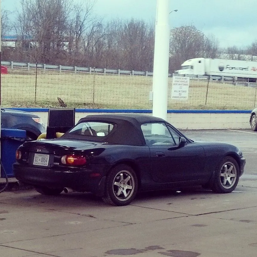

I breezed through DC inspection, installed my newsed black top, and a style bar I got cheap. I may not keep the style bar. I'm on the fence about it.
Pic of black top and double hoop style bar
