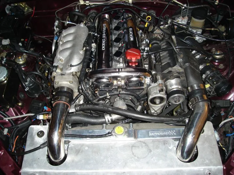

Did some small jobs today, the end is in sight but not quite within reach. I had some problems getting the correct PS belt, I did find some info about how BRP set up the tensioner so I modified mine to look like that in order to have the ability to easily tension the belt. Spal fans are mounted on the shroud, I'll have to source some connectors because Mazda mounted one connector directly to the motor (never seen that before). Doing some work on the gauges to end up the day, looking at the wiring diagram to figure out where to make the power and light connections.
Ran around town and got (hopefully) the last supplies. No one had a DB9-USB adapter, ordered via Amazon with one day shipping but there was an issue so doesn't look like that's happening until Monday. All the hardware is installed in the engine bay now, Spals and IAT sensor hooked up. Just have to put the undertray and front bumper back on (later tonight), then wire up the gauges and get the MS put in. Here's a picture of how it looks now.

dam chief, that looks amazing

Thanks Pablo, it seems like it's taken a while (and it has!).
