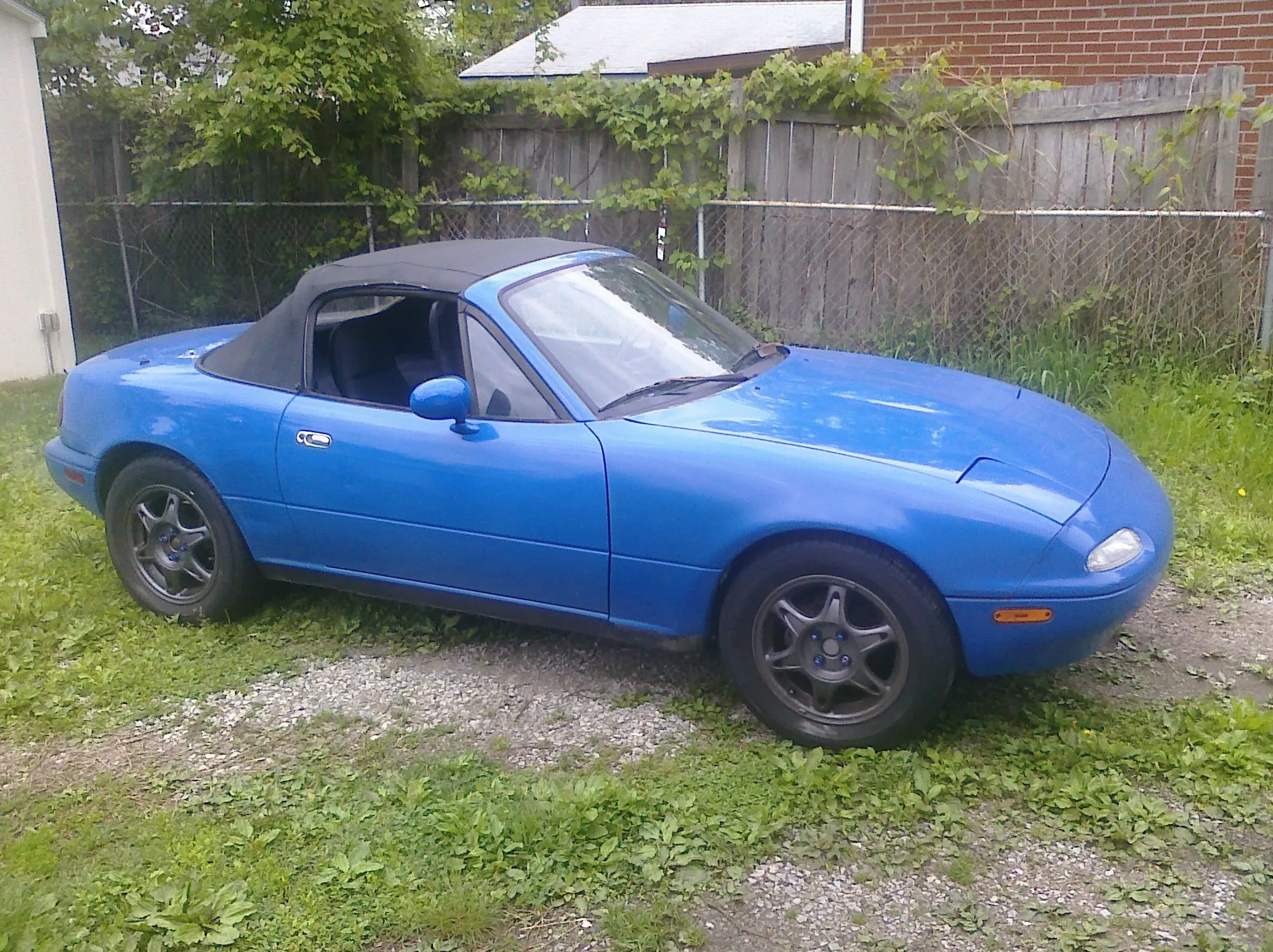

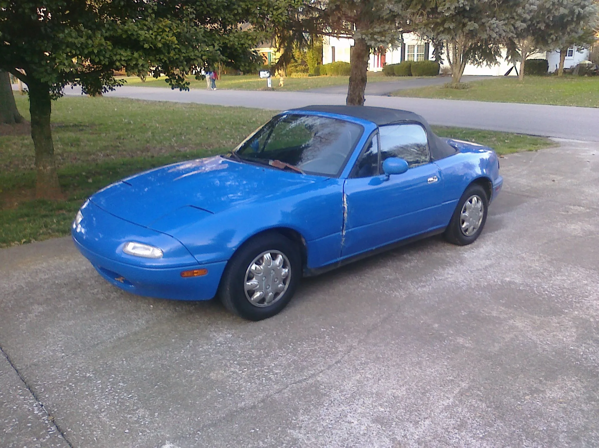

Installed new wheels/tires over the weekend. From those ugly hubcap steelies to these. They're stock off a '96 Integra and painted a black/gray color. They were cheap and came with Falken Ziex ZE912's.
