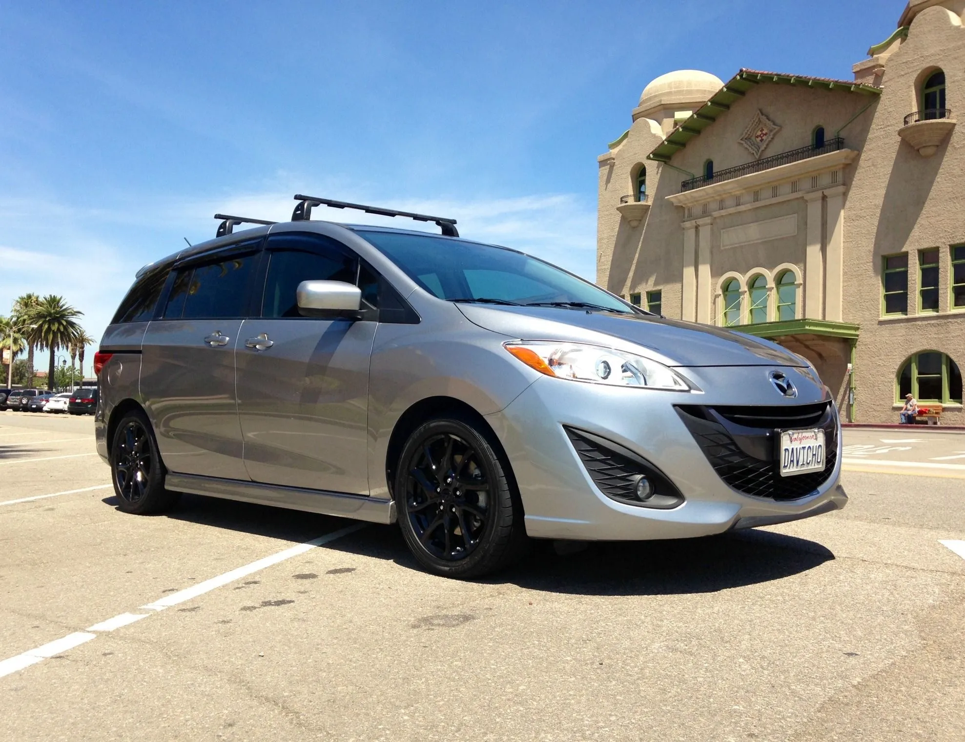

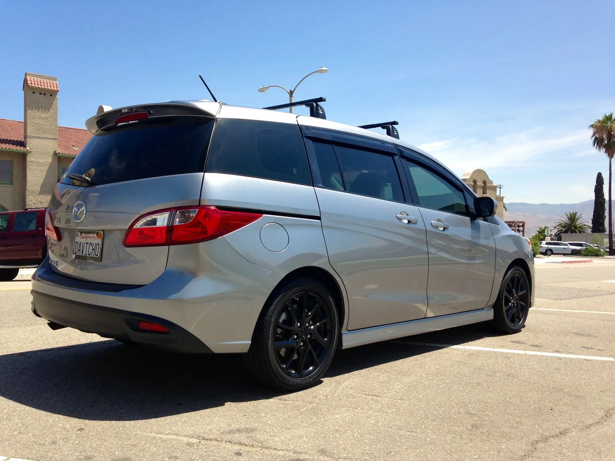

New freshly painted gloss black heels for my girl!
You need gas?
Or that you are trying to look like a manual trans car... when your dash tells a different story. lol.
Both lol, yeah, I've always liked the look of manual cars ( previous car was a 5-speed) and eventually I'd like to add a color shift boot to change the monotone black and grey of the interior interior.
Thats a really cool idea! I like it a lot. You never really look at the shifter when you are putting it in gear and such, that what the dash display is for! I'm going to assume that you just ordered a manual trans shift surround and it goes right over the auto shifter, right? Or did you also shorten the shifter? And yes, Davicho the compliment was directed at you car is looking GOOD.
