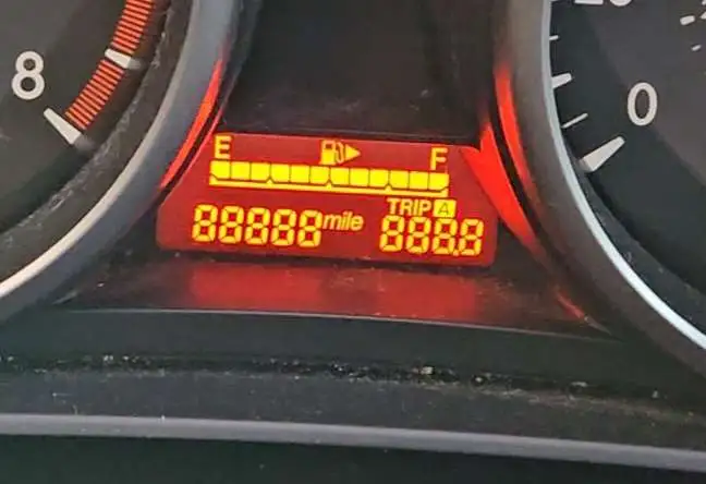

I know it's a silly coincidence, but today (January 8th), my baby finally hit the eights - 88888.8!

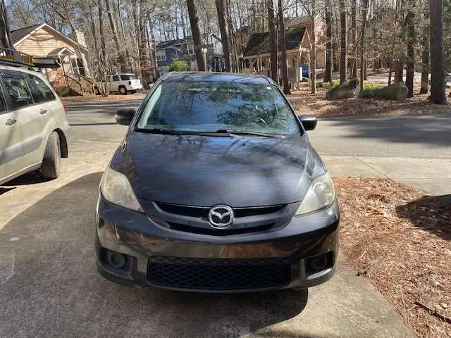

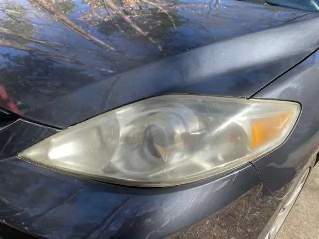

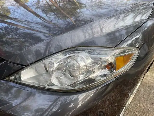

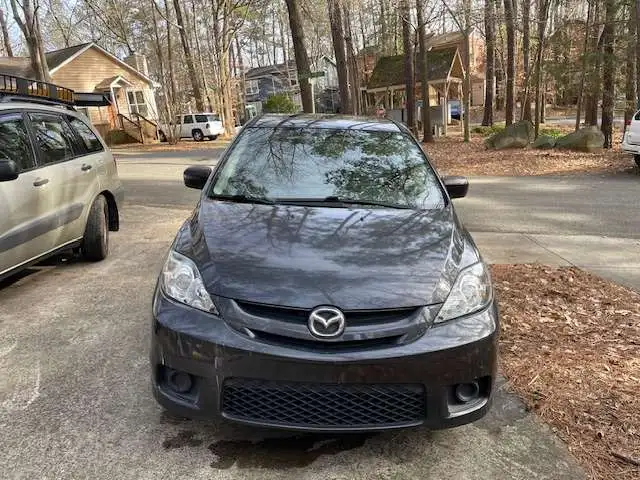

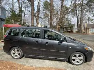

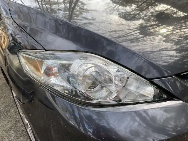

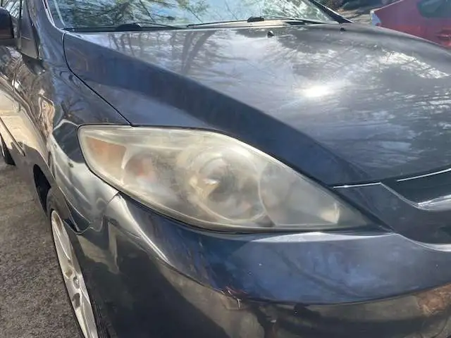

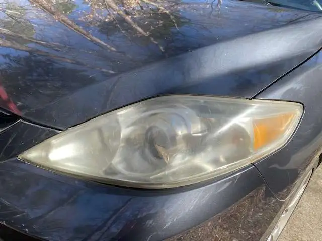

Just bought our new-to-us, old-to-the-world, little zoomer this Friday. Restored the headlight lenses today. Nothing big, but really satisfying.
What did you use to restore the headlights? Looks great!
Cerakote's headlight restoration kit: https://www.amazon.com (commissions earned)
It's pretty straightforward to use. I actually only used one of the two ceramic clearcoat strips (I had it left over from doing the headlights on my Rav) that come with the packet, so you can probably do two cars with one kit. That's what I did, and it looks fine, though I don't know if using one wipe for two lights will jeopardize the longevity of the treatment. Time will tell.

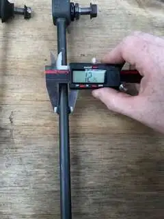

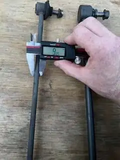

Replaced the front stabilizer bar end links (they were shot) with a greasable pair from Moog. Removing the nuts on the bottom bolts was a bit of hassle (but not too bad). Other than that it was pretty smooth sailing (so nice dealing with rust-free southern cars). The Moog sway bar end links look substantially beefier than the old ones (12.75 mm diameter vs 9 mm diameter, see pics).

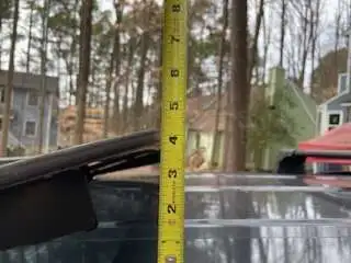

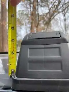

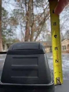

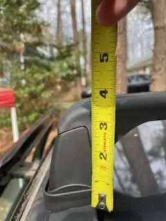

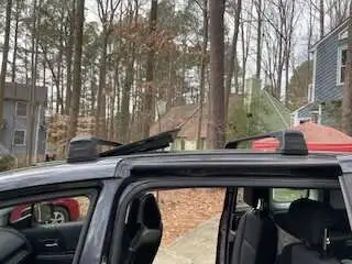

I also installed roofracks (actually a few days ago, but forgot to post). They're some cheapo ones from Ebay, but hopefully they'll serve their purpose well enough. They were supposed to have a clearance/height of 4.25 inches (from their description on Ebay) but are closer to 3.5 or 3.75 inches (see pics). This is an issue because my lil zoomer has a sunroof which extends ~4 inches above the roof of when open (see pic). Due to the location of the roofracks, the sunroof can still open (just barely) with them on (see pic). However, if I attach a roofbasket to the racks (which I plan on doing since I have one leftover from our deceased Rav4), then the sunroof will definitely hit it. I think I'm gonna try and raise them up a little bit by adding some rubber footings below them.
