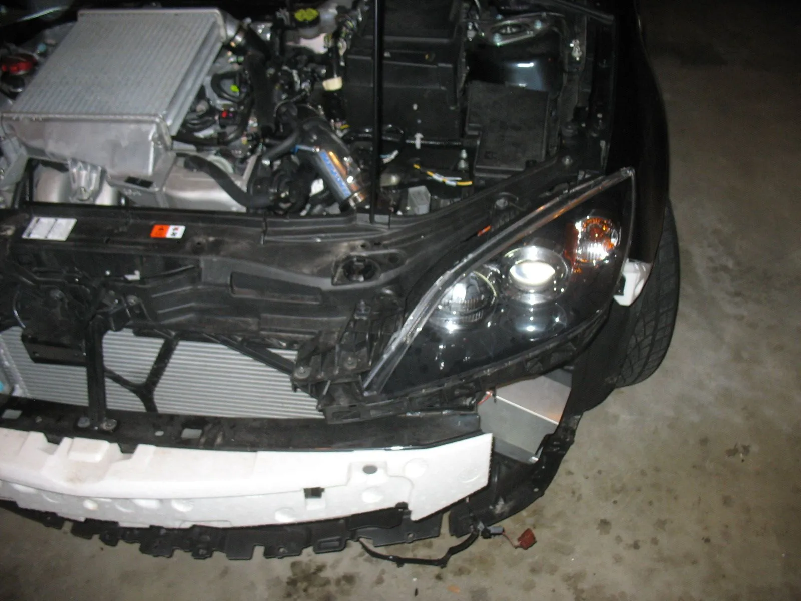

I ended up taking my bumper off for my CAI install, it made it really easy to put on and wasnt as bad as I thought it would be to remove. I thought I'd share a pic incase anyone was curious as to what it looks like with the bumper removed. When it comes time to clean the filter though, I'll definitely just go through the wheel well.
