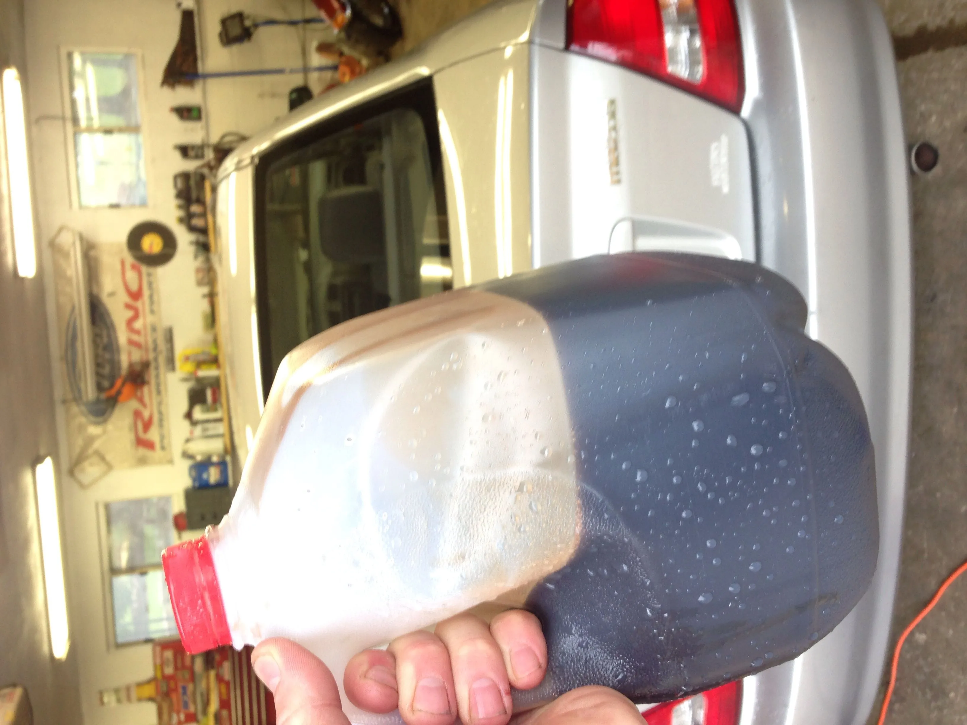

I just drained out the old fluid and put in new redline! That old stuff was so black!
I will drain and refill after my next oil change (4000 miles)
Pic is the old fluid!

Feels good to have it changed out, even though the car doesnt act or shift any different it makes me feel good thta it is fresh!
