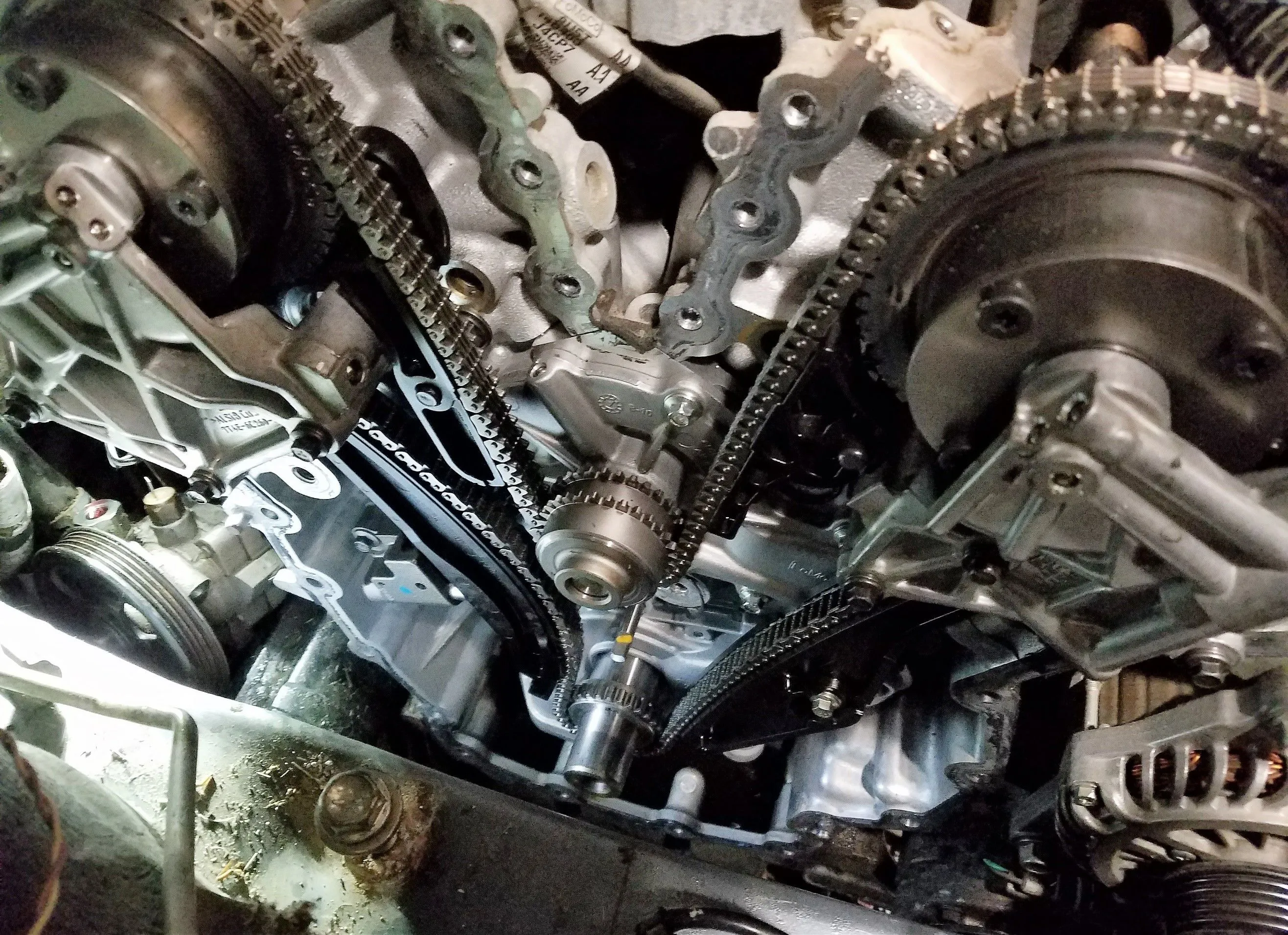

I'm doing a timing chain and water pump replacement on my 2011 CX-9. I just got the timing cover off today, it wasn't easy, but so far I haven't seen the need to pull the engine. If this proves successful, I'll put together a DIY with pics since this seems to be a very expensive repair if the dealer does it. I've done a lot of research on common fail components for the 3.7L engine, so I'm doing the chain, tensioner, water pump, and both Variable Valve Timing (VVT) actuators (right bank and left bank). I wouldn't want to have to do the tear down again any time soon.

I'm rooting for you to succeed. Based on what you are saying it looks like it is the same as the explorer. Let us know what the end result of this is. I hope that you can accomplish this without pulling the engine out.

I received my parts and specialty tools, so this weekend should be the moment of truth. I'll document as I go.

I just pulled out the old water pump, so it can be done without removing the engine from the car. While i'm in there, I'm also replacing both VVT Actuators since they are easy to do at this point.

It looks good. Having the service manual (in pdf) helped so I had all the torque specs and order for tightening sequence. I haven't gotten everything back together yet, but I did replace the water pump, both VVT actuators, the primary chain, tensioner, and guides. I had some parts drama, which slowed me down some. the water pump I got from Napa did not mesh with the chain, it was the wrong sprocket. The Mazda dealer did not stock it, but I checked with Ford (since it is a Ford engine) and cross-referenced the part number on the old water pump and they had one in stock, so I'm OEM with everything now. I should have it together tomorrow so I can test it out and make sure there are no issues. I was very careful with the timing marks on the cams, the VVT, and the crank (lots of alignment needed with DOHC set-up). I feel good about the timing mark alignments, so I do not expect any issues. In terms of time, I think if it is your first time doing this particular repair on this particular car, I would plan for a full day for tear-down and another full day for reassembly. I think it could be done quicker, but there is always a learning curve and lots of stopping to check instructions, etc. Keep in mind I did the VVT actuators as well, which contributes to the length of the repair. I learned a lot and will work on putting together a DIY for anyone else that feels up to the task on this one.

For just the water pump and primary chain replacement, there is not much needed in the way of specialty tools. I did need special tools for replacing the VVT actuators though because you have to lock down the camshafts when removing the VVT actuator, it is really torqued down tight, but a breaker bar or cheater pipe will do it. It also took a T55 torx socket bit to remove the bolt, but that is a cheap buy at Autozone. Removing the crankshaft pulley requires a puller, but you can get the free rental at Autozone for that as well. I'm willing to share tools, but would require a deposit for the cost of the tools and reimbursement for whatever the shipping would come out to be.
