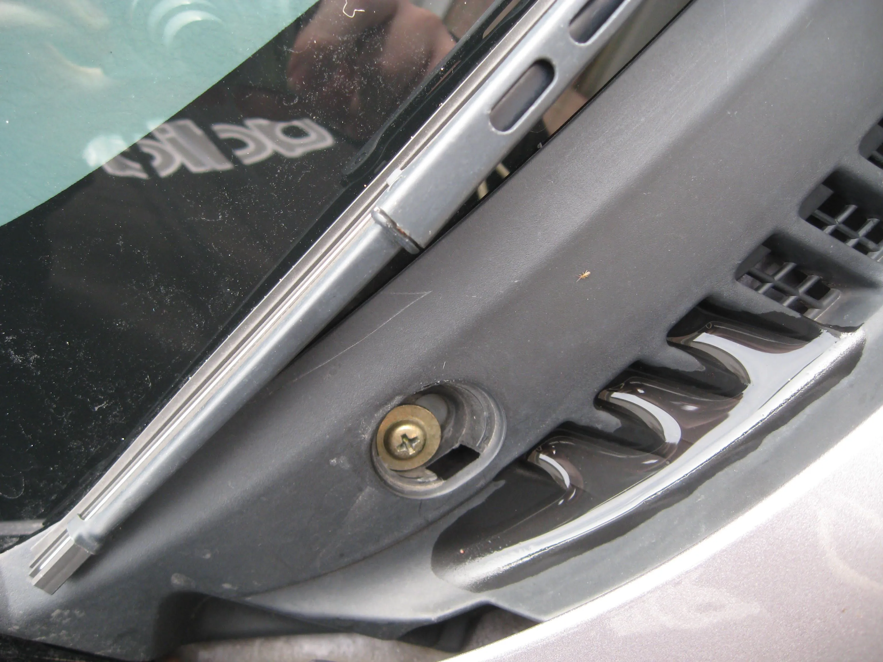

take a look at the pic
today i noticed that the little cap thing is missing and theres a hole there, could be the culprit?? i have no idea how long its bgeen missing tho
Also, that is just a beauty cover over the bolt. Doesn't seal anything.
