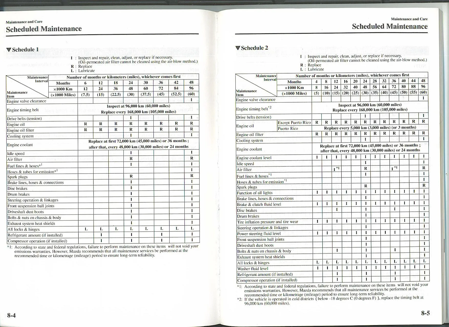

yeah I am missing my manual . If you could dig it up and let me know what needs to be done at 90K I will greatly appreciate it :)
Thanks man!

Ok here is some of things at 60K miles:
I=Inspect
R=Replace
L=Lube
Engine valve clearence I 60k M
timing belt I
Oil & Filter R
Air Filter R
Coolant R 45k M
Fuel lines and hoses I
Hoses and tubes emissions I
Spark plugs R
Brake lines I
Locks and hinges L
Hope this helps. You can do all this yourself. I would buy all aftermarket stuff like NGK plugs, ss brake lines etc. Flushing the rad is easy, they are all the same so google is your friend here, scrub it, flush it, replace hoses, replace cap, there are many how to out there read a few of them to get some ideas.
Thanks guys !
Thanks man I appreciate the scan, I know it was an effort :). saving me a good $200 sweet!
