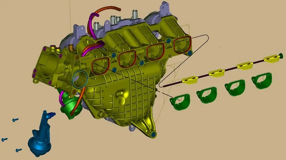

Unplug the VLIM and VTCS solenoids (either the vacuum lines or the electrical connector). If the noise goes away when you unplug the left one (left as you're looking at it, not the vehicle's left. The red hose in the attached picture) then the VLIM is bad and you have to replace the manifold. If the VTCS is bad, you can remove it but then it idles bad and drives weird.
Ummm... if you have a speed3, this may not apply.

the flaps in the intake manifold are definitely made from metal, atleast the one we had here before it got shipped out for prototyping.

Again, can't speak for the speed owners but the VTCS flaps in a regular 3 are definitely plastic, just like the rest of the manifold. I'll figure out about the VLIM flap(s) after I put on the new manifold and dissect the old one.
