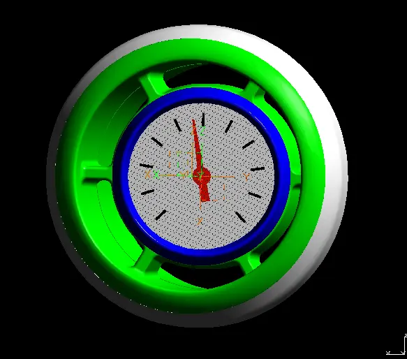

What do you guys think of this....I've tipped the gauge toward the driver at a 10* angle.
Better? Sorry, I don't have pics in vehicle. You'll have to use your imaginations for now. ;)

i think it would be hard to imagine that because in person you can see if the boost guage would be blocked by the side of the guage from where someone is sitting... if you get what i mean...
Yeah, I hear ya. Believe me, I would never let it go out knowing that was the case. I would definitely try it out first before I approved the production run.

Would you be able to rotate the pod in to my line of vision instead of say, down or up? It seems with your design the pod could spin 360 deg, and with the angle of 10 you would be able to rotate pod and square up the gauge towards my eye. When you are able to create a rotation point, vertically and apply the 360 for both pod and gauge you will have the world by its sweet potatoes.

i like it... i agree about the spinning of the gauge; the vent as it is now spins, would the gauge pod spin in the same fashion?

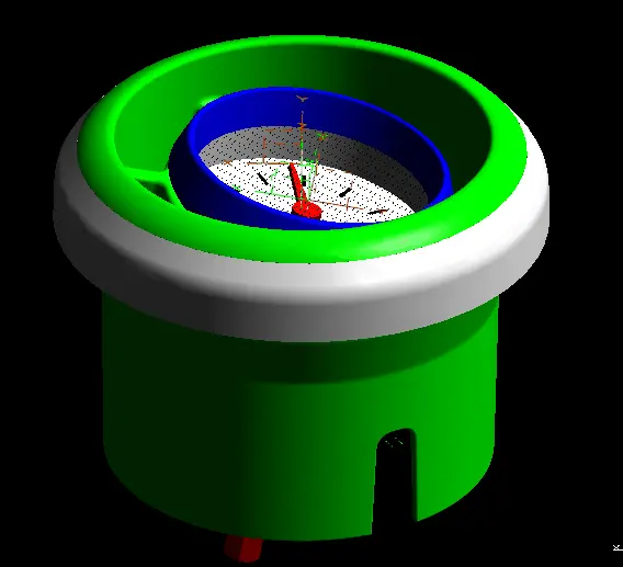

ericrapp, are you asking for the inner gauge barrel of the pod to rotate independent of the outer ring of the pod? That would be costly.
Right now, the entire pod is free to rotate in the dash's recepticle, so if you wanted to change the angle of the way the gauge faces you, you can just rotate the entire pod. You'll have to take care to plan what angle you want it to be at, because you're going to have a vacuum tube routed under there, and that tube exits the pod via a relief notch I've designed into it. (see that second thumbnail?). If you go spinning it around too vigorously, you may break your tube.
Does that make sense?
The VentPod is not designed to spin freely like the existing vent. Again, that would require that we add action to the tool, which drives the cost up. Basically, it would put the price of a VentPod up around $80-$100. I don't think anyone would buy them at that price.
The pod is able to be installed at whatever rotation you like, so to that degree, yes, you can rotate the pod.
