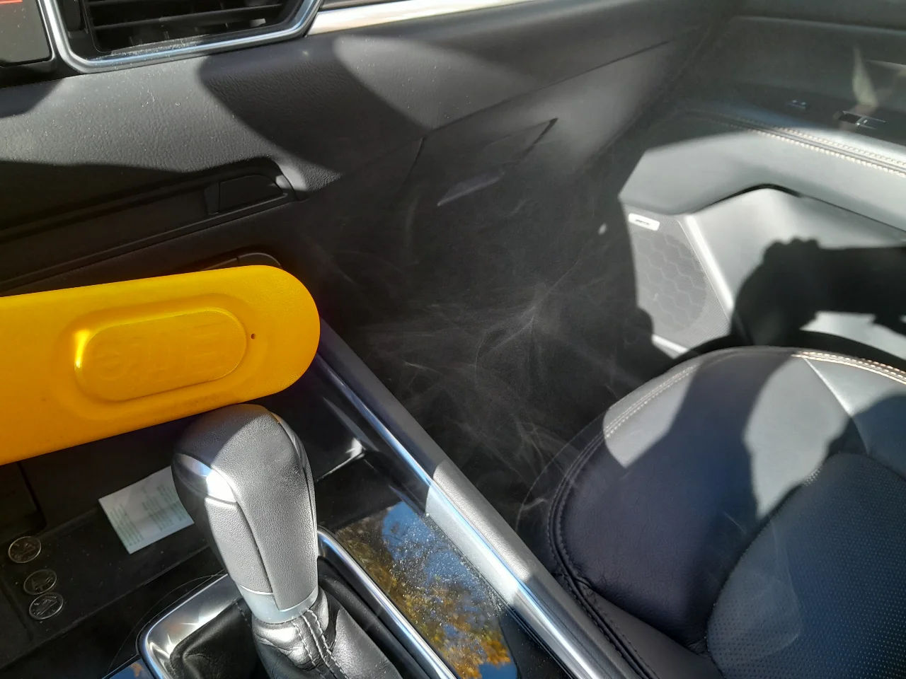

Hi,
had zero problems with my CX5 2021 GT non-turbo until today.
Wife took it for a drive to the shops, parked, was in there 90 minutes and then on returning the cabin was full of "mist / vapour".
She still drove home about 25 minutes, then on returning brought me out to look.
She said on driving back it didn't seem anywhere near as bad, when the engine and aircon was on.
I could see what kinda looked like air infused with vapour, almost like cigarette smoke but less so, and without any real smell.
This continued to come out, not pour but also not a tiny amount, out despite the engine being off and the electrics.
When I turn on just the electrics, not the engine, the aircon pumped even more into the cabin, again no real perceptible smell.
This makes me think it can't be the exhaust.
I'm going to leave it 20 minutes, if it's still coming I'm going to disconnect the battery in case this is an electrical short, however I'd expect that to smell?
Attached photo shows the extent of the smoke, not a small imperceptible amount as it's captured on camera.
Anyone got ideas on what this might be?

Update - disconnected the battery, kept going.
Waited until the engine temp dropped - it stopped. Some kind of evaporation based issue and the "smoke" is vapour.
Drove around again with the aircon on, nothing, kept going until the temp hit 100, still nothing.
Stopped the car, turned off the engine and aircon, vapour began pouring out again!
Sounds like the evaporator for the A/C inside the car has developed a leak.

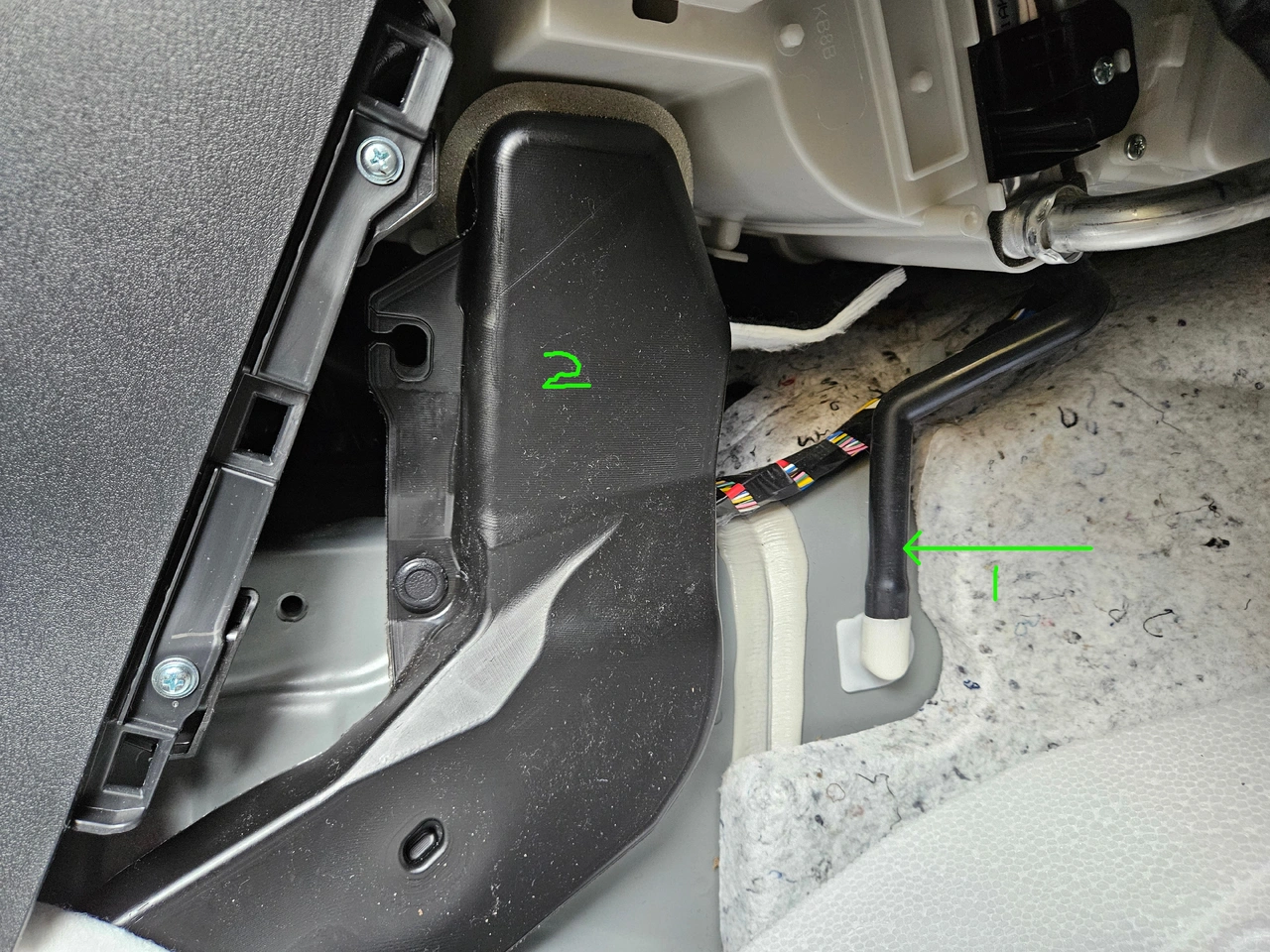

Okay so before I proceed further, am I right in thinking the AC drain is "number 1"?
Or something behind 2?
What do I do here? detach the rubber with a cup under it and get water flowing out?
If I do have "too much water", how can I proceed to find the root cause?
Are we hoping that something int that small segment has blocked it?

Yes. I would fire the beast up and see if you get that vapor from somewhere. Does running the a/c get you water dripping under the car?
Many years ago I saw what the OP is describing. Basically the temperature and humidity inside were such that the cold air from the A/C caused the air to hit dew point. In other words fog. The cold air escaping the vents immediately caused the warmer, moister (relatively speaking) interior air to hit dew point and it looked like fog or vapor escaping the vents.
Yeah, I second Jmaz. I used to travel a lot for work, and planes often had this vapor coming out of the vents (and had the stewards reassuring everyone there was nothing to worry about!)
I doubt it's anything to do with the A/C drain. A blocked drain's more likely to cause smells than vapor.
This is what it was like in the car with the missus.
I did check the a/c drain, it seemed dry, couldn't recreate the issue today but it was a bit cold so the engine temp didn't get up to 100C.
