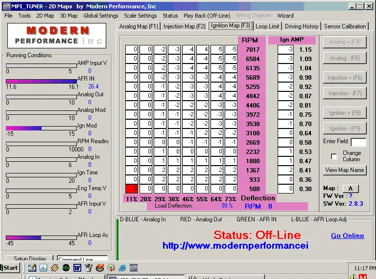

chaz--I see you are retarding 9 degrees up top in the WOT column, seems a bit much! If you take the -5 in the WOT column and add the -4 in the IGN AMP column you are taking out 9 degrees. I had this on mine and when I got rid of the IGN AMP value I think I noticed a difference, but can't be positive. If you look at Beavis' ignition map he only has -3 at the top with nothing in the IGN AMP column and that's with an MP3 ECU and the J&S telling him where nock is.
Everything else looks good though. I see you also made your analog values in the WOT column to an 8 from a 7. I think I can actually go with a 9 up there since I am only about 4.7 volts or so. That will give you some more fuel, but don't know if it's needed or not. I think the 9 will be right at the 4.8 to 4.9 volts mark. Is this with your fuel cal at 7? How does she idle, good?

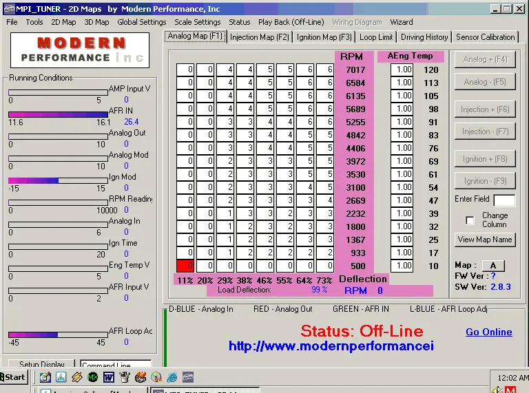

Well..Today i was at Modern Performance. Got to install my inline fuel pump. It's an MSD INline Fuel Pump. Had some problems installin but i followed Flyin Protege manual..And got it installed.
When we finished it was already 8pm. So we didn't have time for the EBC. Hopefully Before Dyno Day.
Well when i was driving home..the car was buckin..and just driving like total donkey s***. As soon as i hit boost the car would buck violently...Well..i pulled over..and loaded an old map. And did a little tuning.
Car began driving well..But way to rich..I was runnin 11.6 a/f in all gears.
I am going over a datalog i did right now.
Chas
Please take a look at my new maps..If you could..please take a second to email me..and i will send you a datalog.
Chas(drinks)

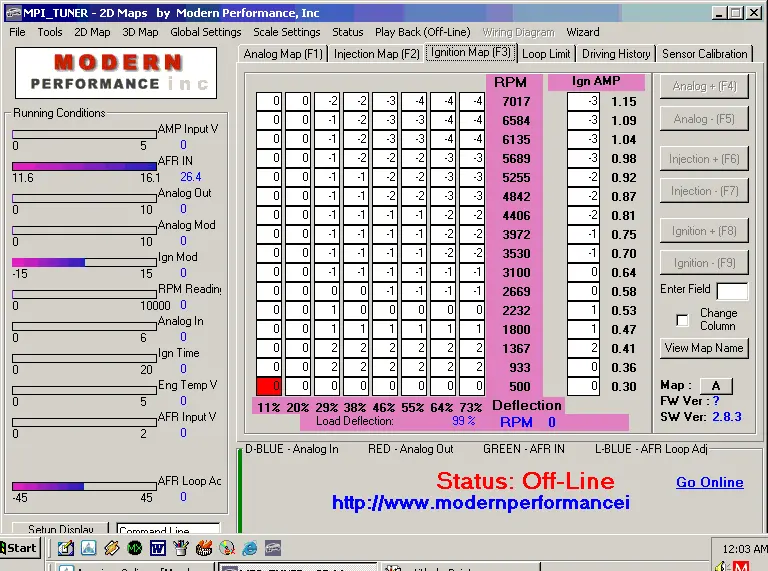

New maps..
Chas
