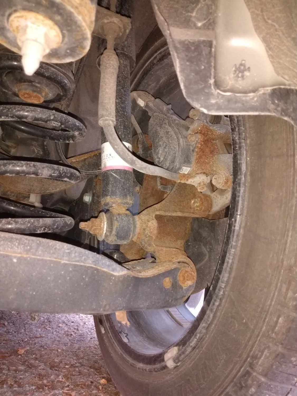

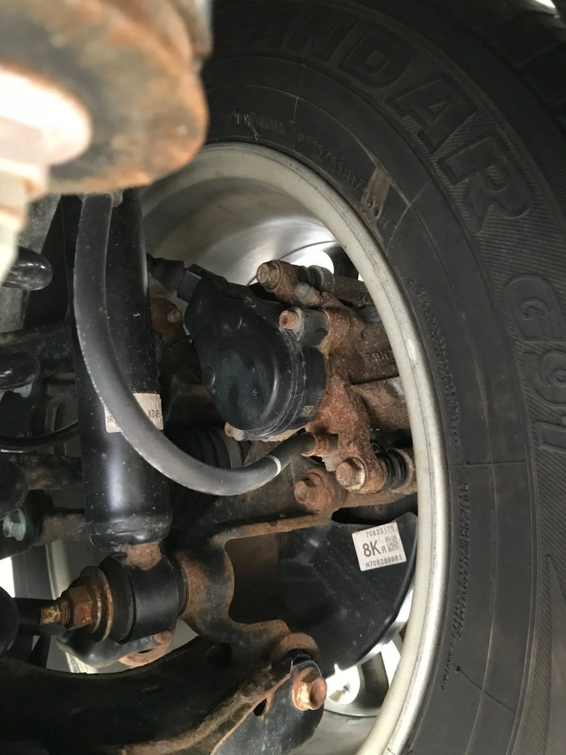

Recently I had taken my 2017 GT for a routine oil change and maintenance at 15700 miles to the dealership. While waiting for completion of service, the tech sent me a video text showing and declaring all looked well under the car. However, I noticed several rust spots (see attached pic). I live in the NE dealing with snow, ice, and salt seasonally. Is this amount of rust an issue, or could be one long term? Will appreciate any insight on this matter. Thanks.

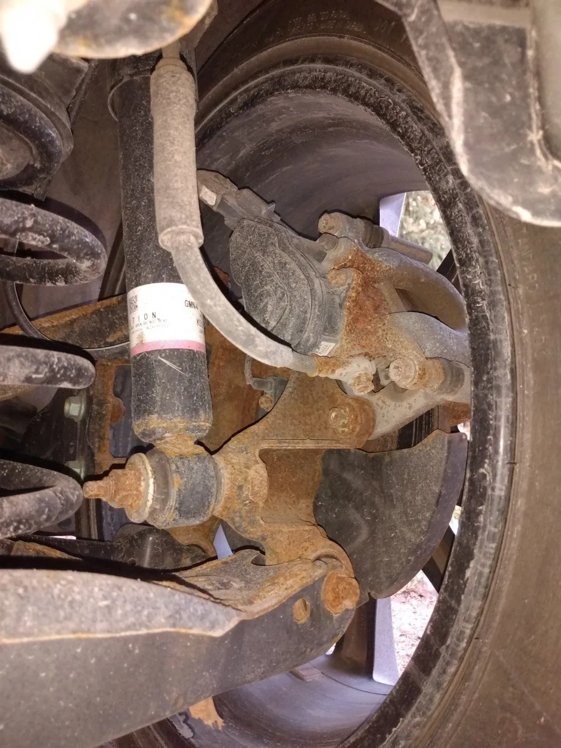

Plenty of rust complaints on suspension、undercarriage、and brake calipers:
I'll try and post some pics of my rear brakes soon. It's not just the rotors either. The calipers and brackets are rusted badly as well.
Same as gazelle said too: never happened like this on any of my previous cars.
I was very surprised at the amount of rust in some areas but the dealership mechanic assured me it is normal. ⋯
Photo of the rust I was talking about:
View attachment 234064View attachment 228722

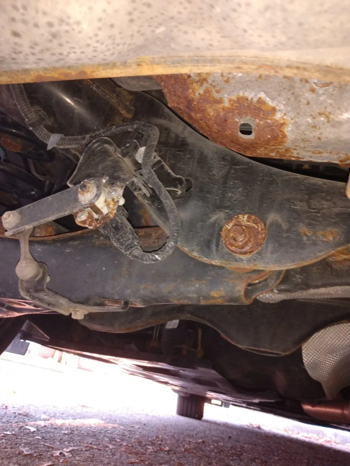

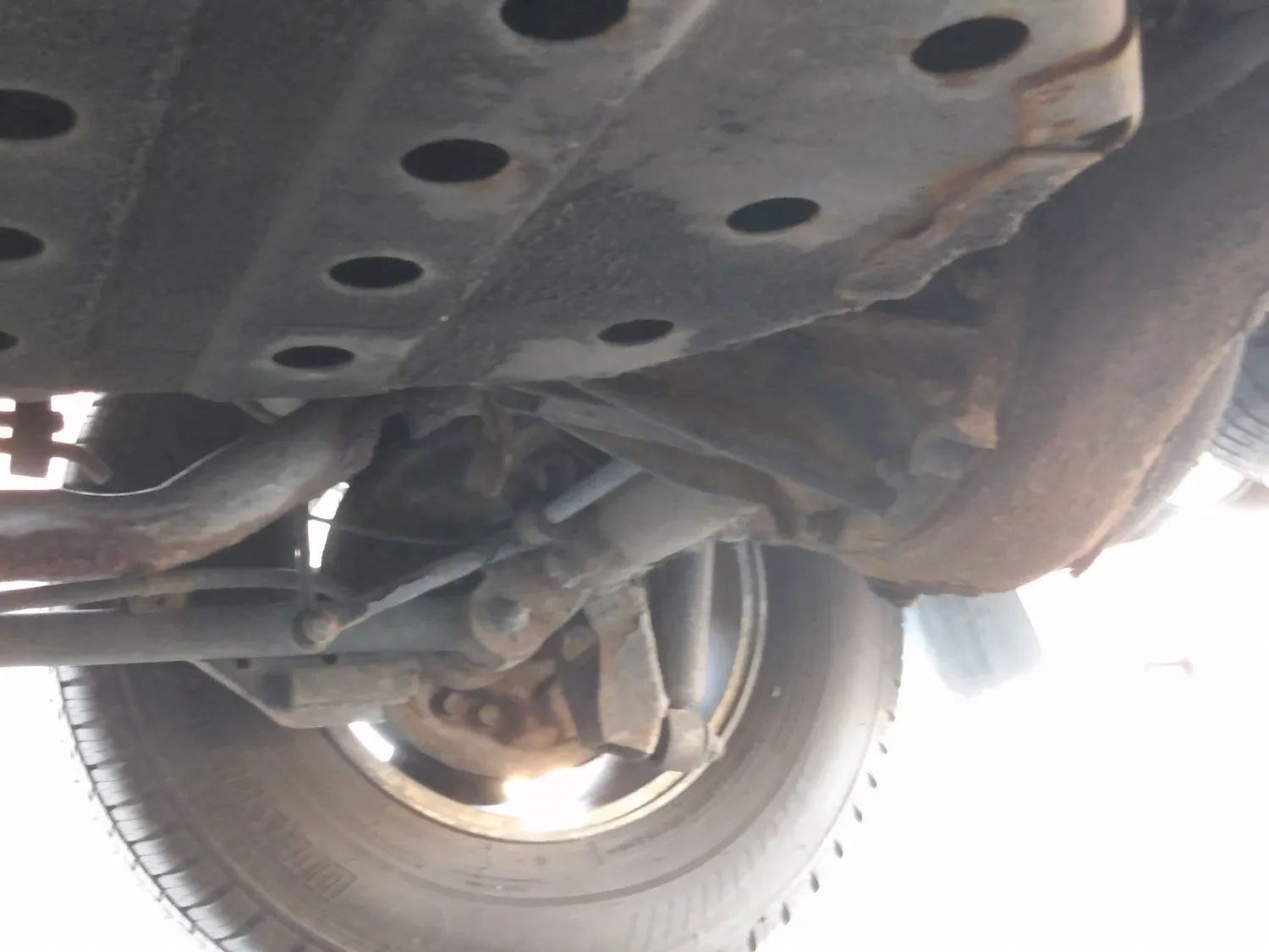

Another recent very rusty undercarriage after two or three years from a CX-5:
previous year, un treated.
North east US.
I dont honestly believe Mazdas have good rust resistance even today. yeah may be better than 10 years ago but not the best.

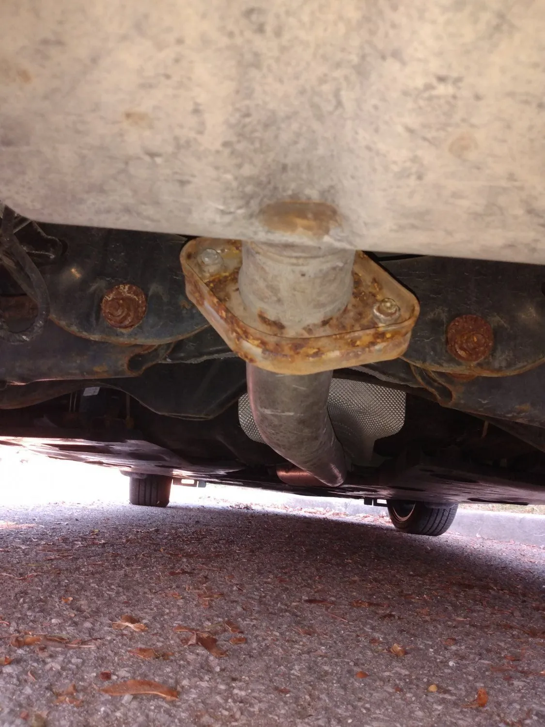

This CX-5 should be from Illinois:

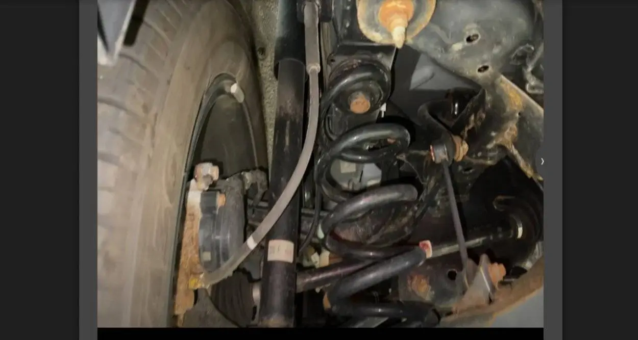

Just spent 3 hours under my 3 year old CX-5. Did AT, Engine and 2x TC oil changes.
Rust level in various spots on 36 month car was tad too much. Mark this post, but in 4 season weather I don't see this version last 10 years.
If this is CA/FL type of no salt climate - all should be fine, but winter states beware.

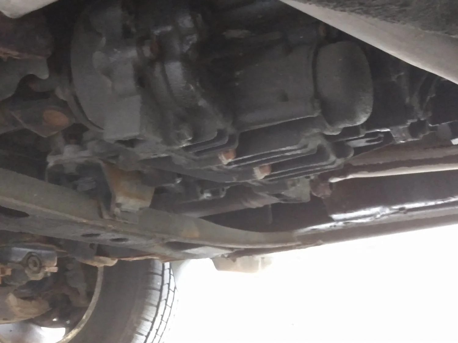

This CX-5 is from Toronto area in Canada:

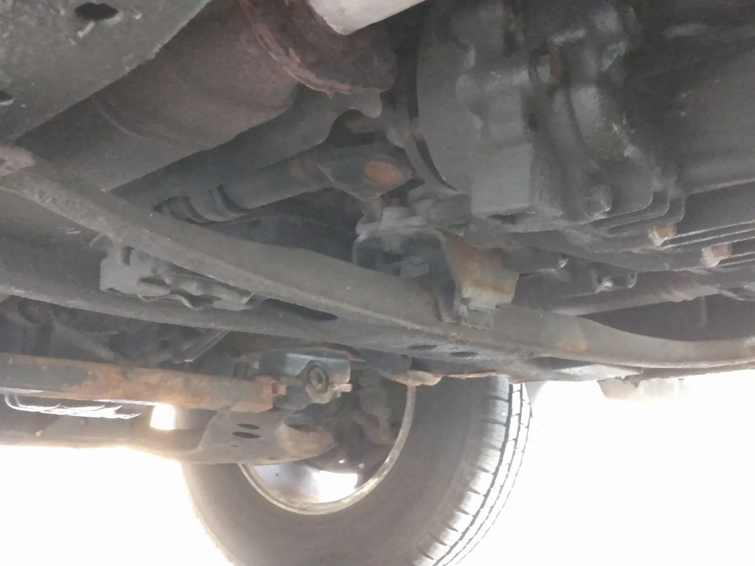

Here are comparison pictures between his CX-5 and Toyota Matrix from Southern New Hampshire:
Rust like that after a few years even with heavy use of salt I believe is unacceptable with today's coatings and materials to look worse than a car that is 13 years old is not acceptable. How can Mazda get away with this? I love how this car drives and looks but also want one that will last. Also very happy with fuel economy so far getting around 30.5MPG on my 100 mile round trip commute.

I regularly see 1st gen CX-5s (2013-2016.5) year round here. I also live in an area that regularly sees ice, snow and salt for what seems like half of the year. It seems the rust is primarily a cosmetic issue. As far as I can tell, nobody has complained about the subframe or suspension components rusting through and failing - only that it looks bad.
To be fair, I have seen other vehicles with undercarriages that do not have that level of surface rust, so there is definitely still some room for Mazda to improve on that aspect. But nothing that would indicate a long term problem IMO. As a precaution, you can do an annual Fluid Film treatment to inhibit the rust and attempt to prevent it from looking any worse, or treat the rusty areas with POR15. But I personally think you have nothing to worry about :)

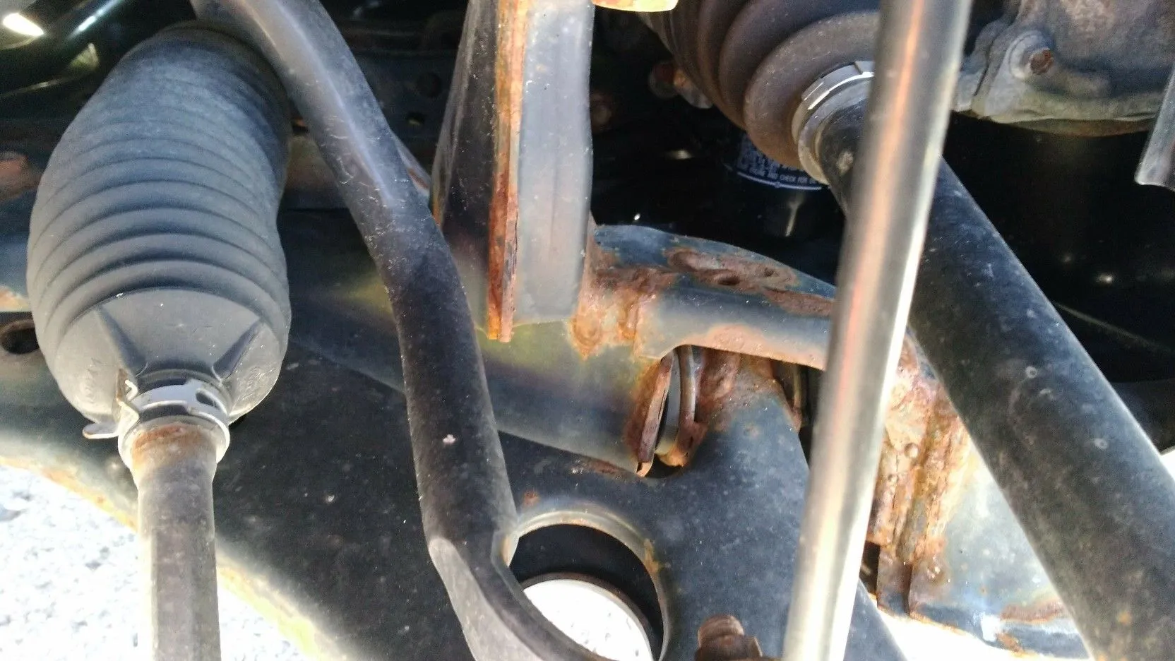

For DIYers fluid film is very effective. It does wear off from driving in water and snow, I spray here and there at the same time I change the oil. You have surface rust. You can stop it from rusting any further with fluid film, spray right over the rust. And like P-51 said, the thick tar like undercoatings can be problematic. There are a ton of videos about it.

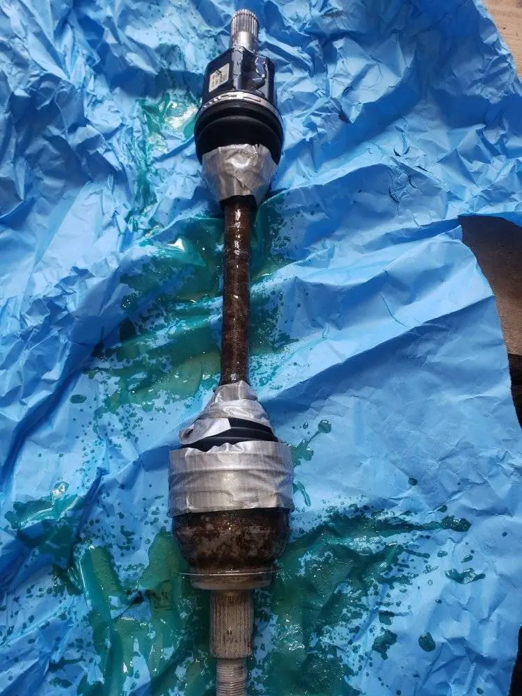

Hit it with rustoleum gel, clean it and spray some flat black paint on it. I just bought a used axle because the boot in mine ripped and it came from a rust area.. cleaning up now with rustoleum then throwing paint on it.
