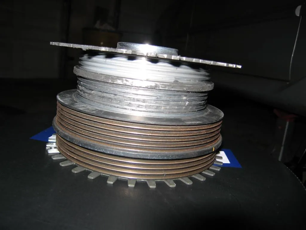

Well guys, I couldn't stand the squeaking belts anymore so I decided to go back to the stock pulley since I had to replace the belts anyway. I took a pic of the Unorthodox pulley next to the stock one to give you guys an idea of the size difference. When I used the UDP, I used the Goodyear Gatorback belts from Autozone and I used the sizes that they had in the system for our car. They were part numbers 4040360 (4-rib 36.00") and the 4050457 (5-rib 45.75"). In order to tighten the belts, I had to pretty much tighten the tension bolt all the way to the end. Looking at the position of the tension bolt now with the stock pulley in place, it's tightened about halfway. Not sure if this is the cause of the squeaking but if anyone wants to try shorter belts, I have found different size gatorbacks if you're interested. I think I will try giving the UDP another chance when it's time to change the belts again since I'm not pleased with the noticeable performance difference.
For those that are interested in trying the shorter belts, here are the part #s. I haven't tried any of these so don't ask me which ones to use. They may vary based on the size of your UDP.
Alternator belt (Stock is 4-rib 36.00")
4040332 (4-rib 33.00")
4040335 (4-rib 33.50")
4040340 (4-rib 34.00")
4040342 (4-rib 34.25")
4040347 (4-rib 34.75")
4040350 (4-rib 35.00")
Power Steering belt w/AC (Stock is 5-rib 45.75")
4050405 (5-rib 40.50")
4050410 (5-rib 41.00")
4050420 (5-rib 42.00")
4050435 (5-rib 43.50")
4050450 (5-rib 45.00")
