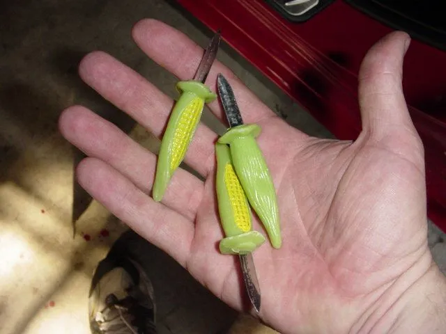

I scoured the house for paper clips not realizing they included them in the box. I used corn cob holders and they worked great! TWM is arguably the class leader in customer service. I've bought a lot of stuff from different car places. Between Ron Tonkin and TWM, I've been very well supported in the Mazda aftermarket.

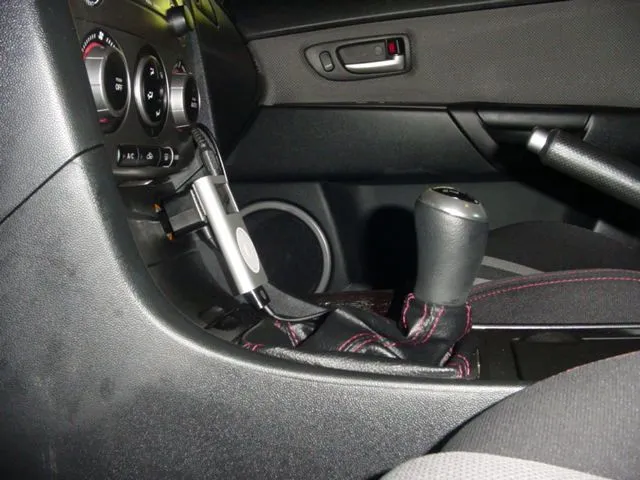

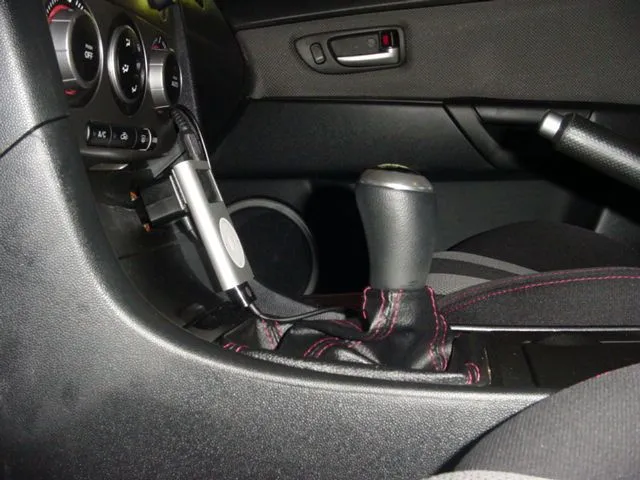

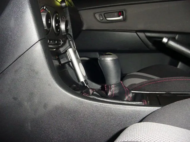

1st picture is N
2nd 1st
3rd is 2nd
4 is how I keep my hands butter free (and remove the stock shifter)
Here are some pics.

You only need one person to do it, I did it fine by myself. The hardest parts are getting those tabs out and lining up the ball on the side with it's hole while holding the spring up with needle nose pliers. You're definately going to need some small paper clips or corn cobb holders like Swamp used. There were no paper clips included with mine although Swamp said they were included with his... Oh, and if you don't have any grease you should go out and buy some now, that's also not included but required. They say to use white lithium grease.
