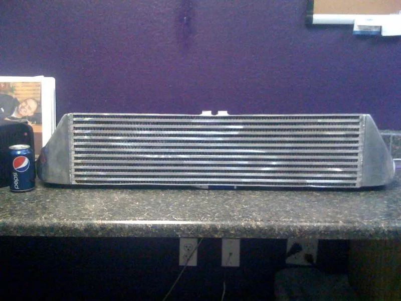

Here is a pic of a core off the car, it's huge. The pepsi can is so tiny sitting next to that core.
