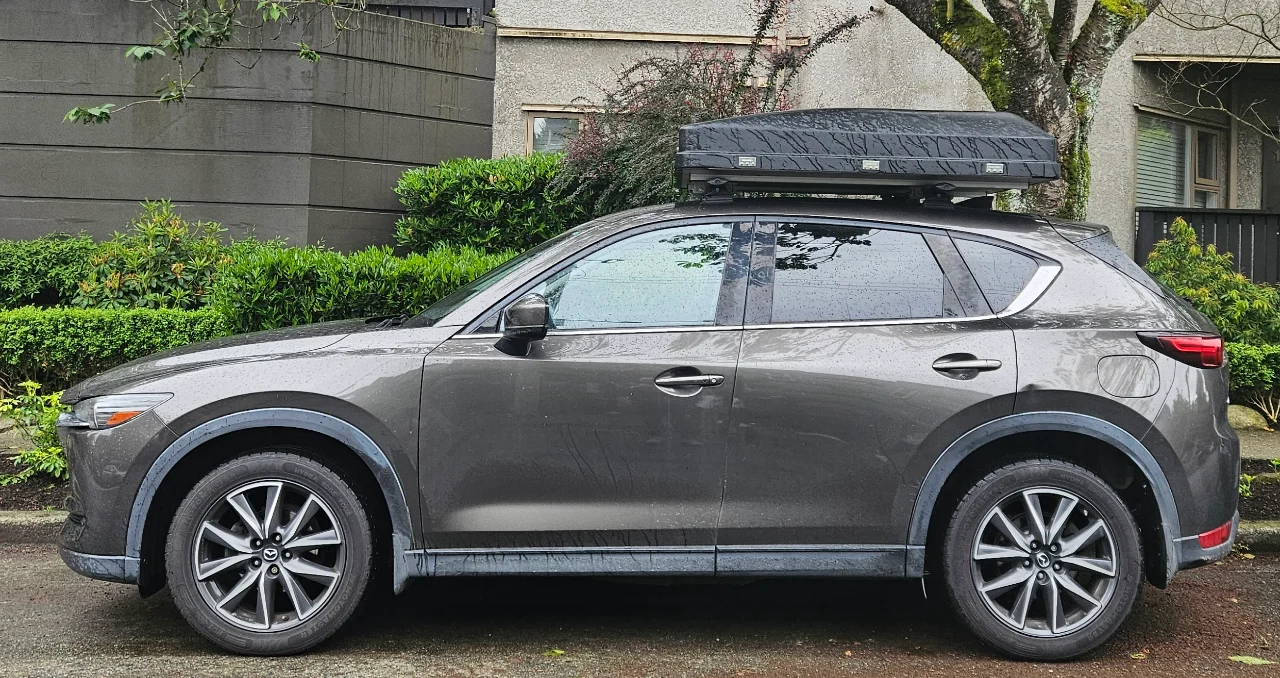

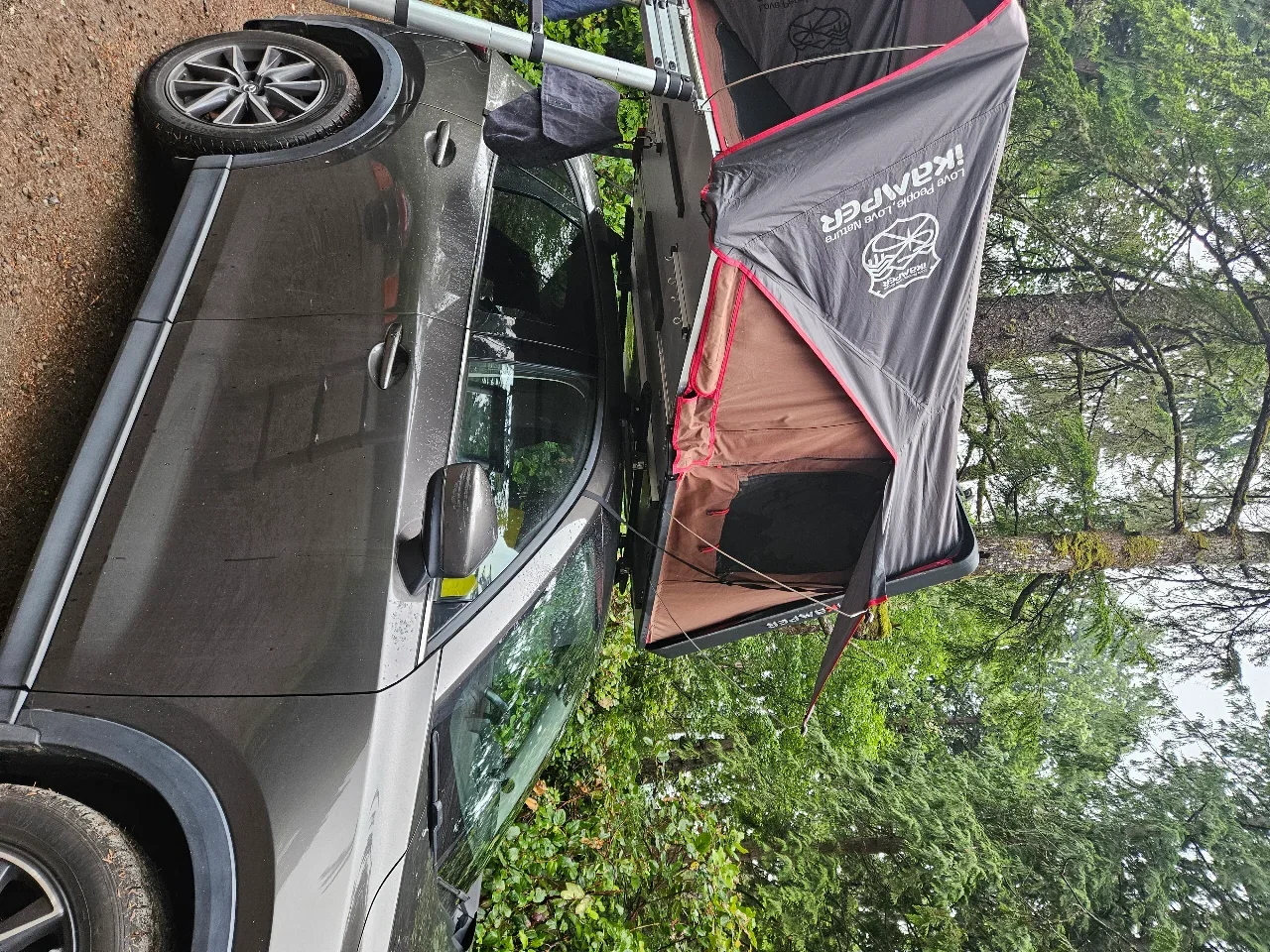

Added a couple pics of the tent - still don't have the panels attached
