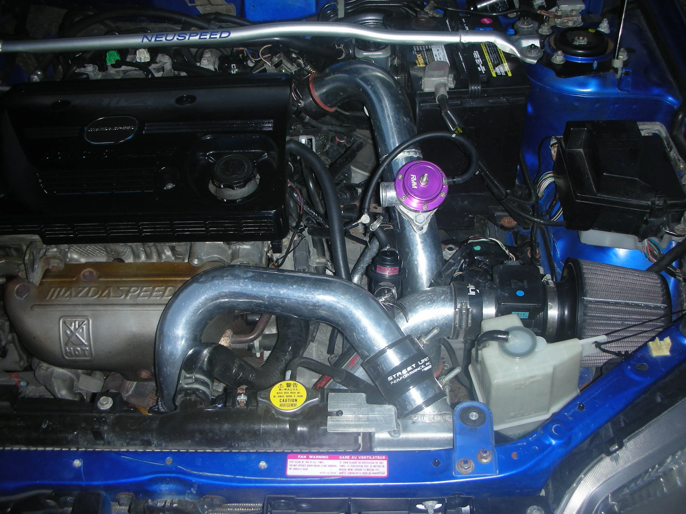

this is another option, does anybody have pics of the injen as an sri? I just want to see if the pipes for the wagner fmic would get in the way.

here is my injen sri.
thanks for the pic. I can't honestly suggest that you hold it for me, as I don't know for sure if I'll be able to take it off your hands. I need to take a pic of my setup and get some opinions if that will fit the way my FMIC pipes are routed. My gut feeling is no, it won't work, but I guess we'll see.
