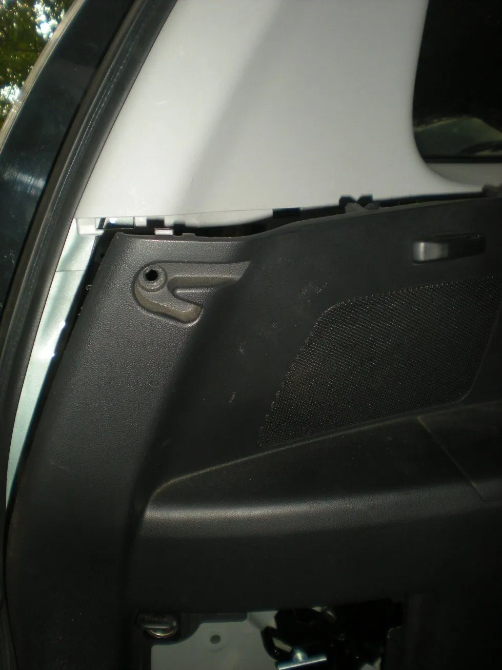

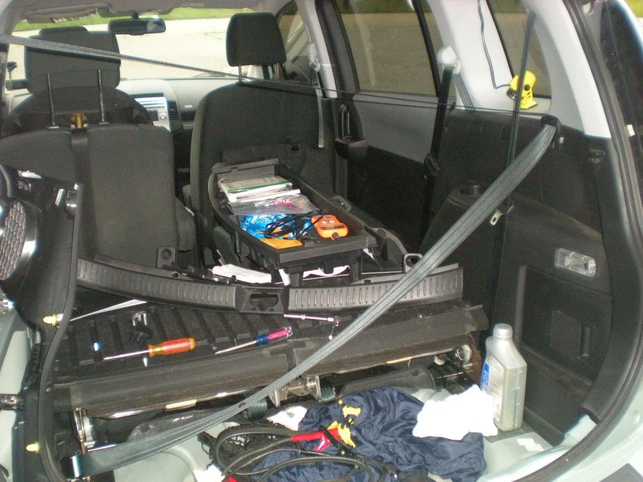

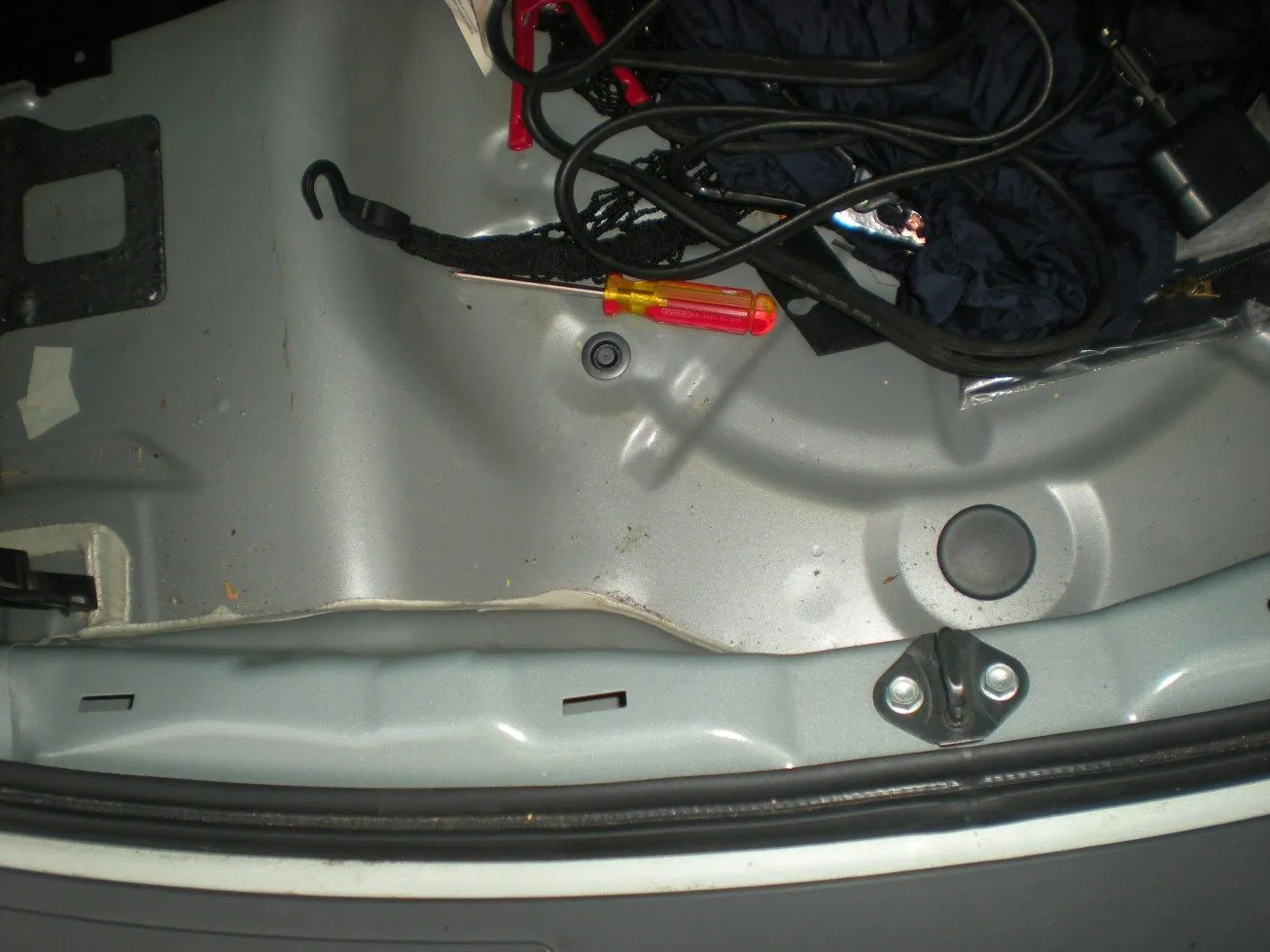

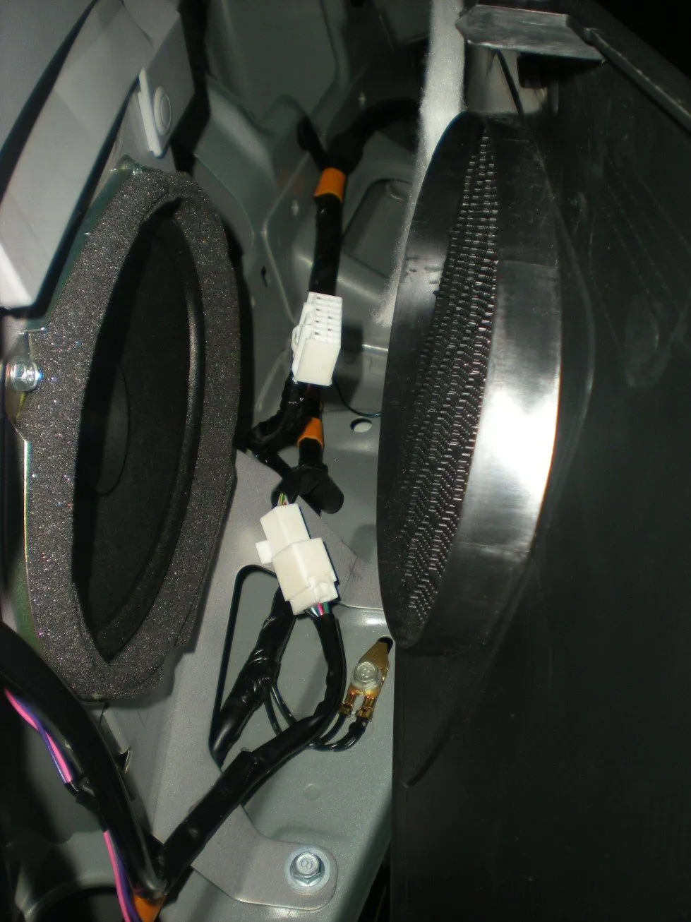

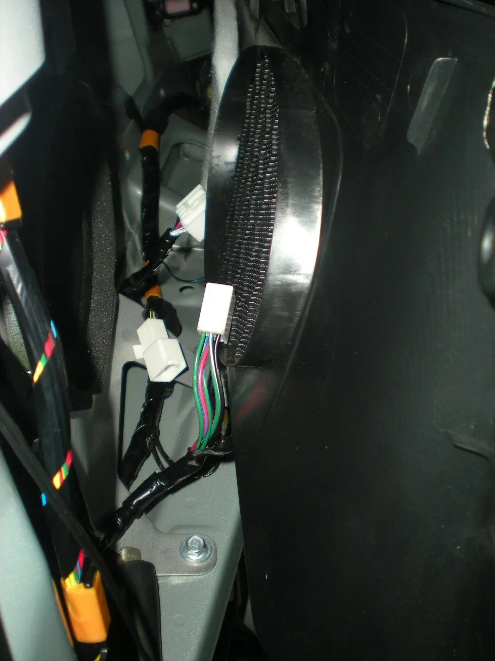

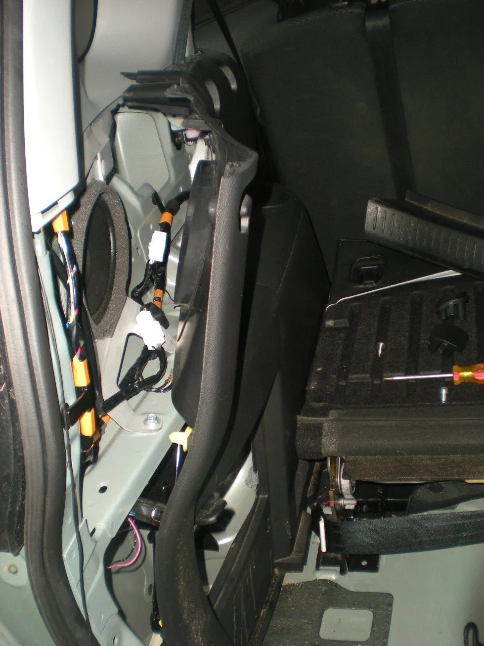

To get to the connector you'll need to do the following:
1) Flip the cargo tray cover all the way forward and remove the cargo tray.

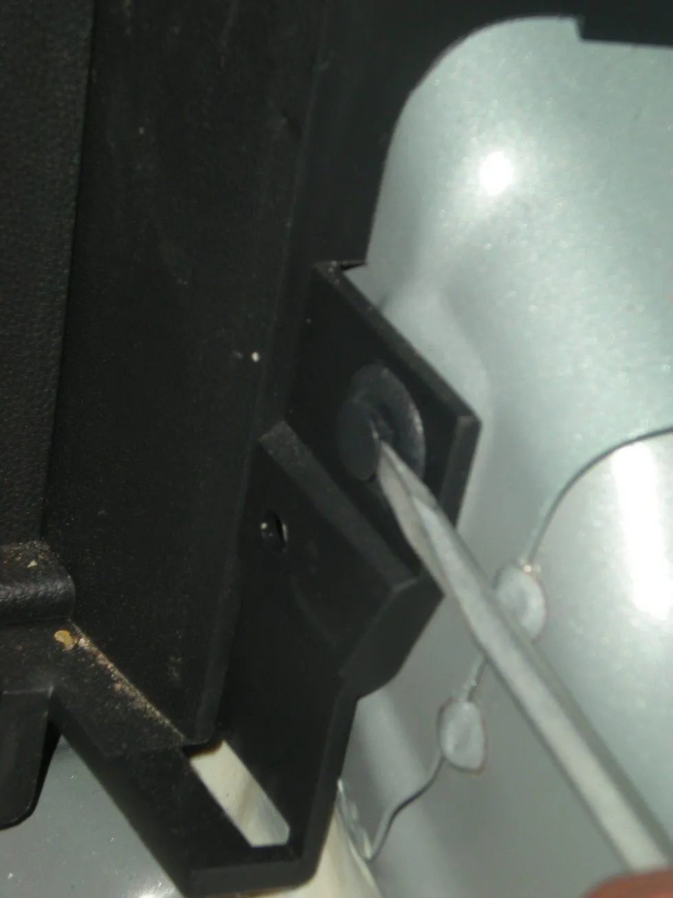

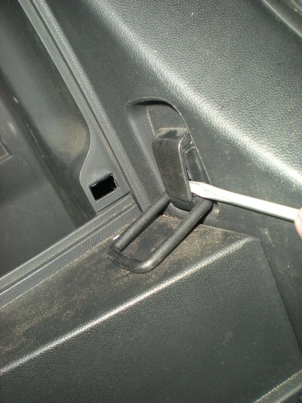

2) Pic #1 Using a small flat screw driver pop the inner portion of the pushlok connector, one one each side, and remove the rear sill panel. It is tough to see in the picture but there is one on each side.

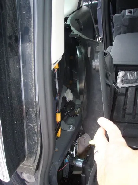

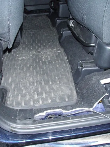

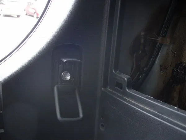

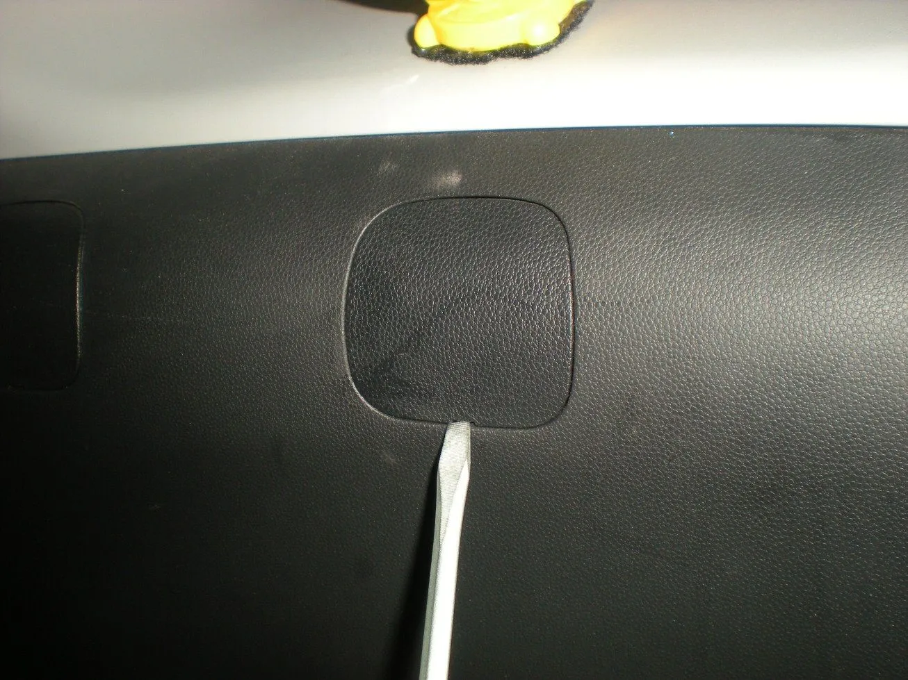

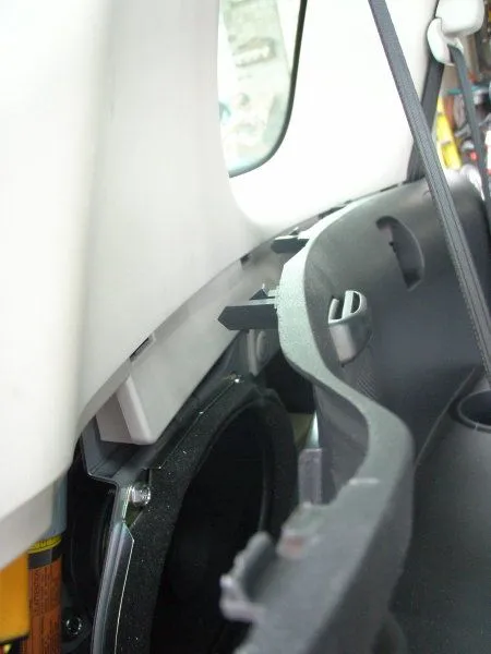

3) Pic #2 Pop open the cover on the cargo tie down and use a 10mm socket to remove the cargo tie down bolt.

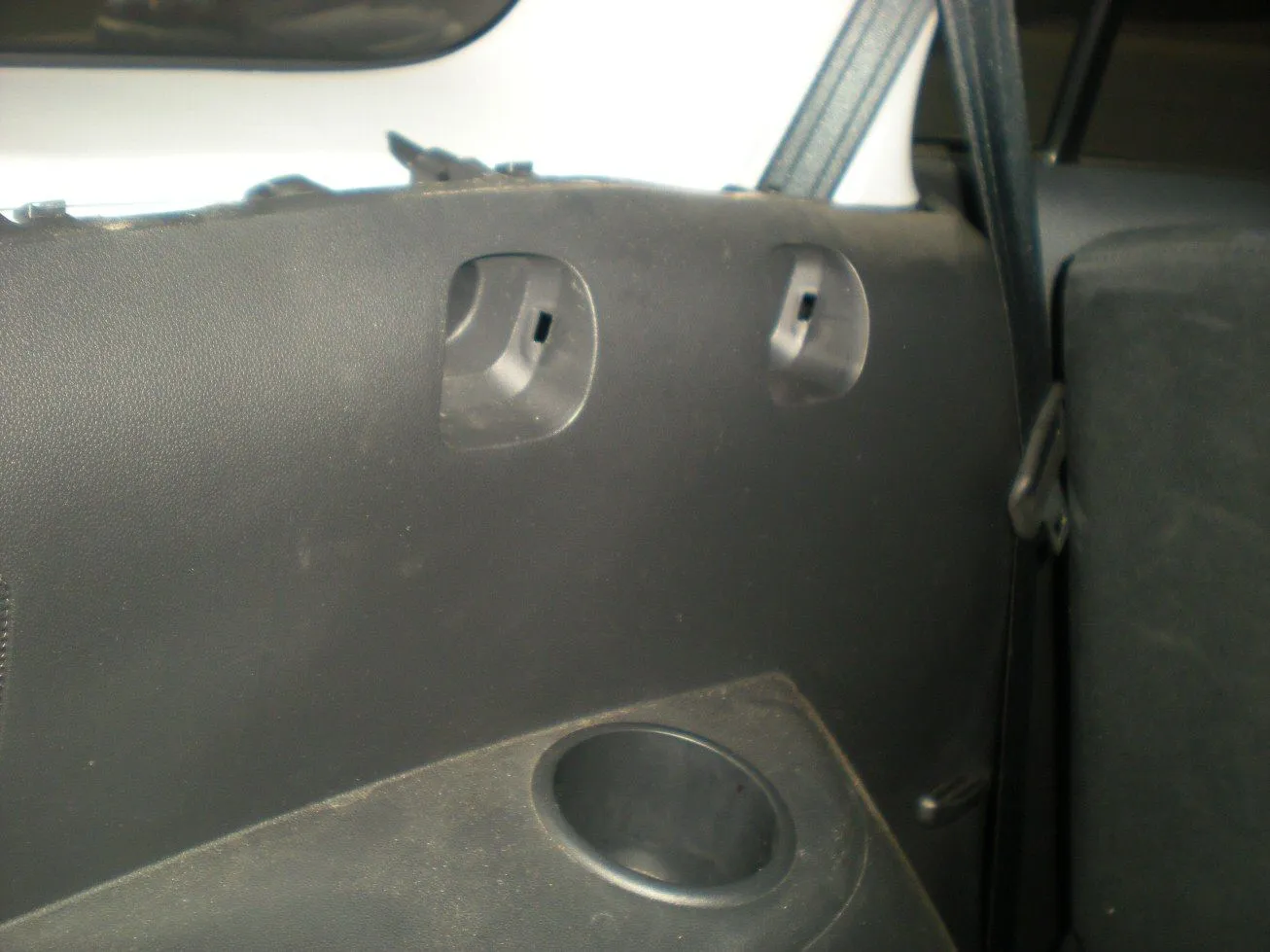

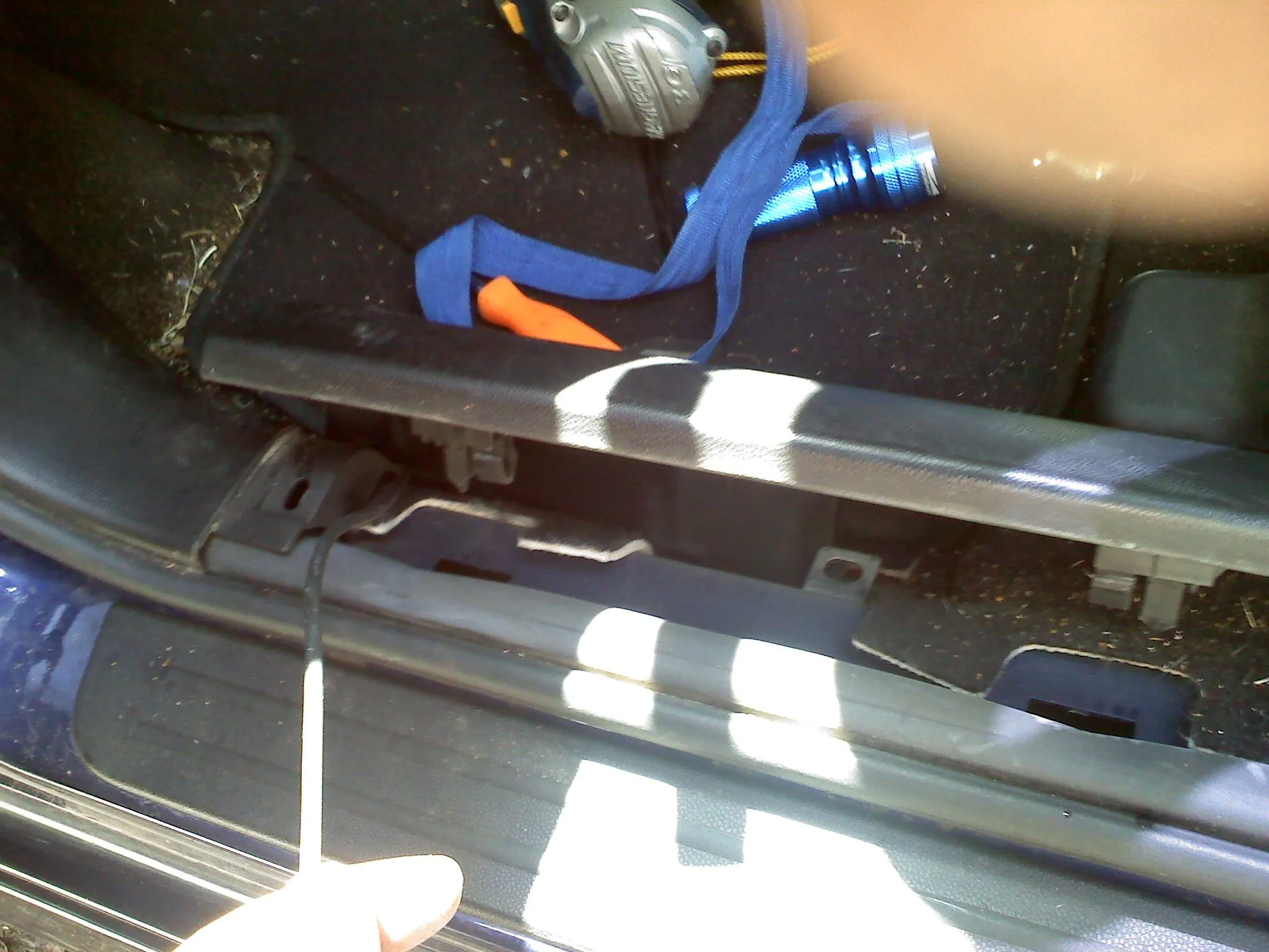

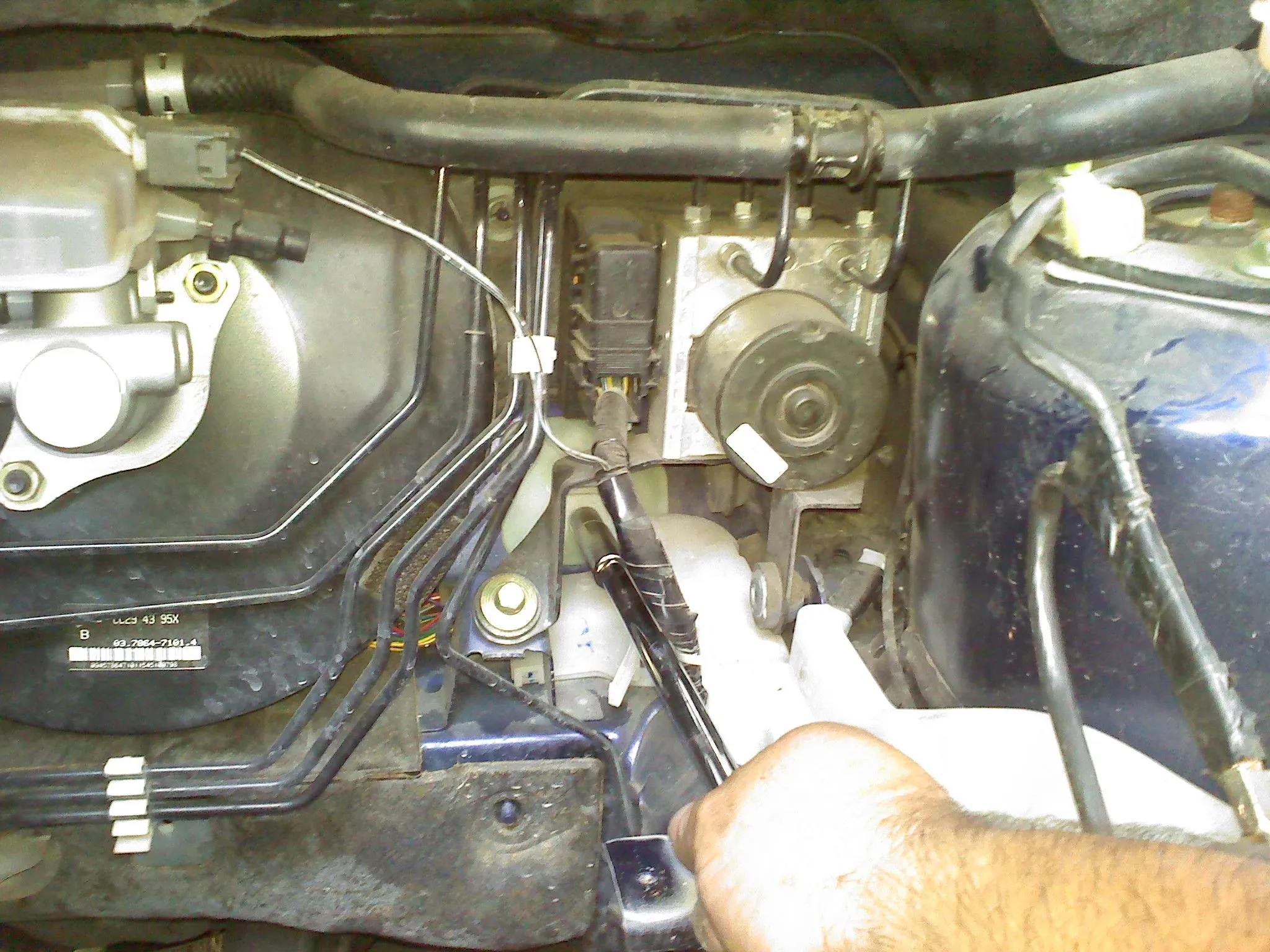

4) Pic #3 Pop off the small cover plate below the 3rd row window, and use a 10mm socket to remove the bolt.

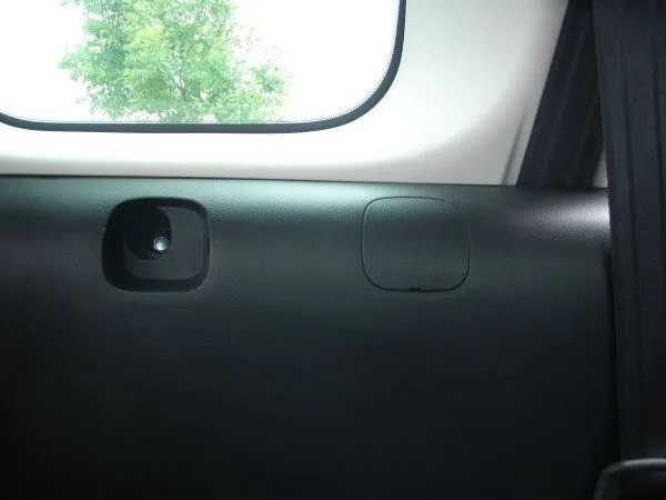

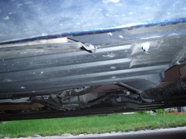

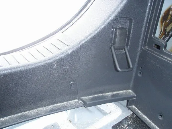

5) Pic #4 Carefully pull the lower panel away from the upper panel. It takes some force, just make sure that you pull on the lower part of the panel to help disengage the clips from the upper panel, you can see the large tangs on the lower panel in the 4th picture. While there is not a lot of room to move the panel, try to pull the bottom out while pulling the top to seperate the panels.

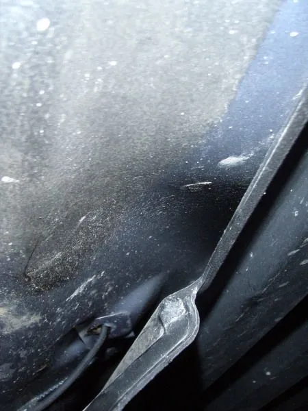

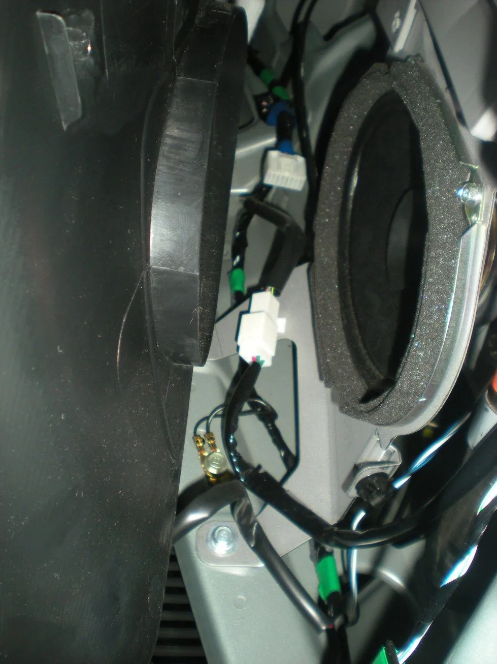

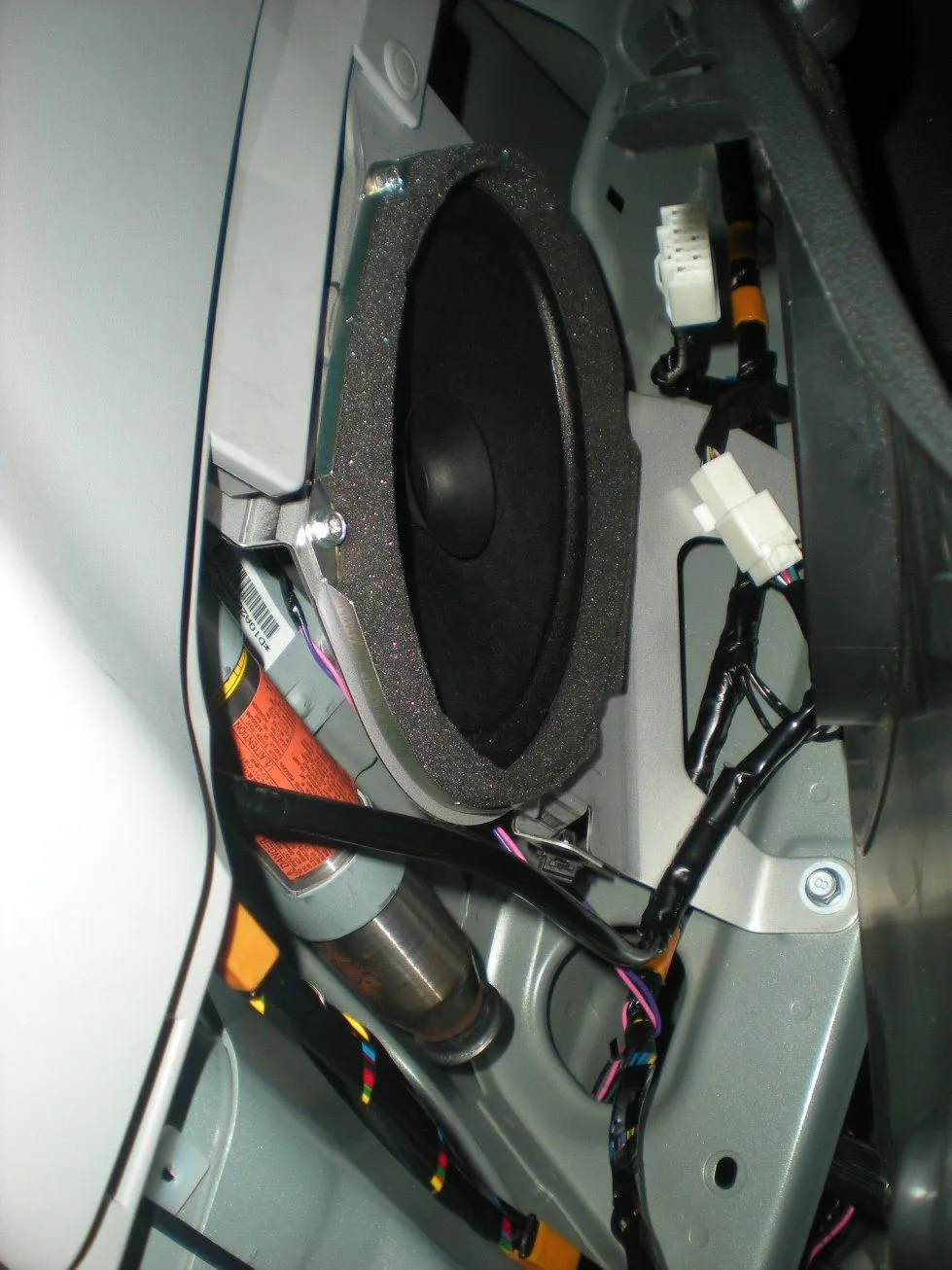

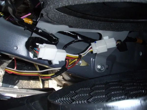

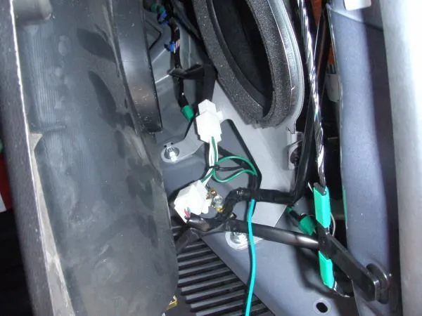

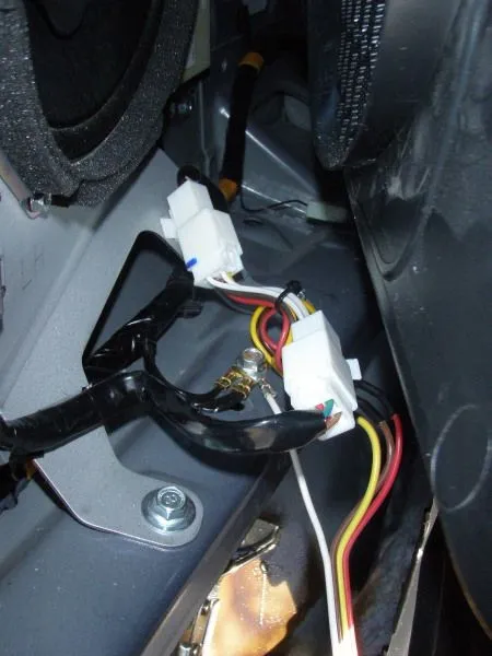

6) Pic #5 Once you have the panel seperated enough you can see the white connector for the tail lights located just below the speaker.

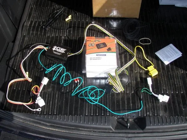

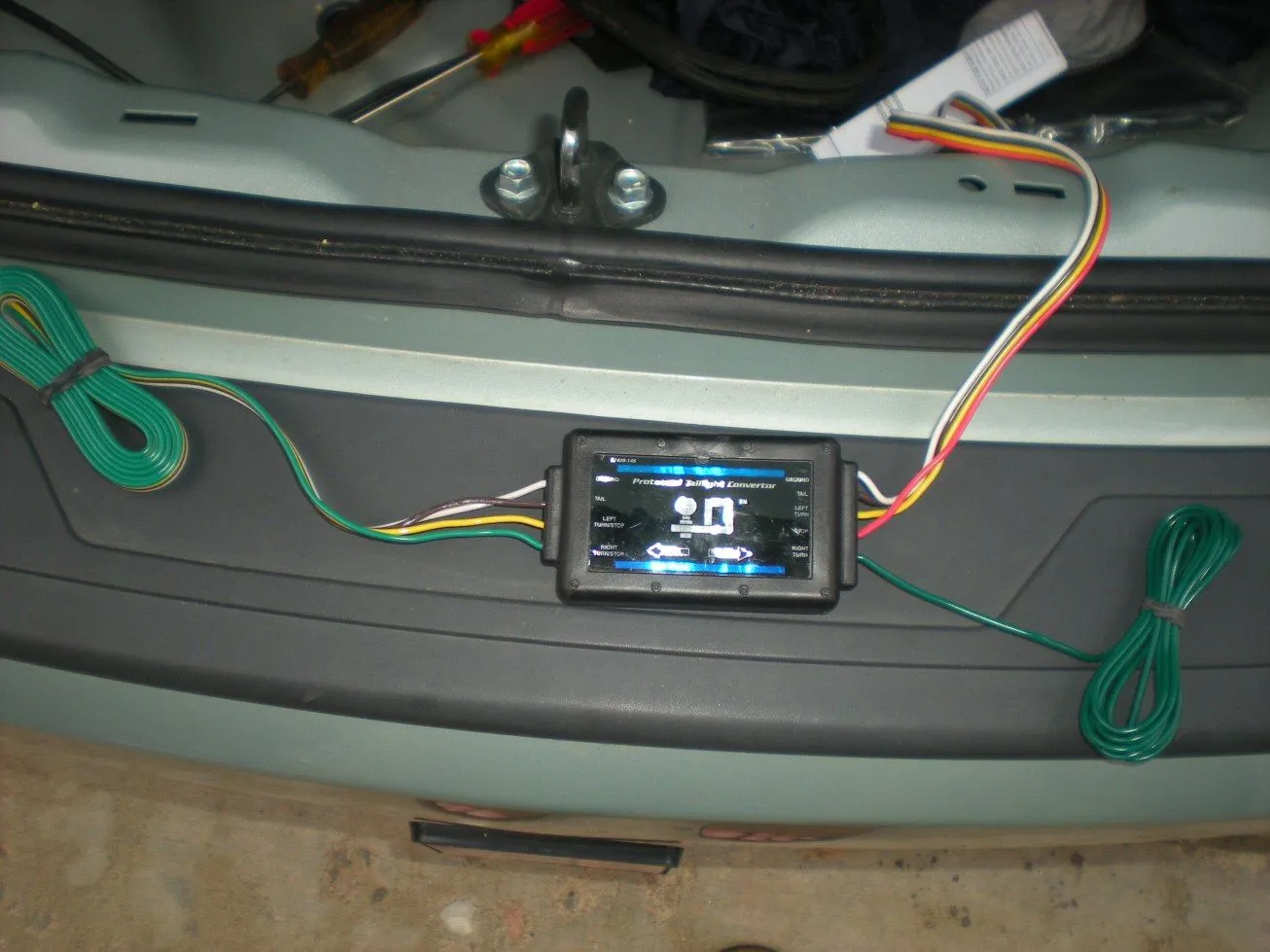

Hmmm. Guess I should post some pics here. I wired in a kit from etrailer.
I had to run the green wire to the right side (passenger) connector.

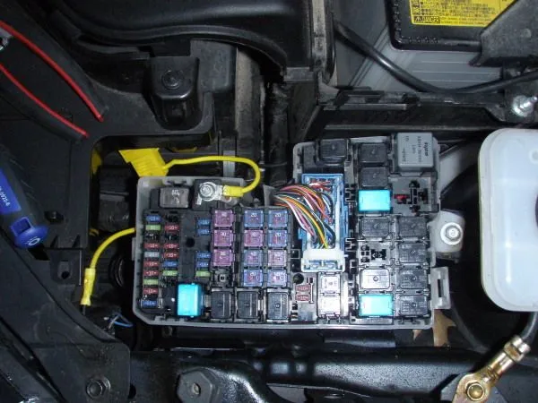

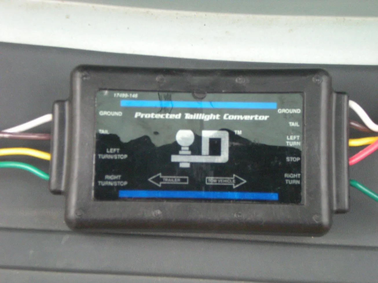

That's great, thanks for the pics. The biggest problem with wiring up lights is finding a place to get from power from. The kit I bought was from CURT and all kits need you to get power to the convertor box so the trailer lights have enough power to light up, and your adding a load to the existing circuit. But I couldnt find a place to get the wire into the rear compartment. There just are not any easy points to bring the wire into the vehicle at the front, or the back. I didn't remove the spare as you did but I now see that there is a large rubber grommet under the spare! Now I know why the trailer harness has the large rubber grommet on it(uhm). Instead I ran the wire from the electrical distribution box, just beside the battery under the car along the drivers side till the rear door. I found a small hole to feed the wire through into the interior. to det the wire you'll have to a make a small hook from a coat hanger or something similiar, feed the wire from under the car through the hole hook it with the coat hanger and pull it up into the interior. I took some pics of this but it a little hard to see. After it inside I ran it under the trim panels to the convertor. Hook everything up and now we have trailer lights.

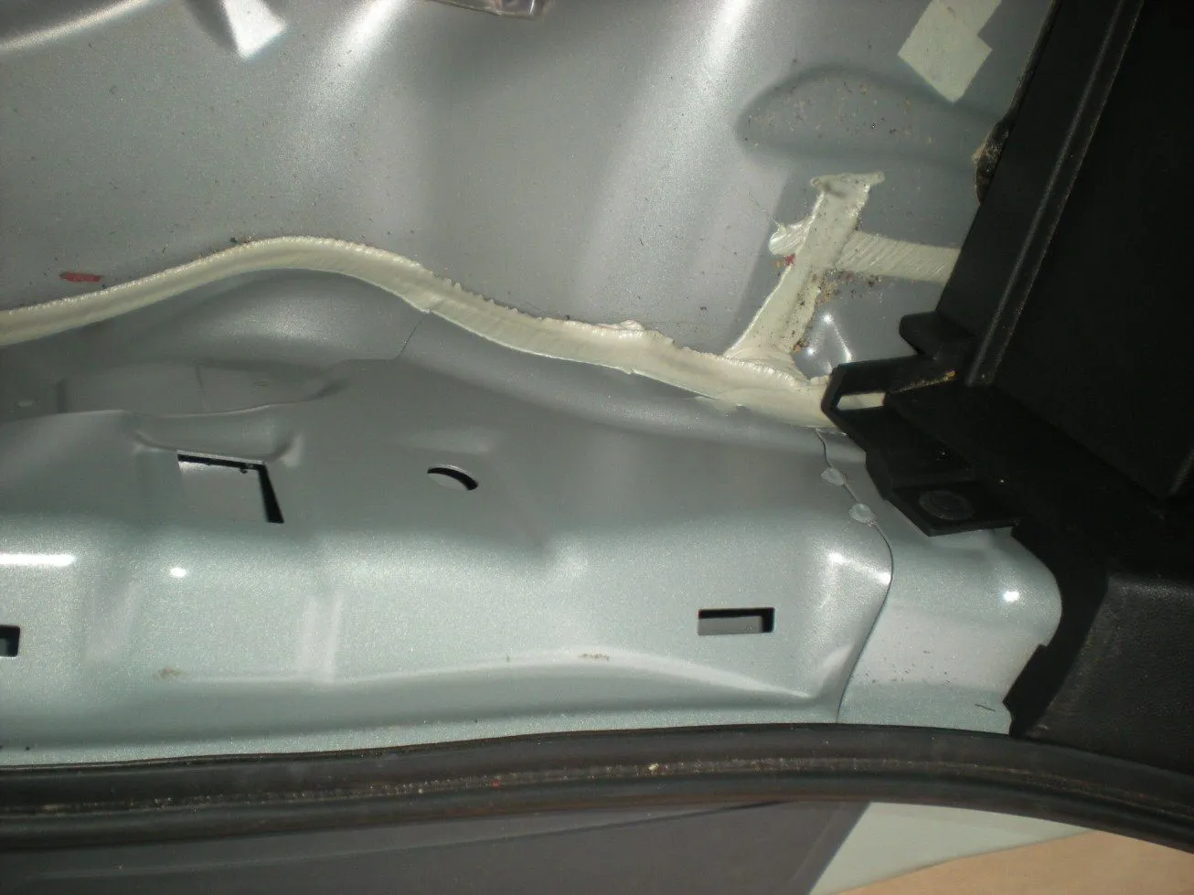

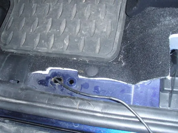

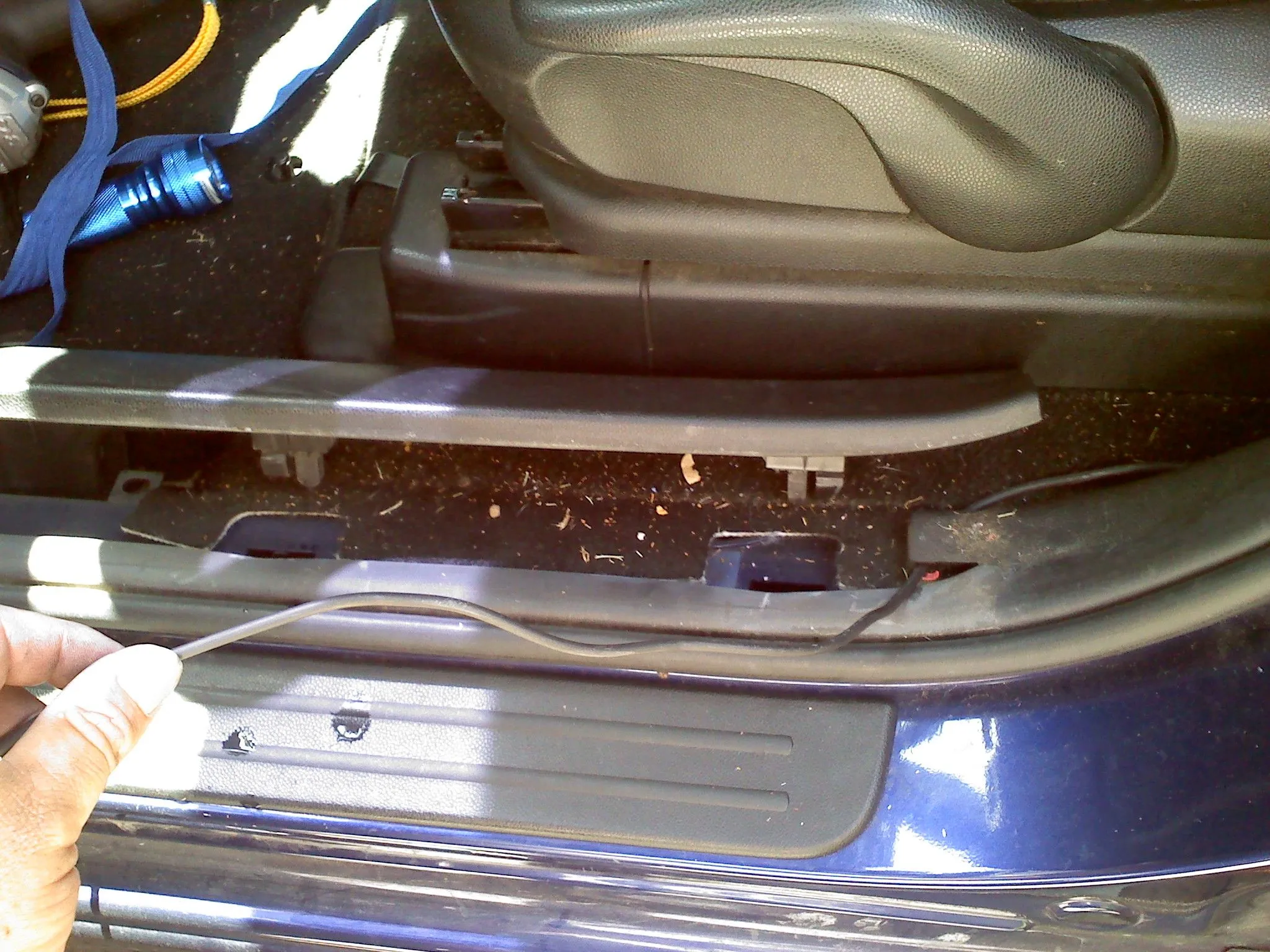

More pic's showing where I brought the wire into interior. There is a small hole under the plastic belly pan just at the front of the rear sliding door. This is where I brought the wire into the vehicle.

Lastly where I hooked up power for the convertor.

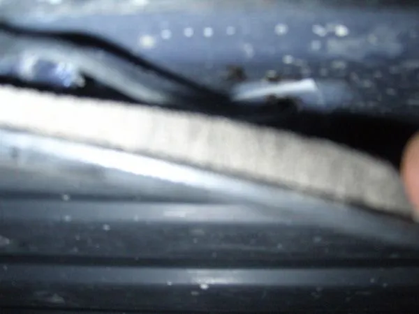

I put my hitch on last week, but the Curt quick connect was not so "connectful" friendly. I wanted to update to all of you that there IS a way to route the HOT wire, That comes with the kit, safely and quickly through the cabin and firewall.
I followed Bennett5's Routing of the cable to the Driver's Side Sliding Door (DSSD) but kept on going from there.
I started tucking the hot wire under the weather stripping at the front of that DSSD.
Even though I don't show it here, I had tucked it under the pillar also (between the DSSD and the Front drivers side door) AND under and up the kick panel, in front of the Drivers Side Front Door.

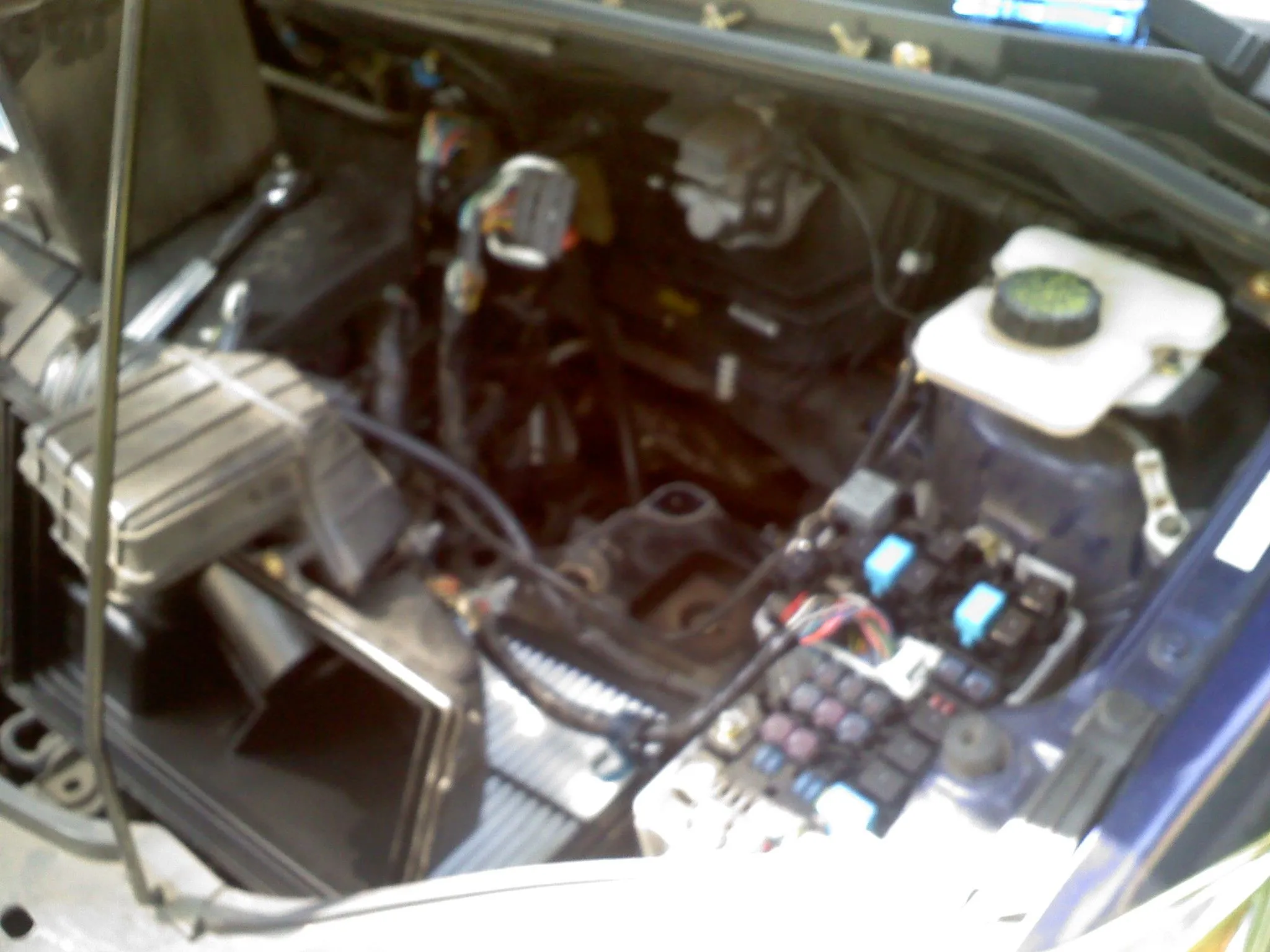

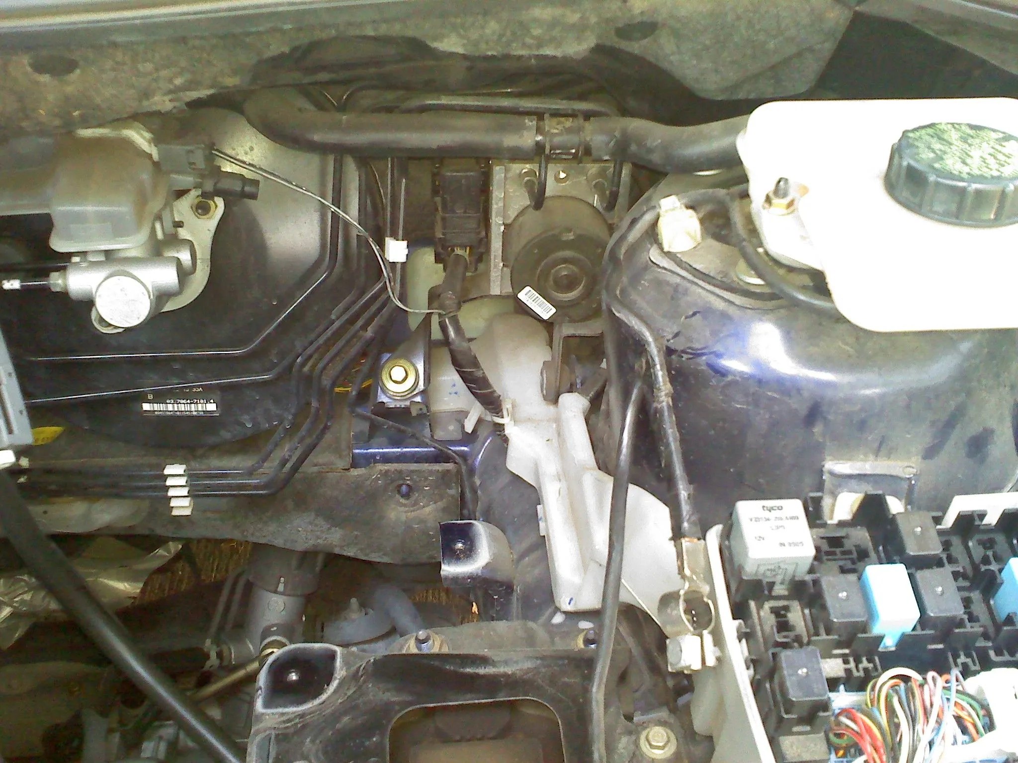

5 Trailer Wiring Up Front

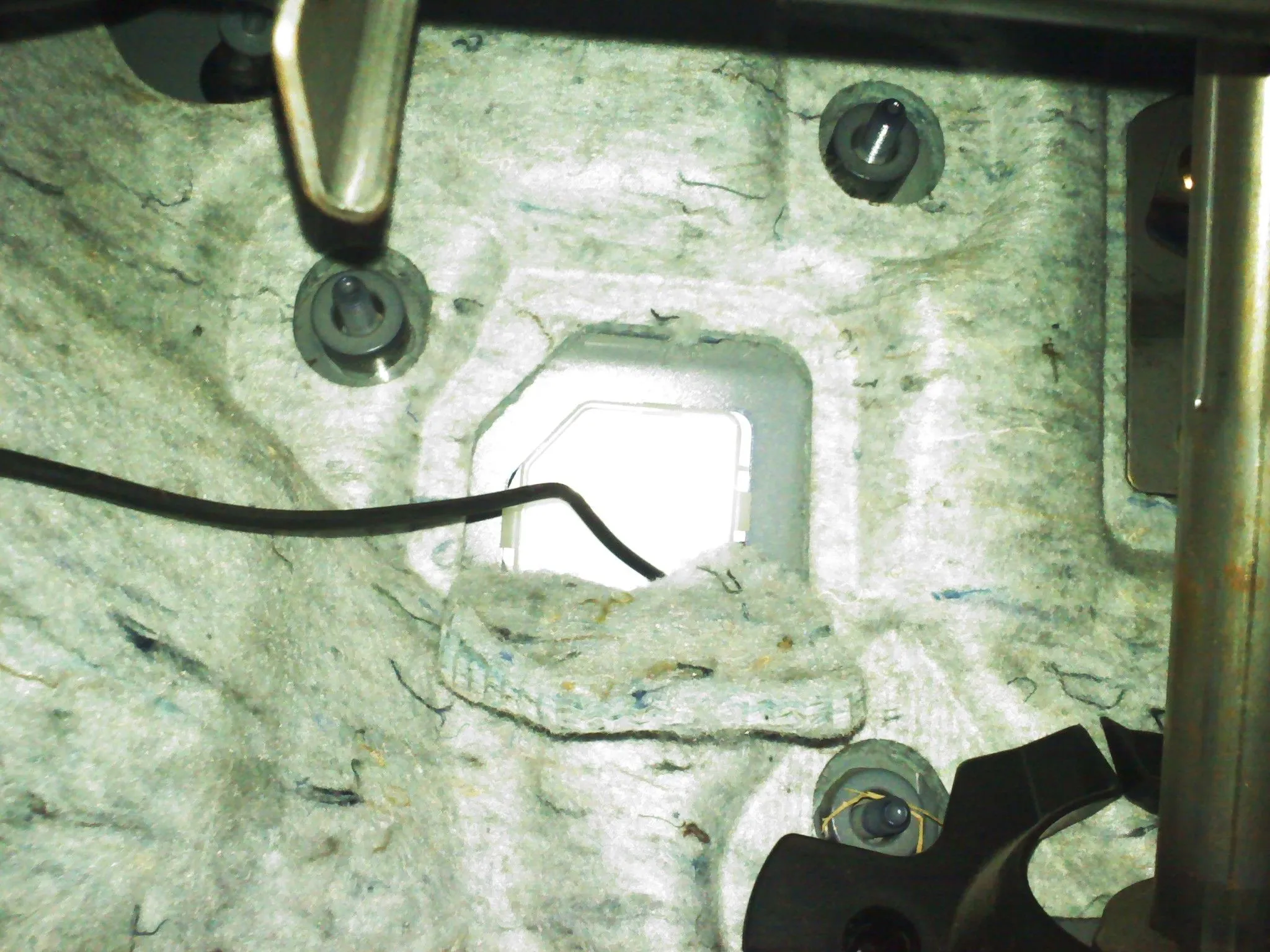

As you come out of the top of that kick panel, you will need to look up under the dash a little. There is a perforated somewhat squared piece of padding up under the dash. You can pull it off at the top and sides and let it hinge on the bottom perforations.
You will see piece of white plastic behind it. You will have enough room to drill a 5/16" inch hole towards the lower center right of this piece of plastic. This plastic is only about 1/8" inch thick, so don't go far. I had a big 18V cordless and was able to drill it with no problem (room wise).
Now the really fun part, but worth it in my opinion. Take the battery and it's case out. If you want more details on that, I can provide them. Here is what it looks like when the battery case is out.
You can see the back of that white plastic piece when the case is removed.
I routed the Hot wire towards the Drivers Side Quarter Panel along the firewall. I didn't show it here, but I put plenty of cable ties to other wire looms and non-metalic items to keep it from vibrating. I brought it forward enough to attach like Bennett5's.
This may seem a bit longer or complicated to some, but it beats exposing the wire to the undercarriage of the car and having a rock or other item tear into the wiring.
Removing the battery case and air filter cover is not as big a deal as it might seem, and makes the process go much faster.
While your there, you can empty any dirt out of the case and make sure your battery is topped off on the water too.(flash)

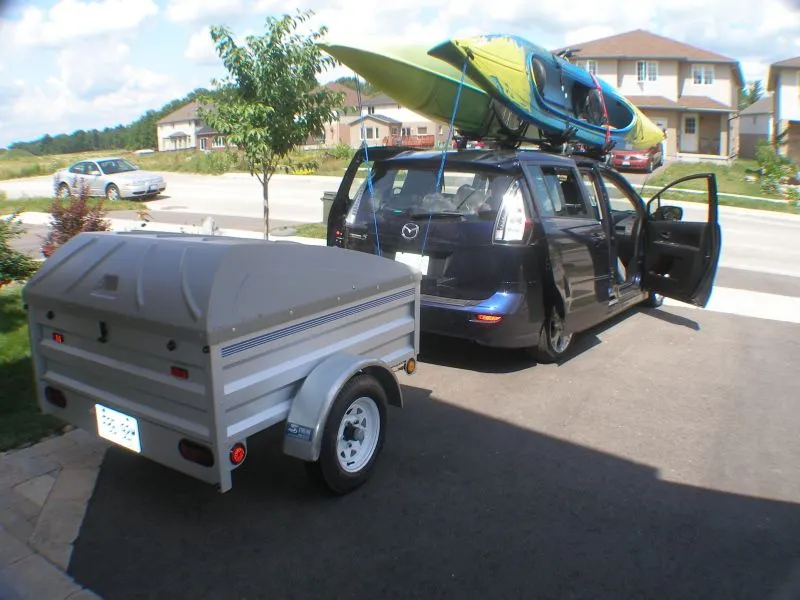

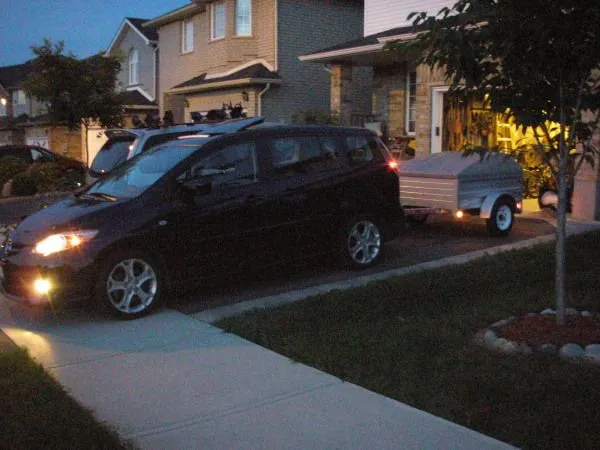

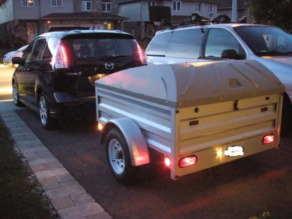

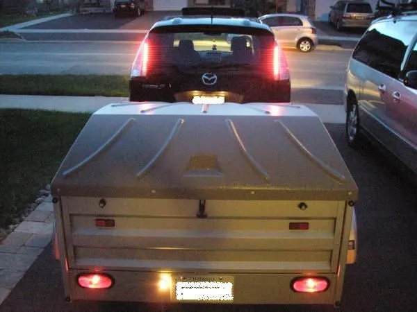

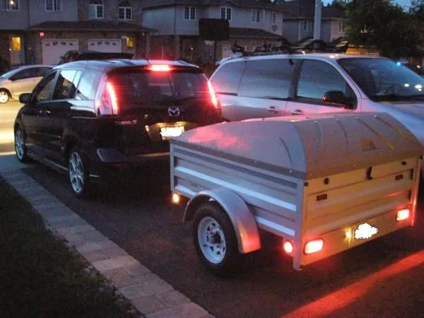

Attached are some Pics of our 5 with our new trailer attached and all lit up.

OK so we just finished a camping trip putting on just under 1000kms going to Algonquin park. The car was well loaded, but could've taken more, but I wanted to be able to see out the back window. As for gas mileage here is what we got on this trip travelling at 90 KPH for 500 Kms and 105 KPH for 500kms: July25 10.4 L/100KM or 22.8 US MPG or 27.3 Imp MPG.
FYI this trip took around 4 1/2hrs one way and is 50/50 for rural hiways and divided hiways.
I've posted my fuel mileage chart for those interested on the fuel mileage thread for whoever wants to look.
On this trip with the car loaded as it was, it definitly struggle up some of the stepper hills, and when I say struggled I mean no more than a regular minivan towing a small fold down camper, but on the open highway no problem other than crosswinds move it around a bit with the kayaks on the roof. You dont want to stay behind an 18 wheeler long as the wind buffeting make its feel like it's going to rip the rack right off the car.
One other note, in the same camp ground there where 3 other 5's. 1 with 2 kayaks on the roof, one just loaded with tents, and a third towing a fold down camper. There were also 2 more on the higway towing fold down campers and none where haveing any trouble keeping up.
