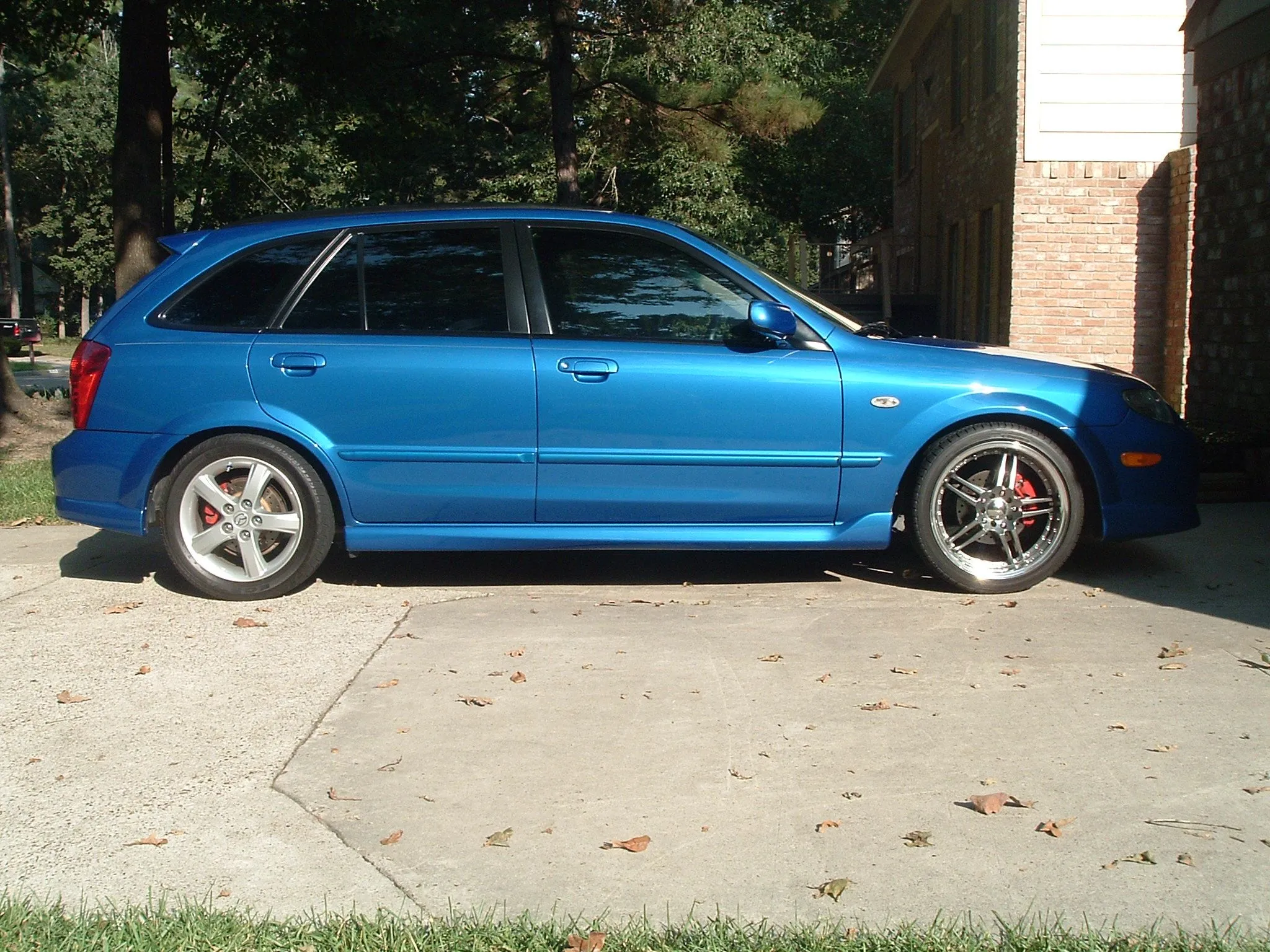

This thread is confusing me. A wider tire rides better and looks better than a taller tire?? 40s ride like 40s, and I too think they are a bit too short. 45 is a good trade off, but for battling the Houston roadways I think I'll stick with my stock wheels and 50s. Take a pothole at about 45 mph with some 40s and see what happens. I hated having to worry about bending rims when I had my 17s with 40s on.
Anyway, I may have to strip the rubber and sell them because they are basically brand new Yokohama Avid tires. Tons of tread left.
Comparison of stock setup vs. 205/40/17 iKON GT5 wheels.
