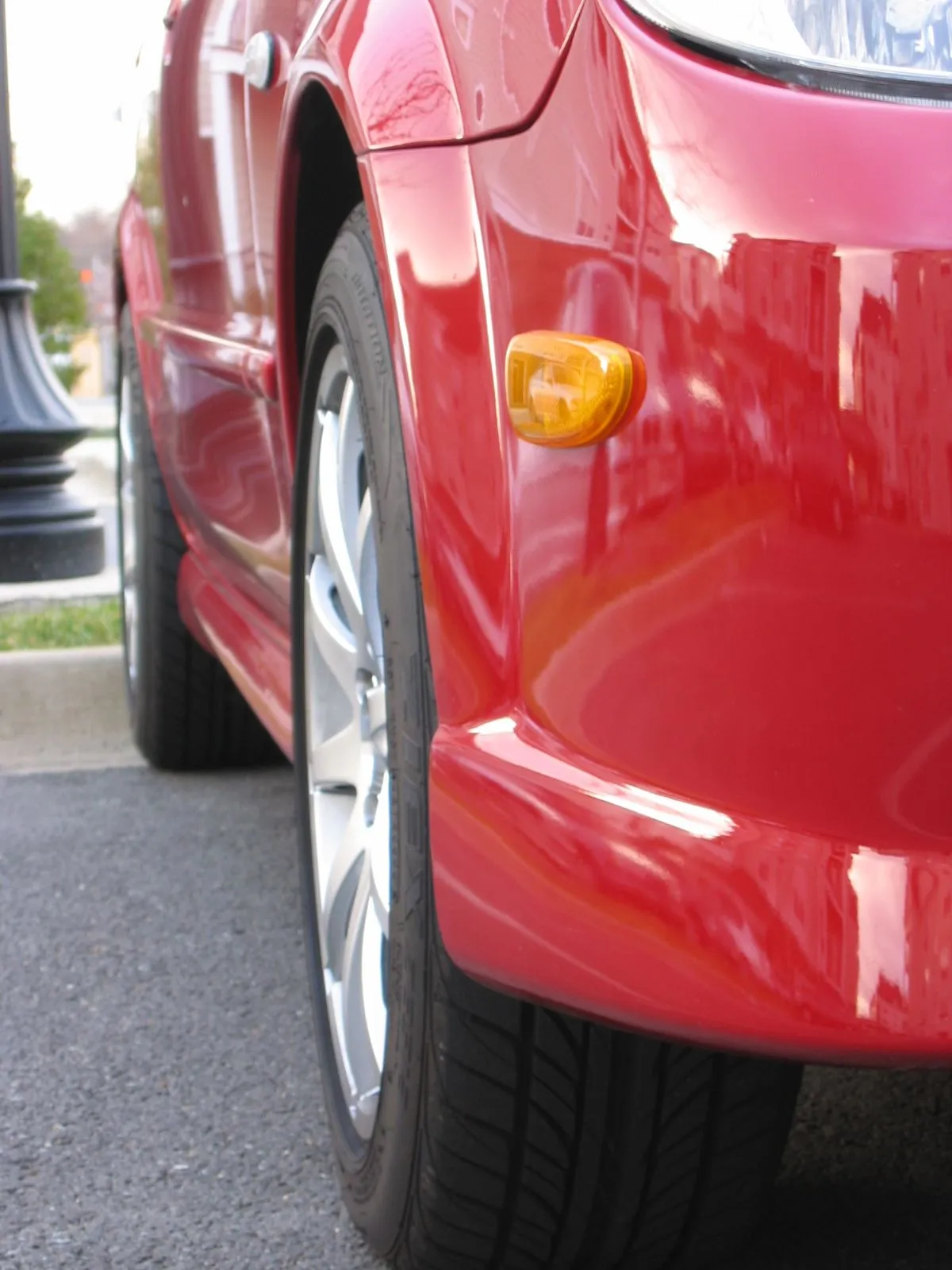

My practice is to park next to curbs, as close to them as possible to put distance between me and the next car's wide-swinging, dent-making doors.
Consequently I rub curbs from time to time but my 512s take it--my rims are perfect. Tried them in snow last night and they were, well, decent. Great in rain and very good in dry, considering they're A/S.
On the downside, the sidewall isn't vertical so they don't look as cool as other tires, but maybe it's worth the sacrifice.
Josh are those 205 or 215? 215 I'm guessing, because well my 205s look a little silly, even though theoretically it's a proper tire size for a 7inch wide wheel.
