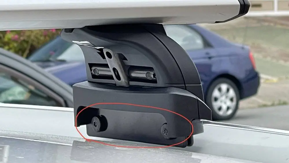

@skidrofuzzy Hey there I am also curious if the 3160 fit kit can easily be loosened form the factory side rails if ANYONE also has the same Torx / Allen wrench (6 point star pattern)! This Torx / Allen wrench came with the fit kit and I assume all these fit kits comes with same Torx / Allen Wrench?
