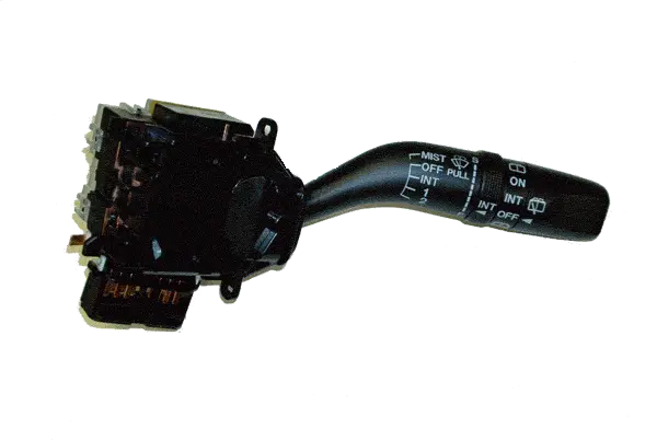

Swap was really easy; the hardest part was getting the steering column shroud off the MPV. Three Phillips screws on the underside of the column. The 2 that are closest to the wheel itself are gold'ish colored with vicious thread and the one further down is black and looks more like a machine screw thread. A standard #2 Phillips will work on all three of them. Once you get the sleeve off, you'll notice two smaller Phillips screws on top and bottom of wiper stalk and a white Molex type plug at bottom. Unplug the plug first, then unscrew. It is off. Get the new stalk installed and reverse the order. One suggestion I would have is to snap the column shroud back together before trying to get the screws back on. It makes it easier. The entire process of swapping them took 20 minutes? Wait for a warm sunny day maybe because if the plastic is cold you are more likely to snap the retaining clips on the shroud. Works very well. Yes, my wife called me the rainy morning after I tried this to explain to me that something was 'different' about her wipers...

well, I can get pictures when I get the new one and swap her out. tzh, yes everything is on the wiper stalk itself, no other parts are needed to swap out. It's pretty cool modification and if you need a reason to do this just ask my lovely wife.

the wiper control stalk/switch/control arm/whatever you want to call it on the late model Mazda MPV's has a rotating dial on the stalk itself that allows you to control how frequently the wiper blades go. It's called variable adjust intermittent wiper control. The ones that come from the factory on my PR5 was either too fast or too slow and this allows you to adjust to your liking. I saw somewhere online the switch new cost like $50-60? I will keep looking at salvage yards unless my wife pushes the swap.

that is the part you swaped right?
