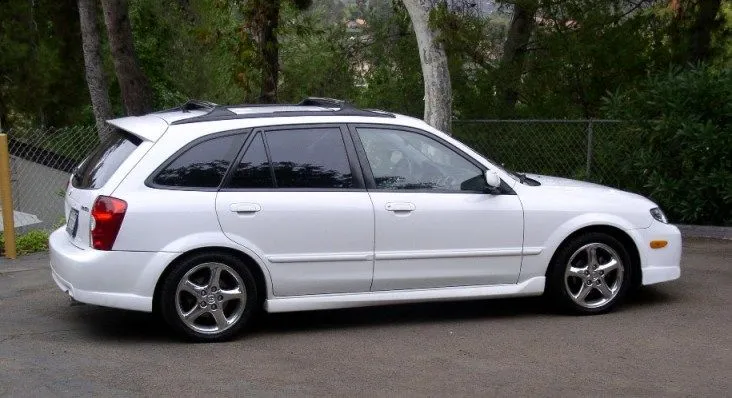

that has mp3 springs on it, and i was wondering what would look different if I put MSP ones instead of MP3 on my p5
It'll look like this--MSP springs on stock struts:
ok. it only looks like it is 1/2 in lower in the rear, but in reality the car is the same height just the rear well is smaller. :-\
