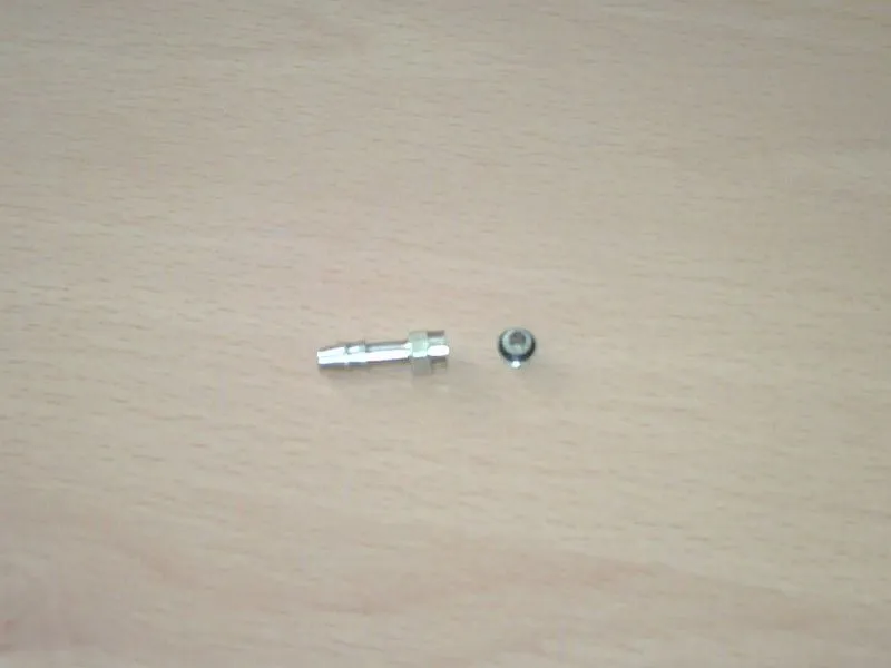

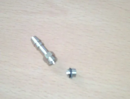

So I set out to tighten port "C" a little (being mindful that force wouldn't be needed), until it stopped. Well the barb broke off! Luckily, I have an EZ-Out kit, and was able to back it out by hand! I am trying to find out what sized barb I need for that port now.

Talked to Synapse, and the replacement part will be on the way. The threading for the barb is:
10-32
or in Metric:
M5x0.7
In the meantime, I'm going to need to plug up my boost-only line.
