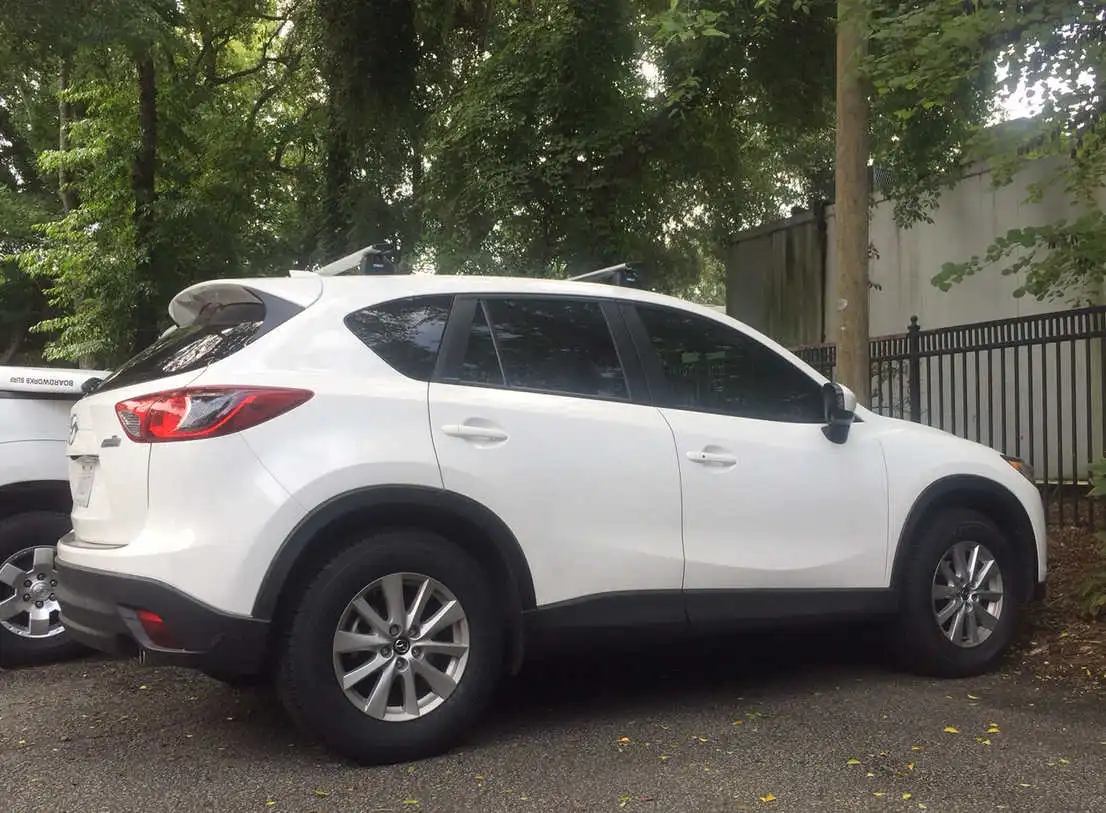

Update: Went with 235/70/17 and they look much better IMO and fill out the wheel well a little better. Also, zero rub even on the tightest turn - very happy!!

I'll get some pics up once the sun comes out.

attachment.php
I like it, it's filthy, as we've had a lot of rain and cutting down trees, but gives you the overall idea, but still looks better when clean

attachment.php
Wow! That extra height certainly is more noticeable than I expected. Looks like you are ready to hit the Rubicon Trail!
I like the look. Thank you very much for taking the time to post the pictures.
