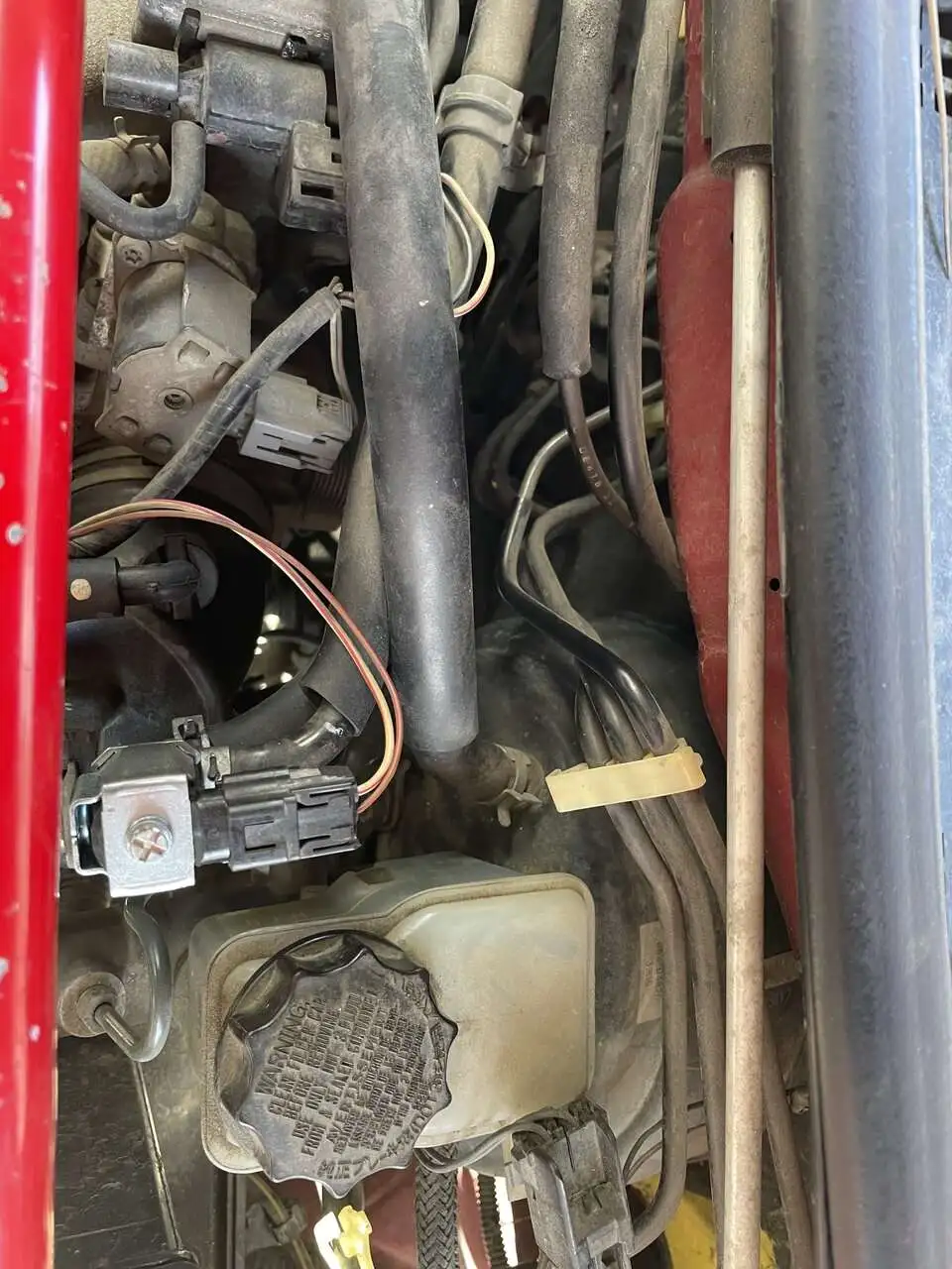

I have a P5 that l love and want to start restoring it but first need to address a few issues that are high priority.
I had an emergency brake issue for almost 4 years, when l pull lever it after parking it works but overnight brake gets loose. I was told some hose was losing vacuum but locate the part with issue.
And recently, my pedal brakes get stiff overnight but loosen up after l start the car. I researched and found out check valve might be issue. However, l cant locate this check valve for some reason…
Any help is appreciated. I attached a photo of brake booster.

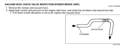

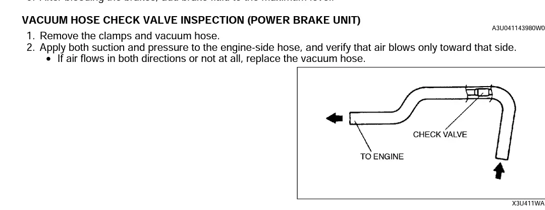

The check valve is inside the vacuum hose going from the booster to the engine.
Remove hose. Blow into the hose from the booster side. You should be able to blow only in this direction. If you blow from the engine side towards the booster and can blow air, the valve is bad. Vacuum should only go from the booster, not back into it.
