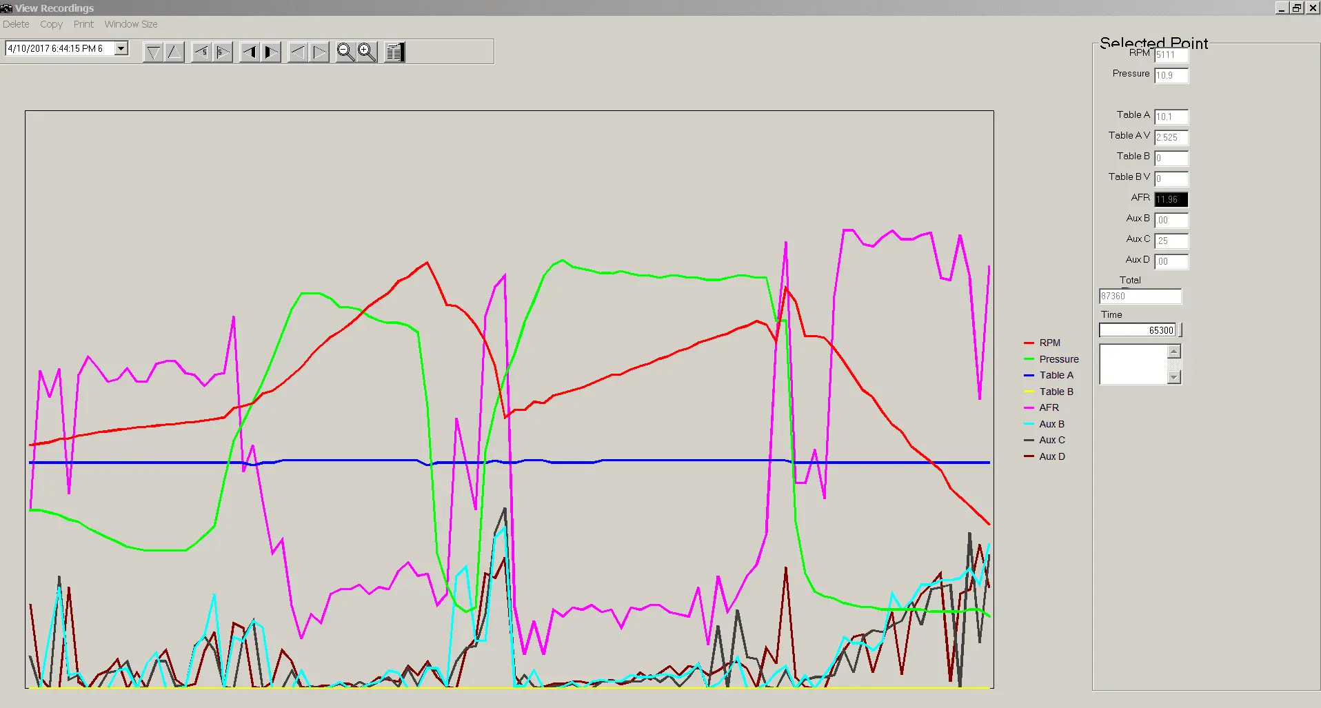

I recently installed the SS AFC with datalogging and I have had a huge problem with it running lean. No matter what map I use it runs way to lean. AFRs on boost start at 11.5 and creep to 15 before I either pull back or it cuts. I am running stock boost pressure. relocated MAF, FMIC, forged internals, stock downpipe and j pipe but with a 3in true straight pipe (pope DP coming soon) Its like the afc is having the opposite affect that I need. Any info will be great. And I might need to play with the settings a little but its almost as if the afc has made everything worse. But for now I have only downloaded maps from the library.

Okay for some reason it changed to 6 cylinder. I have everything else exactly the way you said to put it. I am fighting fuel cut issues right now at about 10psi. My afr's are good. They creep to the high 11s in the top end but I shift if it hits 12. (12.2 is the max safe limit if my memory is correct) But now I realized that when I bought this car it had a regular protege engine in it with custom oil and water lines. I am now questioning what injectors I am running. My map has values mostly higher than 10 but it is working well I guess. You can see the cut on the 2nd peak. The afr value shown is what it was right before cutting out.

If the injectors are purple and green they are the stock 280cc injectors. If they are blue they are likely 440cc WRX injectors.
My MSPs tend to hit fuel cut at about 14psi, in cooler weather it's around 12. I'm not certain but I believe you can use the AFC like a voltage clamp to keep the MAF from hitting 5v and cutting ignition.
They are purple and green. Mazdaspeed and reg protege injectors are the same size? And how do I stop it from hitting 5v?
