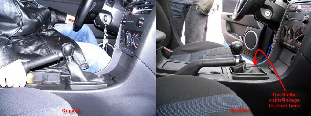

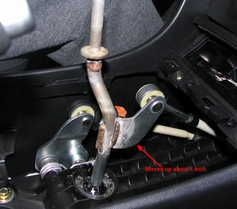

I Modified the opposite end of the shifter linkage...
While I was modifying mine, I thought about doing it the way you did, but I figured my way would be easier :)
Yours is ultimately better though. By moving the linkage on the shifter itself, it does touch the shifter boot. Not enough to cause concern for me..
Either way.... great write up...
Oh, and mine is a just 3 sport... not a speed3 :(
Thanks for the compliment. I read your post carefully before starting mine, thinking I might do something similar. It looks like a good job. On the speed3, the cable attachment on the shifter is already higher than the one on the 3 sport so raising it much at all is not really an option. It is already pretty close to the bend in the stick and the boot. You can easily feel the cable through the boot. There are also some additional pieces having to do with the reverse lockout mechanism that makes this kind of mod difficult.
