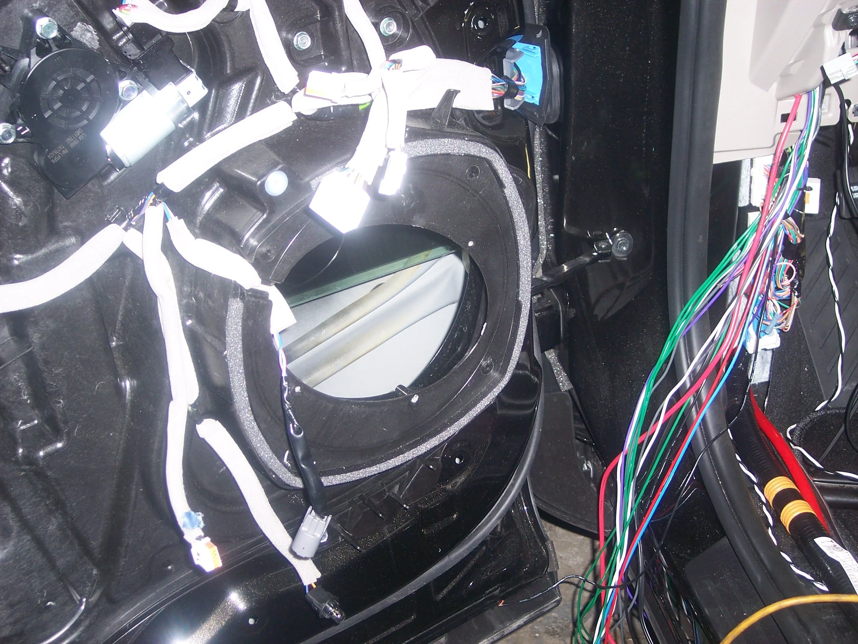

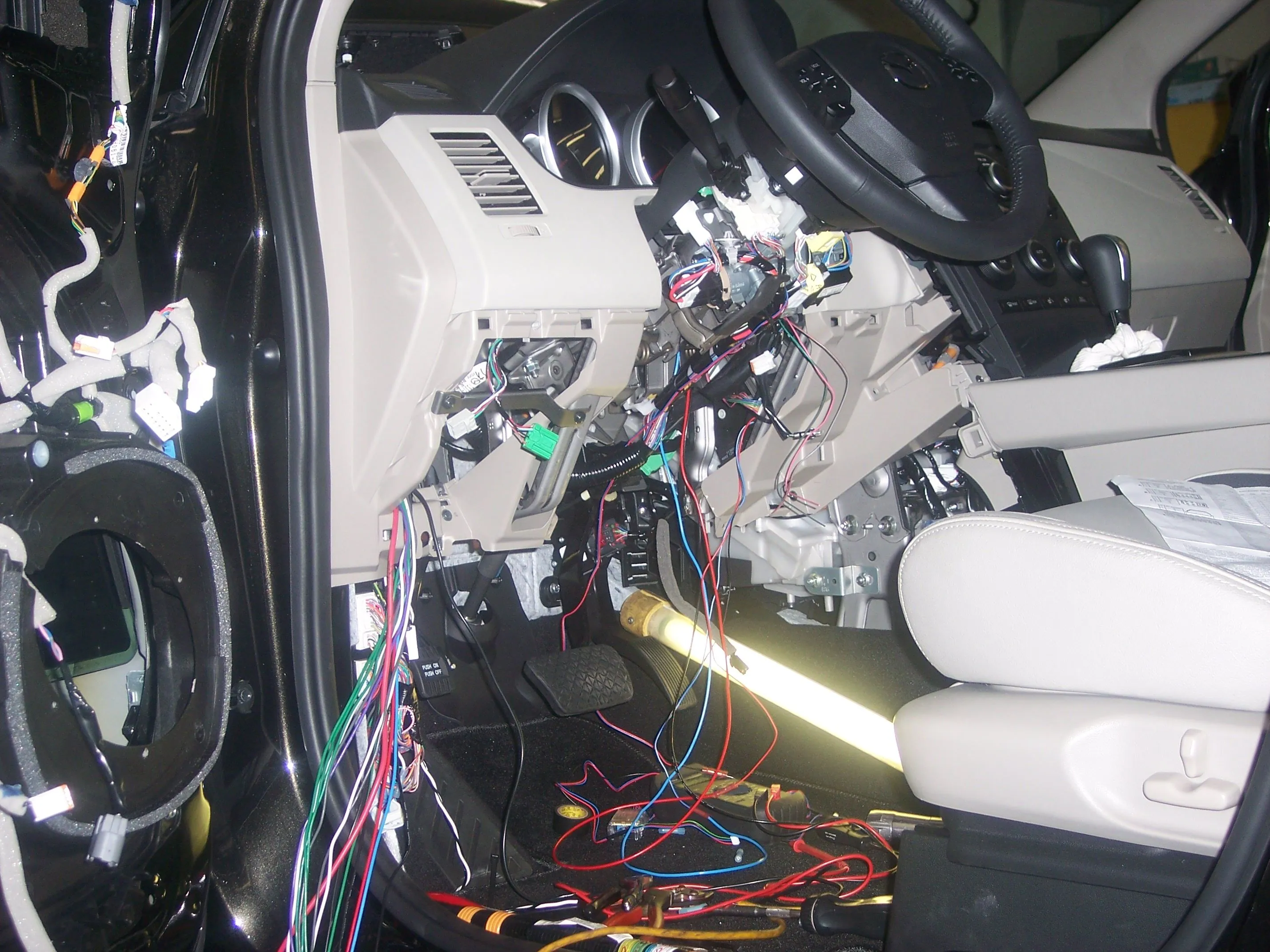

actually I had to go look, Mine is a touring. I knew I didnt have a gt for a few reasons... #1 was I hated the chrome door handles and wood grain trim, #2 was They were already going to have a hard time with install of music and alar cause Back then (Feb of 07) They had no wiring diagram for electrical and took a week just to do my alarm! LOL look at this pic...

thanks for the pictures, cx92envy, did you put in a after market alarm? so you have to carry 2 remotes now? i hate they make the door panel in 1 piece, i will wait until i get my led turn signal mirror, so i don't have to open it again. the dealer told me the factory keyless has an ic chip, without it i can't start the car, but last time i change the battery on the remote, i don't see any chip on the key side, unless it's very small, but i started the car with just the keyside remote was inside the house.
I do have a second remote for my alarm. They had to hide a key in my dash for it to work. I believe that was for the remote start tho. I actually just had a second key made and I start it with remote start and reg key works fine.
Besides I am sure they have other ways around this now. It is just when I did it there was no info on it.
