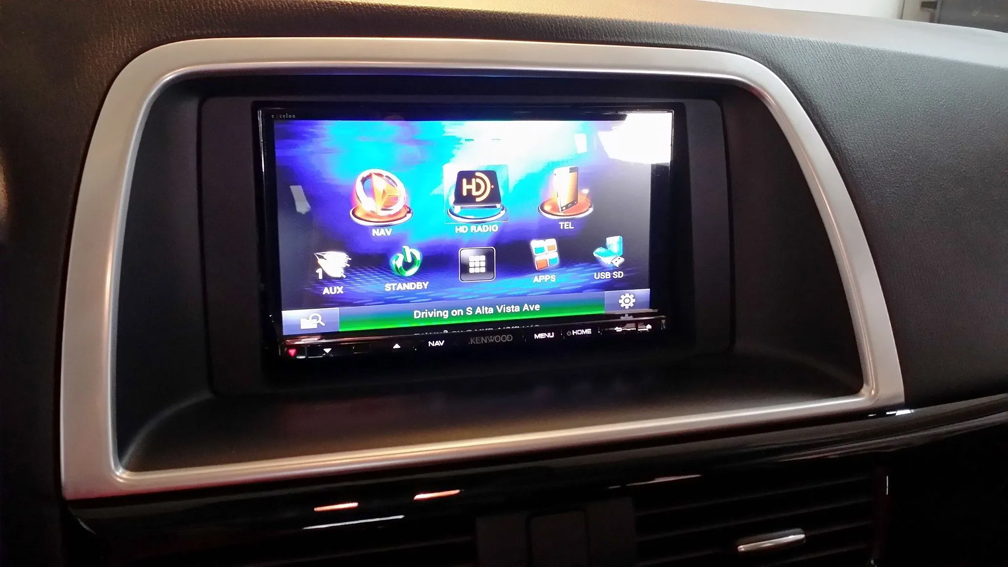

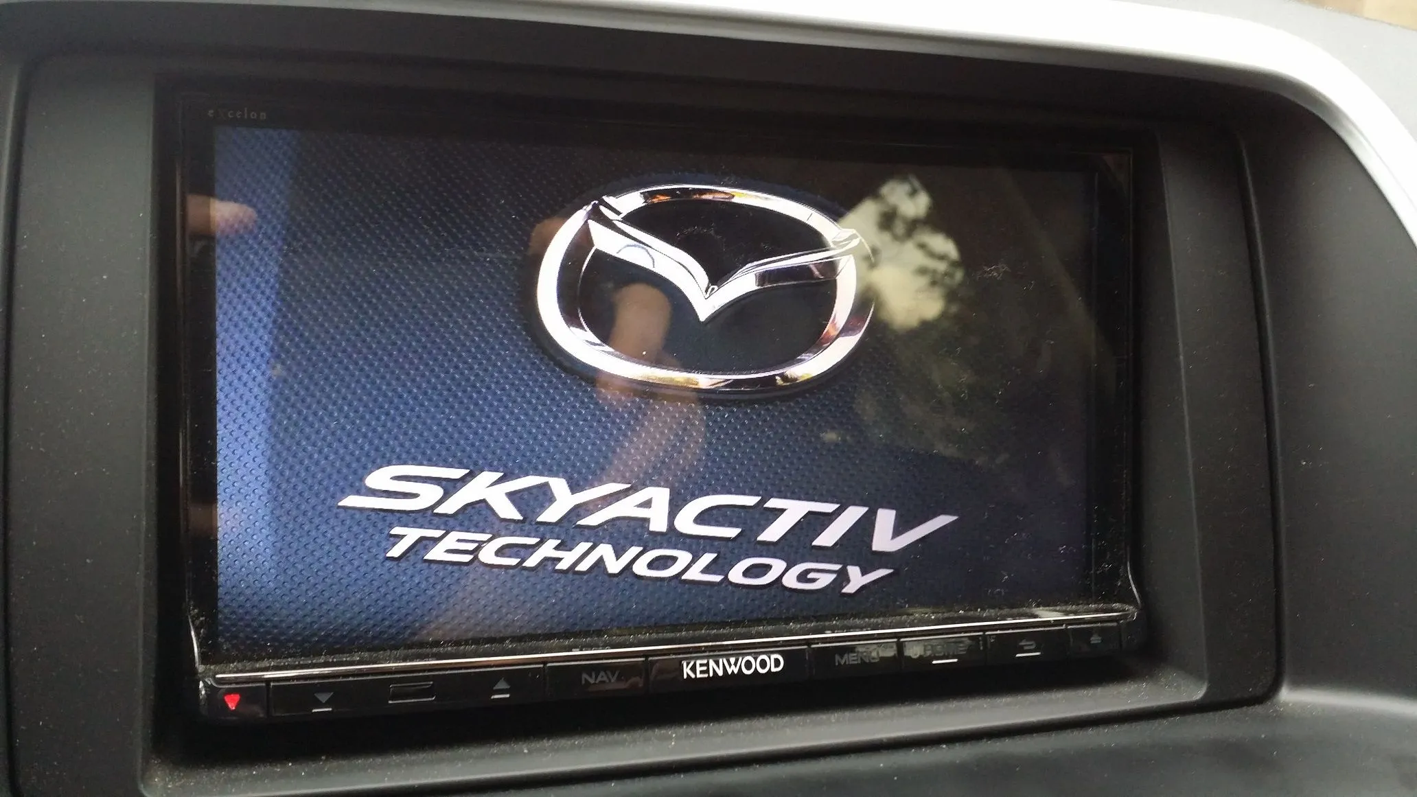

tibimikai. Do you have any pics of your install? I'm looking at a Kenwood DDX9703S and JL Audio speakers. What trim plate did you go with for the deck?
To tell you the truth, I forgot what kind of install kit I have used, it's been a couple of years already.
attachment.php
attachment.php
Since the first picture, I have replaced that silver trim with one, that does not have that bottom silver part, only the other three sides.
VERY Nice! Thanks for sharing! it's giving me inspiration to keep hunting for a DDX9903 for my CX5. :)

Since then, I have replaced that silver trim, with one that does not have the bottom horizontal part, but to tell you the truth, it doesn't stick to well at the top corners.
My DNN (android based) is pretty slow to start. Not sure how is that DDX unit.
