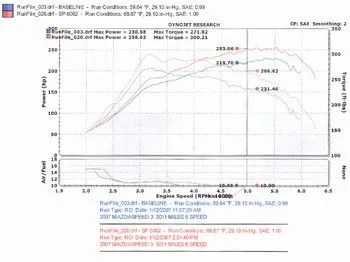

The best CAI on the market for our cars at the moment without a doubt is the Mazdaspeed and INJEN who probably is the OEM CAI manufacturer for the speed3&6`s anyway.However INJEN is the only fully Dyno,proven and specifically engineered for the SPeed3`s with taking into concideration pipe size,MAF.Injen is also the newest of them all.
The Injen Technology intake system is a high-performance, dyno-proven system made of CNC mandrel bent 6061 T-6 aluminum alloy. Each intake is carefully engineered for a perfect fit and superior performance. Many other intakes on the market are made of only 3.00" diameter tubes. This may cause friction between the battery and the intake system, dented hoods, or an unbalanced air fuel ratio, which can be harmful to your engine. Injen Technology has taken extra measures to ensure that consumers get exactly what they paid for: Optimum throttle response. Injen Technologies has in-house capabilities for bending 2.25", 2.50", 2.75", and 3.00" diameter tubes on various bend radii.
The SP series from Injen also incorporates MR Technology, an Injen exclusive that stabilizes the vehicle's air-fuel ratio and tunes the intake to be within safe factory limits of performance. Injen tests and tunes every intake for optimal performance. With MR Technology, they take the tuning stage one step further. Typically, vehicles that require MAF sensors have had to simply bolt their MAF sensor onto the aftermarket intake housing. This made for a simple installation, but it changed the diameter of piping where air flowed past the sensor, changing the characteristics of the air-to-fuel ratio the MAF expected to see. This could lead to unstable or lean air/fuel mixtures which can damage high-horsepower or high-performance engines. Injen has carefully tested and tuned their intakes with MR Technology to offer the most stable balance between horsepower and safe operating parameters by changing the diameter of the sensor piping where necessary.
Injen polishes or powder coats every intake for those who are conscious of aesthetics along with horsepower gain. With the use of 1/4" thick 6061 T-6 aluminum and precise CNC machined brackets and adapters, you are guaranteed an exact fit every time. Every Injen air filter is made from highly resistant urethane rubber and comes with a unique built-in velocity stack to smooth the incoming air. A four-ply cotton gauze element filters out harmful particles. Not only does Injen dedicate themselves to making precisely crafted intakes, they also back it with a limited lifetime warranty to ensure a quality intake for years to come.

I've always wondered why the dynos showed so much more of a gain for the injen...

No No don`t get me wrong don`t get the Mazdaspeed just because of the name.Probably,the gains are no way 30hp but ,you should never give an hp number with CAI`s anyways,but percentages and any CAI can never give more than 5-6% on a FI engine and 1-3% on a NA engine,thats a fact.However the Mazdaspeed i`m sure is either made by Injen or AEM i will look into it.Just like Porche Calipers as an example are made by Brembo so are most of the Super car breaks etc.As you said most manufacturers talk out of they rear ends just to sell the products,real life numbers are no where near them.
The gain on a Mazda CAI would be no better than INJEN if not less,but its a ripp off because you pay for the name and maybe looks.(yes)

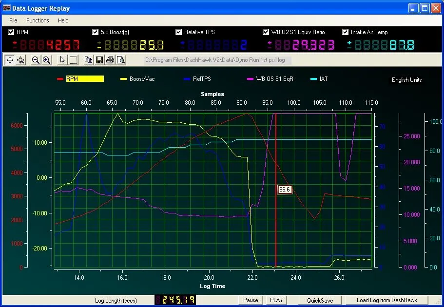

If you look at that dyno chart you can see from the RPM axis that he rev'd it up and then let off the throttle at around 3500 rpm and then stepped on it again at 2800 rpm. Whenever you let off the throttle and let the engine coast, the AFR's go super high since very little fuel is being burned. But remember there is NO load on the engine.
This is a log from my dyno run. Look at my AFR (WB OS 1B EqR, purple line) when he let off the throttle at the end of the run. My AFR shoots up to 29!!! That happens all the time when I'm driving. Under partial load/throttle it should be around 14.6-14.7, and only under load should the AFR's go down as the ECU throws more fuel in.
So there is really nothing "wrong" with that dyno run or his car. They just shouldn't have rev'd it up first and let off the throttle. His O2 sensor can't react instanteously so it took a little while after he went WOT for the numbers to come down. No biggie ;)
