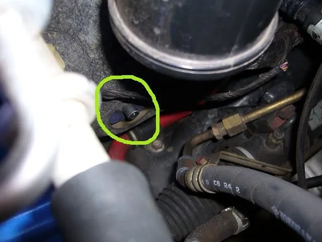

i had the same problem with the water getting......was cleanin under the hood one day and found the problem...wouldn't tell by lookin at it...but when i put water to it it was noticeable......i can get pics of where i found the problem if needed
its on the firewall underneath the a/c lines that go to the evaporator
