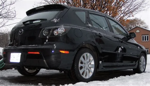

I put 16"s M5 rims on my M3 Sport GT (that came with 17"s), and did a lot of research on tires,
but I'm definetly not an expert ! (2thumbs)
